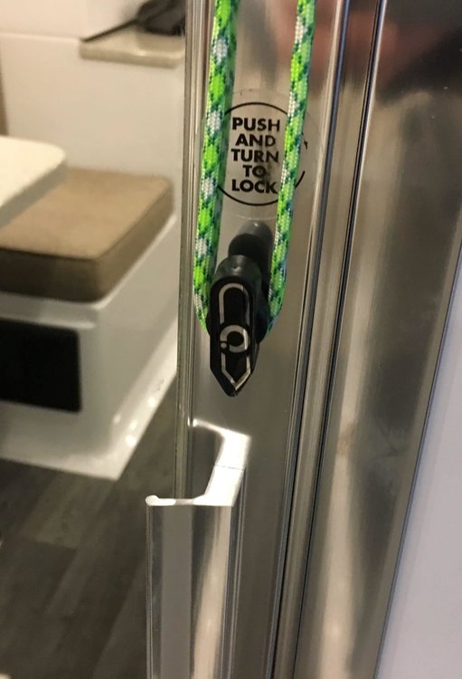

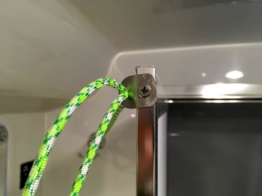

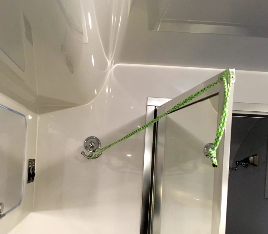

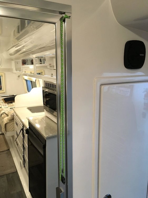

John E Davies Posted August 26, 2017 Posted August 26, 2017 You know how it is when you are parked just slightly off level toward the street - the door will not stay open, no way, no how.... The eyelet is a thin piece of stainless steel, with a hole in it just large enough to allow two sections of standard nylon paracord to slide through it with a good amount of drag. When installing onto the door, be sure to support the bottom of the door or it might come apart, since that screw holds the frame together at the upper corner. The cord is adjustable for length just by sliding it, and you can remove it entirely by pulling through the eyelet since there is no knot in the left side of it. Set the length so that it will just slip under the knob at the bottom for travel. Works good, if you slip the end under just the outer arm of the coat hook, you can still hang stuff like hats from it. Be sure to sear the cut ends or they will look nasty. And you don't have to use bright green ;) John Davies Spokane WA 2 SOLD 07/23 "Mouse": 2017 Legacy Elite II Two Beds, Hull Number 218, See my HOW TO threads: Tow Vehicle: 2013 Land Cruiser 200, 32” LT tires, airbags, Safari snorkel, Maggiolina Grand Tour 360 Carbon RTT.

John E Davies Posted August 26, 2017 Author Posted August 26, 2017 Could you slice one side of a swim noodle & cut it to fit the width of the door jam, then shove the noodle over the edge of the jam to keep the door open? Sure, a noodle or a piece of slit water pipe insulation would work for off season ventilation, but that will only hold it art way.... This is intended for when you are occupying the trailer for a short time, for example a Rest Stop, and want to keep the door fully open. Sometimes we don't disconnect and/or run down the jacks down for overnight, if I can get the trailer close to level by maneuvering. If the trailer has a slight right cant, the door won't stay open without this string, or the magnets mentioned above, which I was too dim to think of. We keep the dog water bowl in the bathroom, so the door needs to be open most of the time. You can always prop it open with a shoe or some other object, but that doesn't work very well. John Davies Spokane WA 1 SOLD 07/23 "Mouse": 2017 Legacy Elite II Two Beds, Hull Number 218, See my HOW TO threads: Tow Vehicle: 2013 Land Cruiser 200, 32” LT tires, airbags, Safari snorkel, Maggiolina Grand Tour 360 Carbon RTT.
