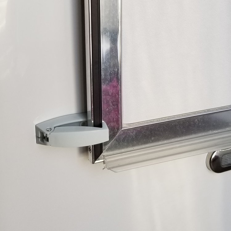

Bathroom door hack using a Camco basement door catch attached with a Command strip.

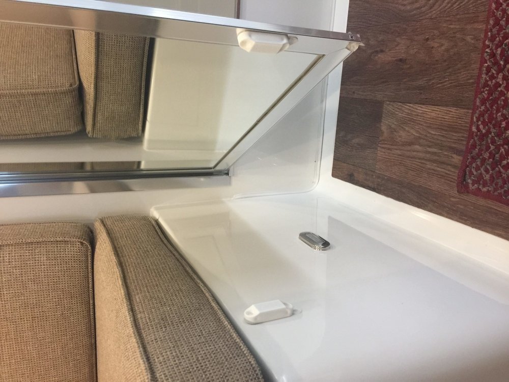

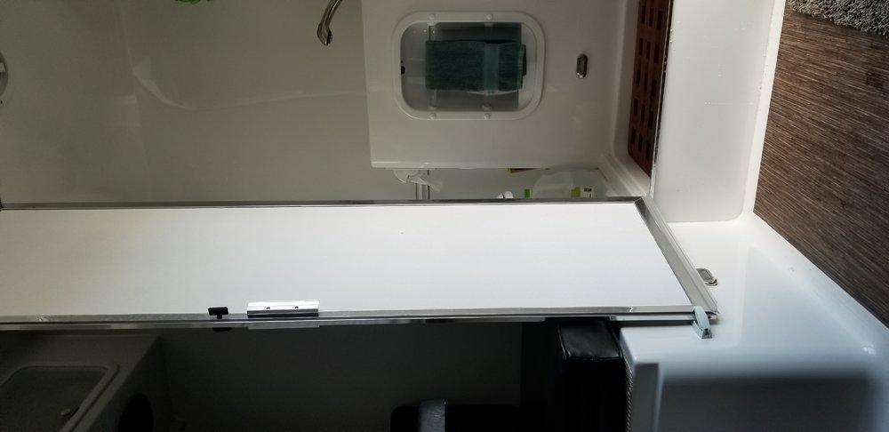

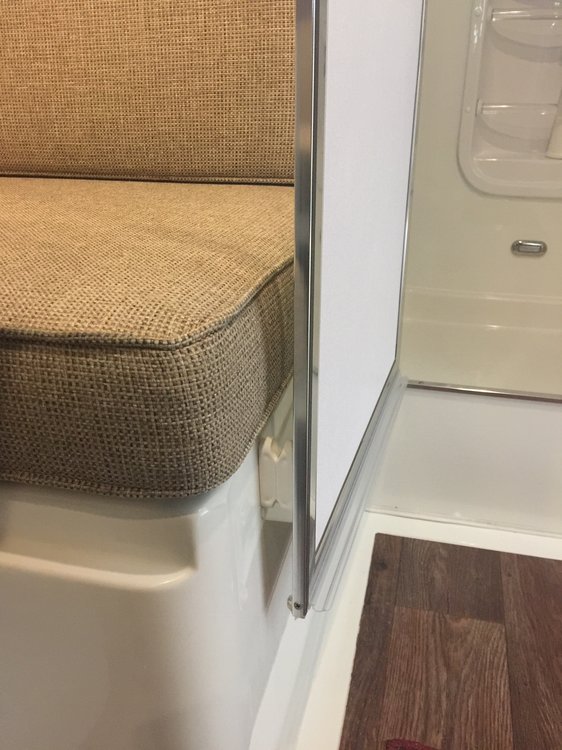

I did the magnet hack first thing - works very well.
Mike:
I purchased the same SUPER magnet catches.  I am amazed at the holding power and thought they would warp the door frame.
Can you expand on the "Stick On Bumper's" you used?
Thanks!
I purchased the same SUPER magnet catches.  I am amazed at the holding power and thought they would warp the door frame. Can you expand on the “Stick On Bumper’s” you used?
I avoided the problem of the magnets being too powerful: I put one magnet inside the storage area under the dinette seat. You can read more on the link that Mike lists above for other ideas about keeping the door open.
Onward through the Fog!
EarthPicks of Cochise County
Mike:
Thanks!
I used the little stick on bumpers (either rubber or felt) that are used to sometimes cushion cabinet doors and drawers. I got them at Home Depot or Walmart. Should be easy to find.
Before we left on this current trip I did Spike’s solution and removed the one on the side of the dinette and moved it inside. Still enough magnetic power but the door doesn’t warp when you disconnect, plus it looks better.

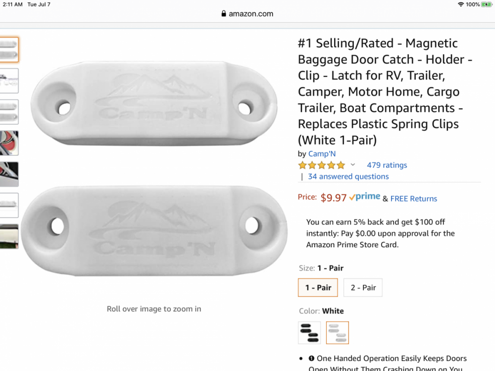

Could someone who installed the magnets - one on the door and one on the inside of the dinette seat post a link for the magnets used?  Thanks
Ray and Susan Huff
1UP-USA Heavy-duty bike rack
Here you go -install with 3m double sided tape.
How did you attach?
Ray and Susan Huff
How did you attach?
Please read/look at the post above by Mike and Carol above....Jan 19. I installed one magnet under the inside dining table wall so it is not visible vs the outside wall. Then just installed the other on the shower door as Mike’s photo shows. 5 min install. The magnets are very strong.
