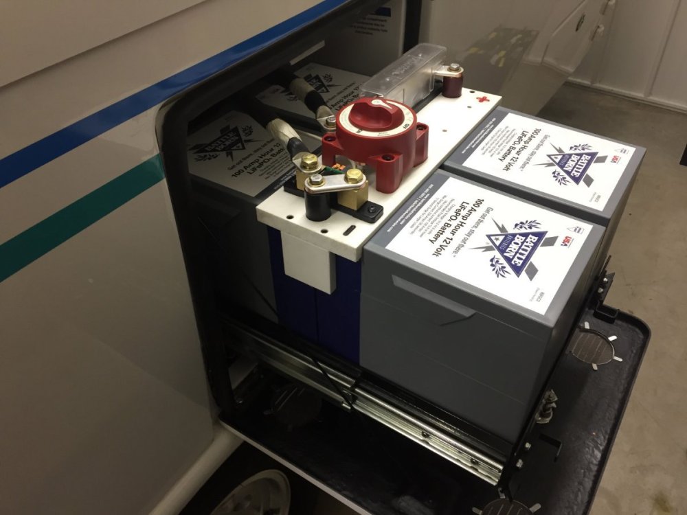

We have a Legacy Elite II (2020). Has anyone tried to install 4 Battle Born lithium 100 Ah 12 Volt GC2 upright batteries into what was the stock, 4 lead acid batteries tray? Will 4 of the lithium upright GC2 batteries fit in the existing tray? Thanks much!!
Wow, very nice. I was afraid they would be too wide. What device have you used in the center to connect them?
Also, did you use a BMS installed inside or the blue tooth monitor?
Thank you!
It looks like a terrific solution. You do great work. I will definitely take a closer look. Thanks, I am grateful for you sharing the design and information.
In an RV, solid copper bus bars between the battery terminals are great IF you can ensure there is no motion whatsoever. If the batteries can shift even a small amount, there can be extensive damage. I doubt that BB would warrant them in that case. If you hit a deep pothole at highway speeds and they shift, uh oh.... I installed two regular sized ones, with room for a third. All batteries have two Mil-Spec (zero stretch) straps crossing them, for redundancy, plus tight fitting spacers at the bottom. Remove two nuts at the wall posts, pop off the cables, slide out the tray. Easy

On 5/30/2019 at 7:03 AM, donthompson said:
I haven't tried to figure out whether I can fit 4 in my battery compartment, but I'm thinking of starting with 2 and upgrading if I need more amp hours.
There are at least 22.5 opinions about how many BB's to pack into an OEII, and how to hook them up.
One nice, but expensive and time consuming to do idea floated and done by several owners is to clean out as much as possible wiring from the battery compartment.  I figured that since LifePO4 batteries are pretty much maintenance free, I would not go that route.
 My DYI install considerations were:
Ease of installation and inspection.
  • Leave space for a master cut off switch
  • Minimize changes to existing wiring
  • Use as much existing wiring as possible.
  • In the battery box, install three Battleborns, the Smart Shunt and a Master Cutoff Switch (350 Amp BlueSeas)
To do this I also used two terminal blocks (Red and Black) and some poly cutting board.
When all said and done, the master cut off switch had about 1/4" clearance.  Here is a picture. it shows two heavy duty straps.  'll be adding a third this summer.  As you can see, there is no room for a 4th battery.
One important consideration of any layout is keeping all the connections easily visible for both mechanical and thermal check-up every once in a blue moon.  For the thermal check, I use the John Davies recommended IR detector that works well with wheel bearing and brake checks at road stops.
GJ

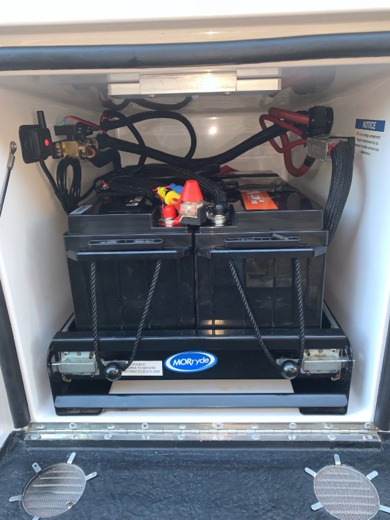

 Very impressive setup, I like your install criteria!  I recently upgraded from four 6V Trojans to two LFPs and a Smart Shunt, but really like the cutoff switch you installed. Yet another project on the horizon!

On 10/15/2021 at 12:27 PM, Minnesota Oli said:
Thanks.
Creative using the existing rope handles for tiedowns.  I think that that may be an ORIGINAL idea as I have not seen it done before.  They also give two horizontal and vertical battery stability support to holding the batteries in place.
GJ
I must say the length of the rope handles was just right to be able to utilize them in this manner. I initially did so to keep the newly installed LFPs from shifting fore and aft while taking time to refurbish the original Oliver straps. Seems the former ‘wet’ Trojans deteriorated the plastic strap clips, as well as the thread stitching. The new clips and improved stitching should last much longer with this setup. That said, the batteries are now properly secured and the rope handles still being put to good use helping to keep tension on the slide knobs to hopefully prevent inadvertent movement.
2020 OLEll, Twin, 579:
