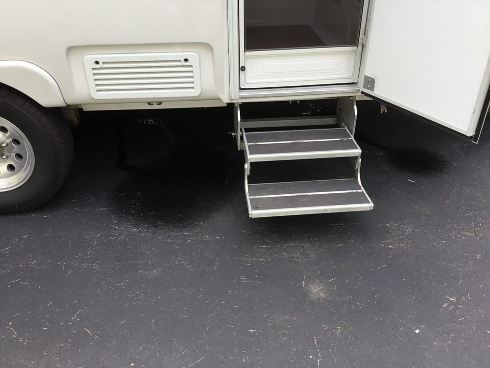

Muppy Posted September 1, 2019 Share Posted September 1, 2019 Hey friends. First time hooking up water. So of course, I forgot to open the drain in the shower floor. So I am wondering if what I am about to write could have something to do with the water from the sink not being able to go down the drain. I am praying it is. It is city water, have a 40-50 psi regulator at house outdoor faucet. I have water drip drainage at all drains on the door side of the Oliver. The metal weep hole drains as well as the white drainage tube under the refrigerator. What the heck. I just picked this up last Sunday. First setting up this weekend, because on top of this we have just accepted a offer on our home last Saturday. I am not feeling all warm and fuzzy right now and a little discouraged. What ...probably a leak? What do you think. Muppy ( John & Cheryl) New Hampshire residents. 2016 Chevy Silverado 1500, Crew Cab, LTZ/short box, 5.3L Ecotec3 V8 w/ tow/haul mode /20 inch wheels Retirement ( 12-31-2017) 8/25/2019, we purchased the previously owned “2017 Oliver Elite ll Hull #170, Standard King Bed, Solar package, Nature’s Head Composting Toilet and all the extras”! Link to comment Share on other sites More sharing options...

Muppy Posted September 1, 2019 Author Share Posted September 1, 2019 Hi Overland, yes, the hose is hooked up to the right sided inlet marked city . what happened was, I opened all of the faucets, then went and turned the water on at the house on slowly ,not fast, but not at a snails pace either. I then walked to the Oliver to go in and watch for all of the air to get out of the lines, while husband watched the water connection on the Oliver. When I went to the bathroom, I saw some water going into the shower pan...so I quickly opened the shut off at the shower pan and the water went down. At no time did it overflow. When all of the air went out of the lines, I shut the faucets off,kitchen and bath ( we have a compost toilet),went outside to start the water heater and noticed the water dripping out of the 3 places in the pictures above. Yes there is water coming out of the white tube under the refrigerator, not just the metal weep holes( front and back) on the door side. None on the dinette side is leaking. I went ahead and did my cleaning inside...nothing gets cleaner than a mad woman cleaning!!! In the meantime it was still, drip,drip,drip, from all locations mentioned. Water heater worked fine....that is a good thing or I would have lost it entirely! we looked under the dinette...no leaks. We looked under the seat on drivers side REAR at the U TABLE...no leaks. Any suggestions? thank you, Muppy (Cheryl) New Hampshire residents. 2016 Chevy Silverado 1500, Crew Cab, LTZ/short box, 5.3L Ecotec3 V8 w/ tow/haul mode /20 inch wheels Retirement ( 12-31-2017) 8/25/2019, we purchased the previously owned “2017 Oliver Elite ll Hull #170, Standard King Bed, Solar package, Nature’s Head Composting Toilet and all the extras”! Link to comment Share on other sites More sharing options...

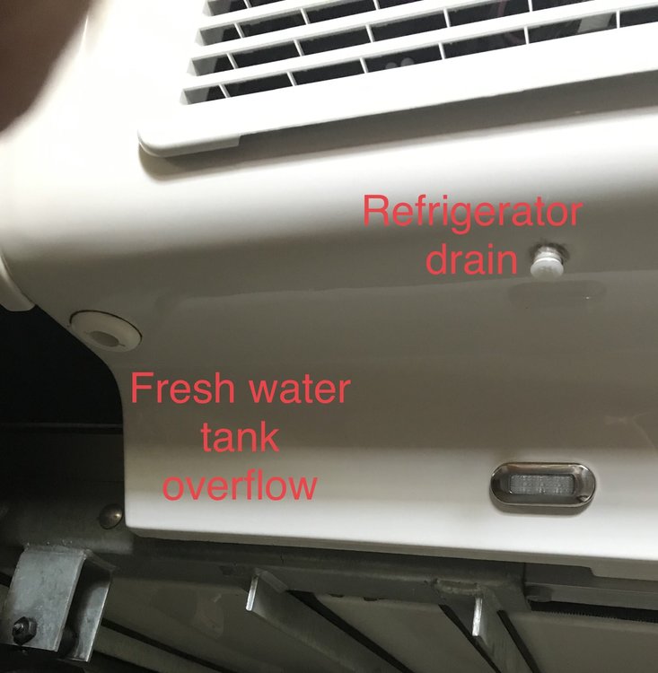

Townesw Posted September 2, 2019 Share Posted September 2, 2019 Was the water under your refrigerator area coming from the fresh water tank overflow or from the refrigerator drain? If coming from the refrigerator drain, was it coming out of the tube or from a gap between the tube and the hull? 1 Bill and Martha 2018 LEII Hull 313 2019 Chevrolet 2500HD Duramax Link to comment Share on other sites More sharing options...

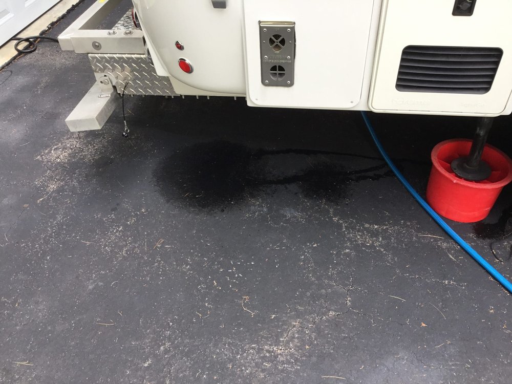

Muppy Posted September 3, 2019 Author Share Posted September 3, 2019 Hey All, I just read all of your responses. We lifted the front of the trailer. We just ran the water pump. No water on-connected to the Oliver. Some water came out, not a lot into the sinks. We have the grey tank open and the hose connected to drain in the driveway, grey tank is empty. The drain holes were pouring water!! When we picked up the Oliver, the fresh water tank gauge was not working. We are thinking the previous owner overfilled the fresh water tank, possibly multiple times, and the bowels are full of water? We will do all of the suggestions, and get back to you on wed. On here. Unfortunately, appts are awaiting. Many thanks for your time friends. Chat very soon....I want to camp a couple of days at least before winterizing. And campgrounds close Oct 1st at many North East Campgrounds. Or at least the latest,Columbus Day. Dang it. Muppy (Cheryl And John) New Hampshire residents. 2016 Chevy Silverado 1500, Crew Cab, LTZ/short box, 5.3L Ecotec3 V8 w/ tow/haul mode /20 inch wheels Retirement ( 12-31-2017) 8/25/2019, we purchased the previously owned “2017 Oliver Elite ll Hull #170, Standard King Bed, Solar package, Nature’s Head Composting Toilet and all the extras”! Link to comment Share on other sites More sharing options...

Muppy Posted September 5, 2019 Author Share Posted September 5, 2019 Townes, yes, the water was dripping from the refrigerator drain, as well as all weep holes curb side during city inlet hookup. not...the round fresh tank overflow to the left. We tipped the front of the Oliver up and water poured out of all holes(not the fresh water tank overflow though). I think the bowels of the Oliver were full of water. At this point the whole thing is a mystery. Please read my last post to Jason on here. thanks, Muppy (John And Cheryl) New Hampshire residents. 2016 Chevy Silverado 1500, Crew Cab, LTZ/short box, 5.3L Ecotec3 V8 w/ tow/haul mode /20 inch wheels Retirement ( 12-31-2017) 8/25/2019, we purchased the previously owned “2017 Oliver Elite ll Hull #170, Standard King Bed, Solar package, Nature’s Head Composting Toilet and all the extras”! Link to comment Share on other sites More sharing options...
Muppy Posted September 5, 2019 Author Share Posted September 5, 2019 Jason, after the fiasco with the city water inlet leakage. we ran a test today. We Hooked up the hose with the 40-50psi regulator to the fresh water inlet on the left. Turned on the water, fresh water tank filled fine, no leakage until it came out of the round overfill to the left of the fridge curb side. The fresh water tank gauge does not work . We shut the hose off immediately when water came out of the overflow of the fresh tank. Turned on the water pump. Opened the kitchen and bathroom faucets.....*** WATER STARTED POURING OUT OF ALL OF THE DRIP HOLES AND DRAINS ON THE CURB SIDE. (NOT THE FRESH TANK OVERFLOW.). Shut off the water pump and closed faucets....***THE DRIPPING SLOWED AND STOPPED. We retilted the Oliver front up and water drained from all openings. UGH! So we can use no water without it pouring out. Thanks, Muppy New Hampshire residents. 2016 Chevy Silverado 1500, Crew Cab, LTZ/short box, 5.3L Ecotec3 V8 w/ tow/haul mode /20 inch wheels Retirement ( 12-31-2017) 8/25/2019, we purchased the previously owned “2017 Oliver Elite ll Hull #170, Standard King Bed, Solar package, Nature’s Head Composting Toilet and all the extras”! Link to comment Share on other sites More sharing options...
