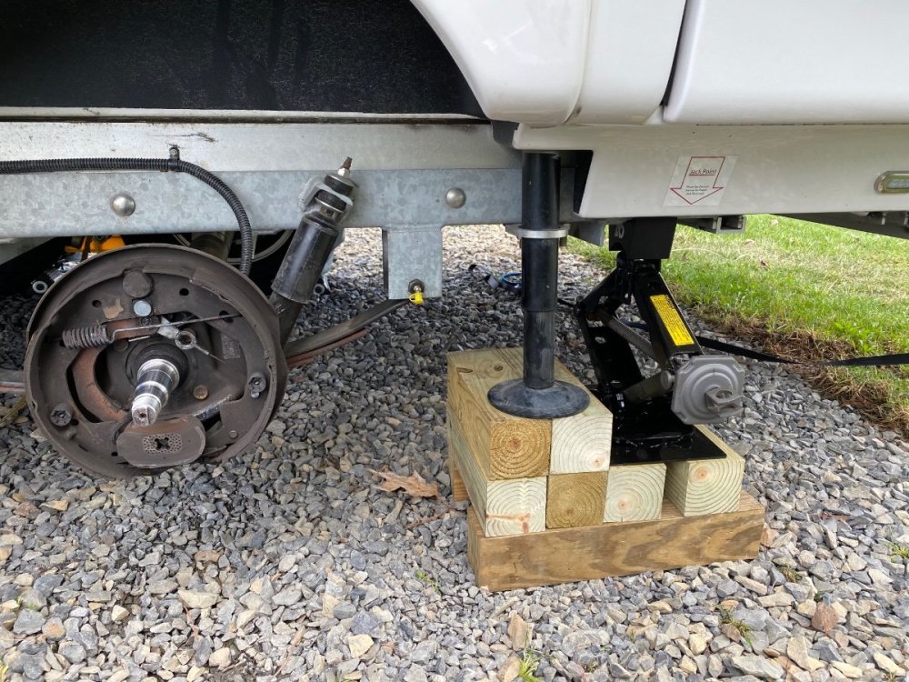

I just use a good heavy duty scissor jack on some 4”x4” cribbing to lift the trailer (but mine does have the marked jack points on the steel subframe) and then after raising the trailer I put the stabilizer down just as a backup.  Chocks under the tires on the opposite side of course.  Doing my wheel bearing re-packing now.
Frank:
I like your approach of having two safety supports at the tire change side.
In addition, I only jack up my OE2 ATTACHED to my truck.  Parking brake set of course.  So, should something upset the apple cart, I'll have three safety points.  Nothing like having a  6,000 pound truck as an anchor.  🙂
GJ

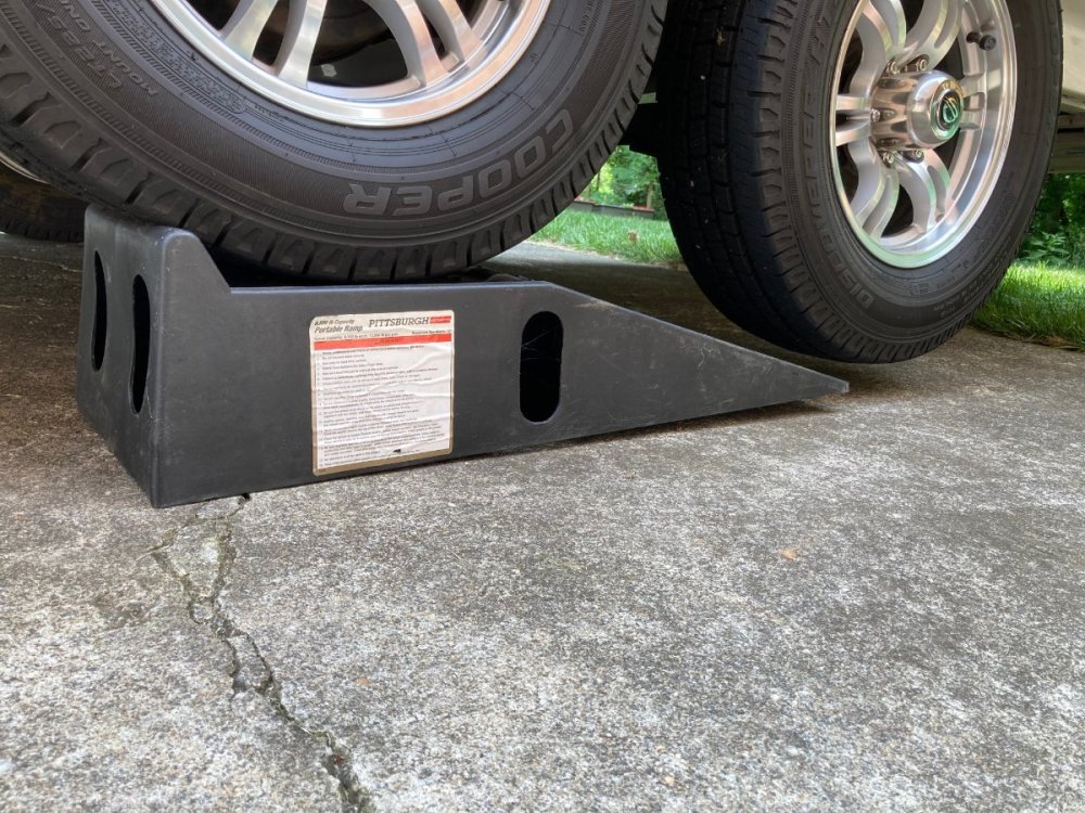

2021 LE 2 ....tried using one of my 6.5" high Harbor Freight ramps. It will indeed lift either tire off the ground. Similar to using a leveler...it's as easy as it looks.
I did a quick test with my 2021 LE2, but just used stuff I had with me while camping this past week.   I used a Beech Lane leveler, 2 rubber jack pads, and a few 6x6 wood blocks.   The total height off the ground was 6.5”.   The rear wheel lifted free, very easy to do.   If I wanted to remove the wheel, I would have lowered the rear stabilizer for additional safety.   I did this test in a slightly sloped gravel parking lot, my objective being to simulate a roadside tire change.  I assume the EZ Jack will work just fine, and will be more elegant and safer than my makeshift arrangement.   I also think it’s much safer than a bottle or scissor Jack on the frame.
“Ramble” - 2021 Legacy Elite II #797;  2020 Ford F-250.   Former owner of 2019 Oliver Legacy Elite  #431.

I think the results will vary with the EZ Flex as we DID in fact try it with the Rapid Jack which is 7" tall on an asphalt driveway and it did NOT lift the other tire off the ground at all.  Just saying.
