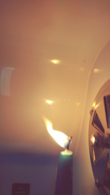

We have found, by adding the vent high in the bathroom wall, that we were able to relieve a lot of the negative pressure in the bathroom. It works extremely well when the bathroom door is closed. This allows the air to return to the return vent easier.  By adjusting the heat vent under the bed to about half closed, the kitchen one about the same and the bath vent full open we got the best results. We also found by straightening out the duct in the basement, from the heater, we eliminated some of the air restrictions and turbulence. The air seems to flow better. As the heat loss from the duct seems to be what keeps the tank space warmer as well as the return vent air we didn't want to insulate. What might help a lot is to close off those hull drain holes, which I am sure allows a lot of cold air intrusions and heat loss. As for the closet? I have noticed how 'cool' it gets, but can't find a reason to waste heat on that static space. Cloths and towels can be taken out a few minutes before?20200304_134414_Film4.thumb.jpg.64e21de589e657dcea2975f0afb1792c.jpg

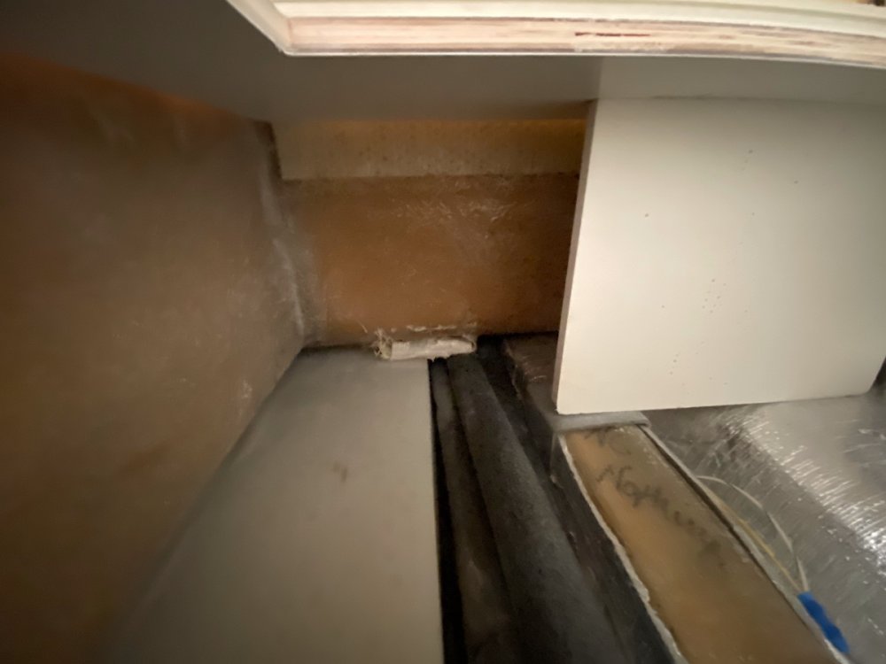

Found this earlier thread, with lots of great discussion. Why the heck can’t I remember these threads? Getting old.....
https://olivertraveltrailers.com/forums/topic/2698-acheat-system-contamination-and-replacing-flex-heating-ducts/
From that thread, this pic is just what I was looking for:
Note the small white pex water line on top of the fresh tank, indicating this is the latest configuration with the fresh water pickup drawing water through suction instead of through that pesky bottom port the earlier (pre-Hull Number 300 ish?) models have.

Oliver has been known to cut a hole and install a deck plate when repair access for the fresh tank overflow is required. There is a lot of dead space under the cabinets that's ripe for cleaver picking. Just be mindful of the access panel heights so they don't interfere with the draw bottoms.
I just noticed this, the duct in that pic has been stepped on and squashed, I wonder how often that happens. I hope the technician trimmed off that section. I also sure hope that upward loop at top right isn’t in the final installation.

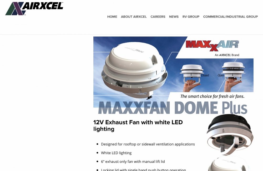

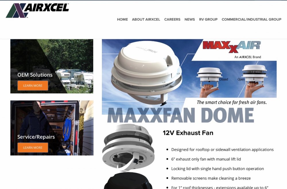

Not the same, but I heard Oliver is installing a different bathroom roof vent in the 2021 model.  Maxxfan, but don't know the model.  No matter which model, it should be bigger than the previous little round fan, so that's good.

It was a one off. Hole saw from Harbor Freight. And some vent covers. About a half hour job.

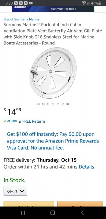

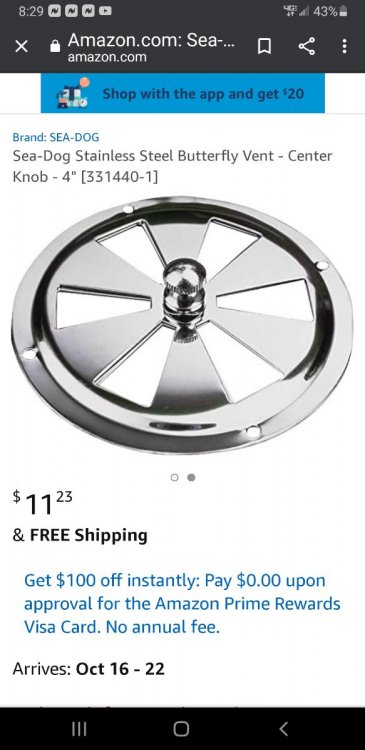

Mainiac, is this the vent cover you used? X2
Or, the second one?
I’ll bet you a cup of coffee that it will be either of these MaxxFan models if in fact your information is correct.
Or, the second one?
It was the first one. Think it was around $7, but I might have paid shipping. Really thought the second one had a better mechanical advantage, but the 'frugal' me didn't want to spend the extra on an unknown application. As it turns out the first one is great. Was going to use a static vent on the inside, but the holes didn't line up. The static vent would work fine, as I find I never need to close. The vent also works well when using the bathroom exhaust vent and the window is closed.
