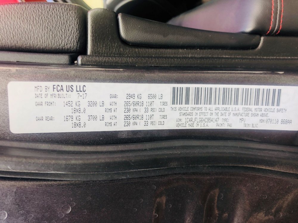

Skipster Posted September 13, 2020 Share Posted September 13, 2020 need help. trying to figure payload weights and related. this is my doorjam info. we have a jeep grand cherokee with a class iv tow package and a tow rating of 6200lbs. I skip and cyd nielsen hull #822 Elite tow vehicle 2017 jeep trailhawk v6 Link to comment Share on other sites More sharing options...

Moderators topgun2 Posted September 13, 2020 Moderators Share Posted September 13, 2020 (edited) 2017 Jeep Grand Cherokee Sport utility vehicle Description Towing capacity: 3,500 to 7,200 lbs Payload: 1,396 to 1,955 lbs MPG: Up to 19 city / 26 highway Warranty: 3 yr/36,000 mi basic, 5 yr/100,000 mi powertrain Curb weight: 4,545 to 5,104 lbs Horsepower: 240 to 475 hp To get more specific about the payload your Jeep, you are going to have to be a bit more specific. I assumed that yours is a 2017 and assumed that it has the 6 cylinder engine because that is the towing capacity noted by Good Sam's 2020 towing guide for a Grand Cherokee with the 3.6L V-6 engine for both 2WD and 4WD versions. Any options - OEM or otherwise? Also see - https://www.autoblog.com/buy/2017-Jeep-Grand+Cherokee-Limited__4dr_4x4/specs/ Edited September 13, 2020 by topgun2 2023 Ford F150 Lariat 3.5EB FX4 Max Towing, Max Payload, 2016 Oliver Elite II - Hull #117 "Twist" Near Asheville, NC Link to comment Share on other sites More sharing options...
John E Davies Posted September 13, 2020 Share Posted September 13, 2020 (edited) For purchasing a brand new vehicle off the lot, for sure you have to study stickers and then plan for future permanent weight additions. I am not sure why this is so hard for folks who already own a vehicle...... just take your SUV or pickup to a truck scale and weigh it with full gas and a driver, look at the GVWR number (Gross Vehicle Weight Rating), and the difference is what is left is for passengers and payload. This accounts for any aftermarket parts you added like bigger tires or a roof rack, or that heavy bag of tools that you always carry with you. Most of the “stuff” you carry weighs much more than you think it does..... if you guess at the weight most likely you will be guessing low. It would be fairly uncommon for somebody in an SUV to exceed an individual axle weight rating unless he carried bricks. In pickups, overloading the back happens ALL the time. John Davies Spokane WA Edited September 13, 2020 by John E Davies SOLD 07/23 "Mouse": 2017 Legacy Elite II Two Beds, Hull Number 218, See my HOW TO threads: Tow Vehicle: 2013 Land Cruiser 200, 32” LT tires, airbags, Safari snorkel, Maggiolina Grand Tour 360 Carbon RTT. Link to comment Share on other sites More sharing options...
bhncb Posted September 13, 2020 Share Posted September 13, 2020 2 hours ago, Skipster said: need help. trying to figure payload weights and related. Practically, payload is Gross Vehicle Weight Rating minus Curb Weight. Technically, it is whatever the Tire and Loading placard on the driver's door jamb says after: The combined weight of occupants and cargo should never exceed In your case, the 2017 Jeep Trailhawk CW is published as 4869. Based on the 6500 GVWR, max payload should be 1631 minus the weight of factory optional equipment like the rock rails and engine block heater. Don't try to resolve the difference between this calculation and the figure on the placard because the placard calculation was determined by the legal department, based on the original equipment tires, and has little engineering basis. Generally, using the placard number is advisable. I'll spare the subjective on capability but what "related" capacity information are you looking for? 1 Link to comment Share on other sites More sharing options...

Moderators SeaDawg Posted September 14, 2020 Moderators Share Posted September 14, 2020 So, assuming this is the Grand Cherokee Trailhawk? Your Elite should look great paired with this 4 x 4. The tow package was standard, right? I believe we had one or two others towing Elites with the Grand Cherokee. With a gvwr on the Elite of 5000 pounds, you'll likely be happy, and well within your tow capacity. I'd encourage you to limit the amount of "stuff" you carry the first trip, just til you get used to it. What else have you towed with the Trailhawk? That's the Grand Cherokee version my daughter really loved when she was looking last year, but it was out of her budget range. Sherry 1 2008 Ram 1500 4 × 4 2008 Oliver Elite, Hull #12 Florida and Western North Carolina, or wherever the truck goes.... 400 watts solar. DC compressor fridge. No inverter. 2 x 105 ah agm batteries . Life is good. Link to comment Share on other sites More sharing options...
