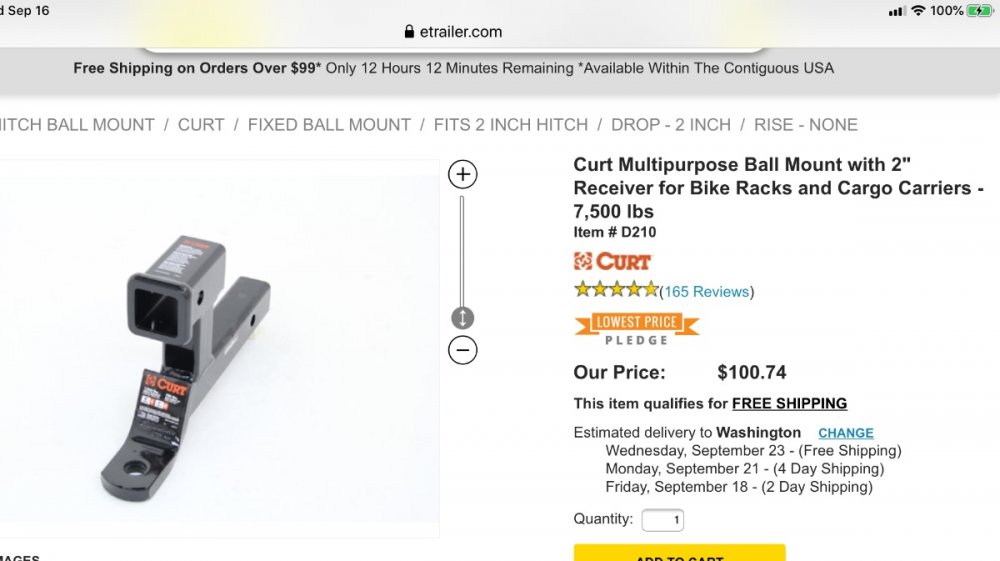

Usually this is true, but there are a few other products that might work for Susan, like this Curt ball mount, with 7500/ 750 pound limits.
https://www.etrailer.com/p-D210.html
If the Ollie’s tongue is kept light (no cargo tray!) it should work. Unfortunately, finding a unit like that with the correct drop for a Super Duty will be problematic, it is most likely that that one is the wrong height.

8 hours ago, bhncb said:
These receiver adapters/extenders limit the hitch capacity to 3500# so using one with 7000# GTW is out of the question.
Are you sure?  I'd better look into that.  Thanks
Etrailer information on the Ball mount with 2" receiver says wt limit of 7500#  Am I reading that wrong?  Maybe there's something I don't understand.
Tongue weight limit is 750#.  Oliver = 490#  Bikes/rack = 120# total 610#
Bike rack and two bikes weigh 120#
https://www.etrailer.com/s.aspx?qry=dual+receiver+hitch+adapter&furl=-vw-1-pg-Trailer_Hitch_Ball_Mount
Yes, my husband thinks the drop won't work.  Oliver has told me a 2 1/2" drop will work with our pickup, but I find that puzzling.  More to investigate, for sure.  Taking our bikes along is becoming a pain in the neck!  Might just have to throw them in the back of the pickup 😬
It is easy to check, have you measured your receiver height with the truck loaded for travel (with a simulated cargo plus tongue weight)? I used a 2.5” drop ball mount on my 2006 Ram 3500. It worked perfectly. I used an extended shank (extra long threads) ball with hard Grade 8 washers to fine tune the coupler height. If I remember correctly, I only needed to add a couple under the ball flange to level the trailer perfectly. But that truck had oversized 33” tires, all trucks are different, so you need to measure. Go to the landscape supply place and bring back a couple of yards of dry bark or something, so you can measure with the truck squatting a little.
