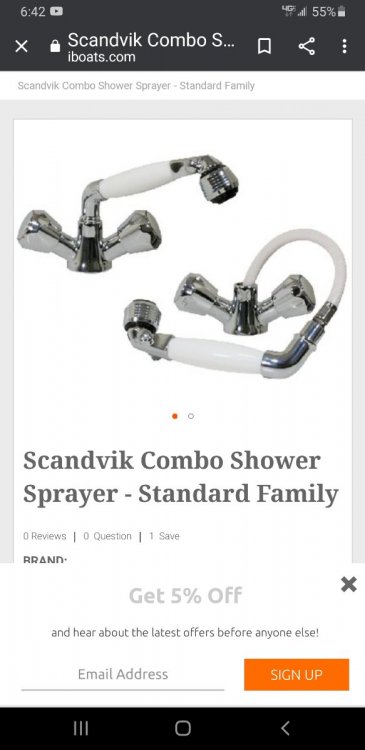

In our older trailers, the shower and faucet were one unit. Scandvik marine hardware.
You lift the faucet out of the sink, and put it up on a hook. No diverter necessary.  Pretty common in boats, especially older ones like ours .
This will obviously work. But, you lose that precious bit of counterspace to the right of the faucet .
I do like the idea of the access panel. Now wondering if I  could modify the abs insert on ours. Probably not. It's not that strong. Not like your hatch.
I do agree, high Sierra is highly rated.

The scandvik isn't a "looker," either.  But it works well.
Except for the little knobs for controls, imo. They're difficult to operate with soapy hands.
That’s the one that came on our Oliver.  My only complaint is the caps broke off the control knobs, otherwise it does the job.
This what came on our trailer as well.  Works fine, can toggle on/off at the shower head.  Mike
