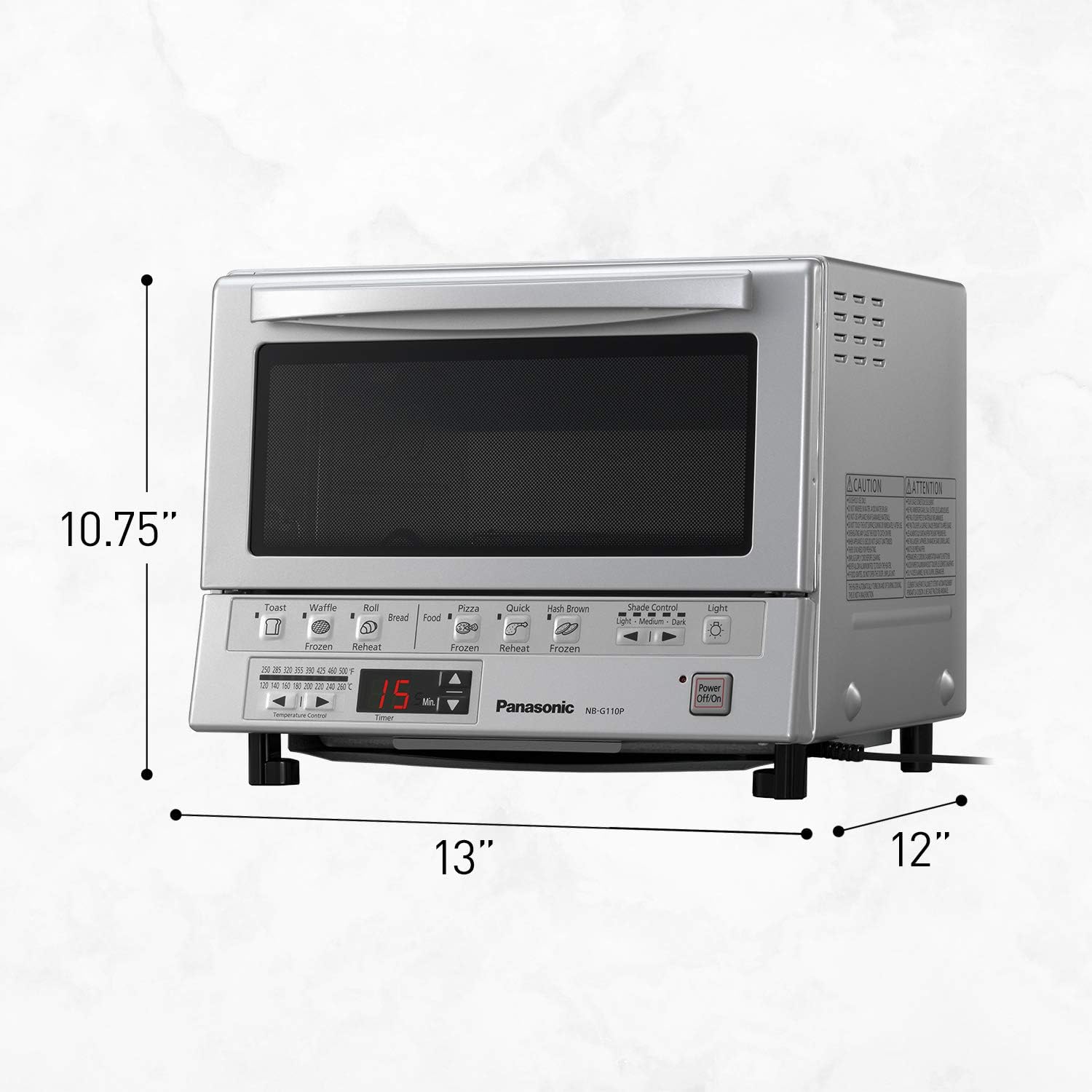

Jairon Posted January 31, 2021 Posted January 31, 2021 3 hours ago, Overland said: The Breville Mini is the only one I know of that will fit. I believe this one will fit as well (Panasonic FlashXpress): https://smile.amazon.com/Panasonic-NB-G110P-FlashXpress-Infrared-Removable/dp/B008C9UFDI/ref=sr_1_3?crid=2CIG994XT7R3 I misplaced my storage box estimate though so I can't confirm. 1 2019 Toyota Land Cruiser 2021 Oliver Elite II, Hull #748
Overland Posted January 31, 2021 Posted January 31, 2021 That would be nice if it fits - good to have options. Plus it comes in white.
Jairon Posted January 31, 2021 Posted January 31, 2021 2 minutes ago, Overland said: That would be nice if it fits - good to have options. Plus it comes in white. If anyone that opted for the storage box has the exact measurements, here are the Panasonic dimensions: 1 2019 Toyota Land Cruiser 2021 Oliver Elite II, Hull #748
tallmandan Posted February 3, 2021 Author Posted February 3, 2021 Thanks everyone for your responses. We tried our slightly older but awesome panasonic 1750 watt toaster oven and it worked on battery without overload on the 2000 watt inverter but definitely drew considerable batt power. As for my batts not ever reaching full, turns out the norcold refrigerator was not completed off. Hoping that was the reason but had to take it to the RV storage lot (HOA regs 😑) so I haven't been able to check again. 2020 Elite II #627, 2026 Toyota Tundra Platinum Hybrid, Colorado
