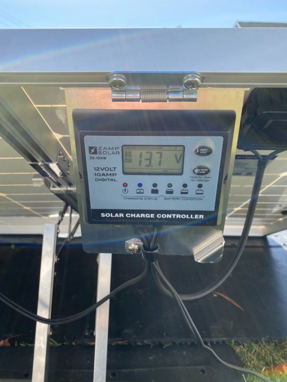

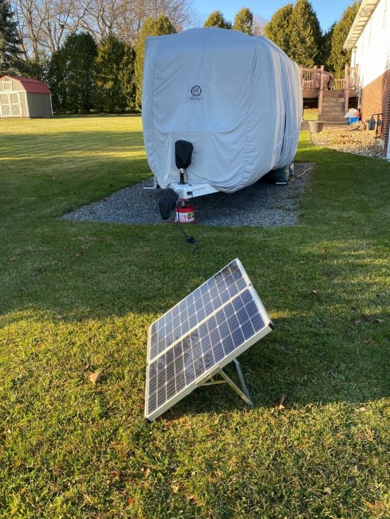

It can be used but you have to make sure the panel has a charge controller. Here’s what the setup looks like.  As John said, it’s not the optimal setup but it works and it was a heck of a lot cheaper.  About $1,000 for the panel with controller plus the 7 pin adapter I had to wire up.  Plus as portable panels improve I can upgrade easily.   As far as the distance issue it’s not much different than the tow vehicle alternator to trailer distance, and my batteries fully charge just fine from both my tow vehicle when driving and when using the solar panel at Harvest Host stops.   As John described, wire gauge vs current capacity is heavily dependent on wire length, whether the wire is in open air or buried in a bundle, continuous or intermittent current, ambient temperature, etc.  Chart below.  My panel is only 140 watts so call it 12 amps max. (And I rarely see above 10 amps).  John is correct though that for a very high wattage panel like the Oliver factory setup, larger gauge and shorter wiring is required.

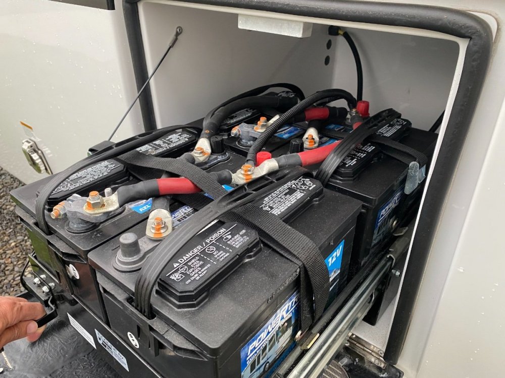

They are PowerTron brand which is a Trojan sub-brand.   The four 12v wet cell setup was an Oliver option when we bought our 2019 Elite II.   Not sure about the amp-hour rating.  Part number is PowerTron D24DC-140.  But I can’t find the specs online.  Looks like this model might have been discontinued.  The four 12 volt parallel arrangement has worked really well for battery life when boondocking at overnight Harvest Host stops.  We don’t have the inverter or factory solar.   Just running the DC accessories (fans, lights, water pump) when boondocking so the battery running time has been great.

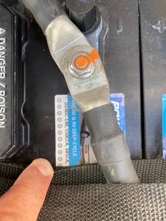

That sounds like a nice battery package and I guess the label indicates that they are 140 amp-hour rated, giving you 280 usable amp-hours.  Excellent battery choice!
Updated:  yes, mossemi is correct that it’s usable 280 amp-hour (if they are 140 amp-hour batteries) by sticking to the 50% discharge limit.
