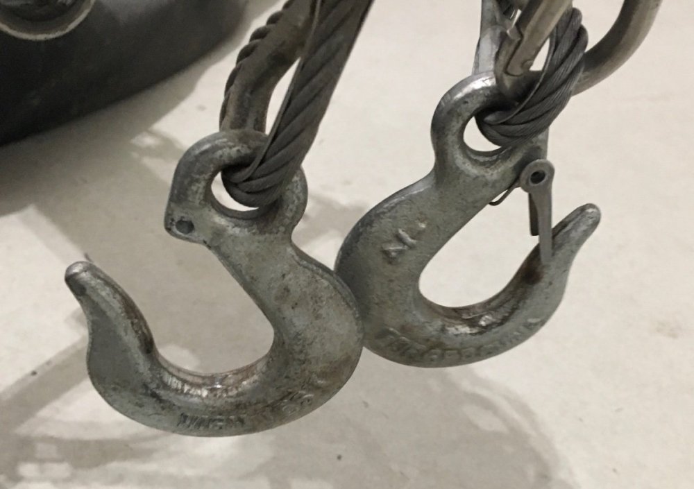

John E Davies Posted September 24, 2021 Share Posted September 24, 2021 One of the retaining ears broke on my curly cables, I ordered a new set from Amazon; Jason in Service told me he could not supply me an OEM type, since they no longer install them. He did say that he personally prefers the cables….😀 These are the correct rating and general dimensions, but the hook opening is slightly smaller. They are a little fussy to get clipped into the two holes, on my LC200 hitch, which is perfect IMHO. The old ones had larger hooks, and the one with the busted retainer could fall off. These might not work at all on your TV. Tie Down Engineering 36” safety cables I am keeping the one serviceable old cable as an emergency spare. Normally I like chains, but on my Ollie I prefer the cables, they stay neatly up and out of the way above the Stone Stomper fabric . Chains would dangle down and interfere more. John Davies Spokane WA 1 2 SOLD 07/23 "Mouse": 2017 Legacy Elite II Two Beds, Hull Number 218, See my HOW TO threads: Tow Vehicle: 2013 Land Cruiser 200, 32” LT tires, airbags, Safari snorkel, Maggiolina Grand Tour 360 Carbon RTT. Link to comment Share on other sites More sharing options...

Geronimo John Posted September 25, 2021 Share Posted September 25, 2021 On 9/24/2021 at 2:58 AM, topgun2 said: On all of the RV's I owned prior to getting my Ollie, I had chains. Hopefully I never have to go back to the "chain side". The cables are up and out of the way both while parked (unhitched) and while underway. They are cleaner too. What's not to like? Bill I find the cables a PITA to attach to my F-150 due to their tension and interference with the Anderson system. Frankly, I would swap the OEM Ollie curly cables for some DOT rated yellow chains in a flash. However the PITA they are, is not yet very high on the improvements list. But, before changing hooks, I would fix the latch hook. It's a lot less expensive. 3 TV: 2019 F-150 SuperCrew Lariat, 3.5L EcoBoost, Max Tow, FX-4, Rear Locker OLLIE: 2018 OE2 Hull 342, Twin Bed. OLLIE DIY’s: Timken Bearings, BB LiFePO4's, Victron 712 Smart, 350 Amp Master Switch, Houghton 3400, Victron Orion DC - DC, 3000-Watt Renogy Inverter, P.D. 60-amp Converter, Frig Dual Exhaust Fans, Kitchen Drawer Straps. TV DIY’s: 2 5/16" Anderson System, Nitto recon’s, Firestone Rear Air Bags, Bilstein 5100’s, Mud Flaps & Weather Tech all, installed Ham Radio (WH6JPR). Link to comment Share on other sites More sharing options...
Moderators topgun2 Posted September 25, 2021 Moderators Share Posted September 25, 2021 4 hours ago, Geronimo John said: But, before changing hooks, I would fix the latch hook. It's a lot less expensive. Sure do like the way you think!🤑 1 2023 Ford F150 Lariat 3.5EB FX4 Max Towing, Max Payload, 2016 Oliver Elite II - Hull #117 "Twist" Near Asheville, NC Link to comment Share on other sites More sharing options...

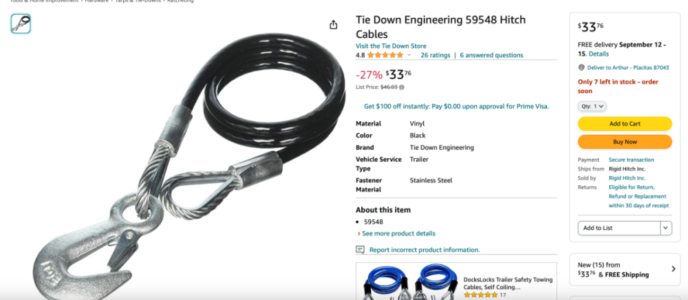

MAX Burner Posted September 3, 2023 Share Posted September 3, 2023 QUESTION: I've noticed that OTT uses a heavier set of curly cables going from 2017 to 2018. Does anyone know why the factory moved from a lighter cable to a heavier one? What are the differences in the stress ratings between the two? Just curious - and would like to know if the smaller diameter cables are rated at 7k# each like these: Art, Diane, Magnus & Oscar (double-Aaarrf!) 2022 TUNDRA 2017 LE II; Hull #226 "Casablanca" HAM call-sign: W0ABX Link to comment Share on other sites More sharing options...
