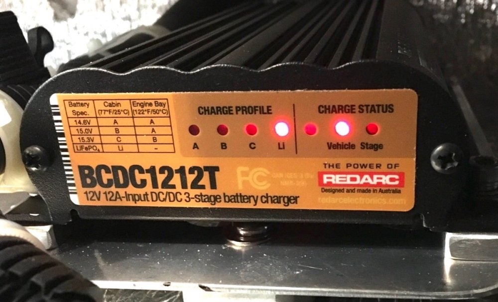

John E Davies Posted October 4, 2021 Posted October 4, 2021 The Redarc charger was a lifesaver on our last trip, 4500 miles through BC and lower Yukon. There were many days where the solar was completely useless, because of cloudy or rainy weather. With the DC to DC charger, I could count on 110 amp hours of charge in a ten hour drive. I ran the generator a couple of times to operate the AC, and only once more did I need to run it to recharge the batteries for about an hour. We stayed at hookup sites about a third of the time. I would like a little higher charge rate, for sure, but for simplicity this is hard to beat, as long as the wires in the trailer are to spec (not undersized!) and I have no regrets. On sunny days I have no worries at all, the combined rate of up to 30 amps of solar and TV charging is great. BTW there is no way my Toyota 5.7 would charge the lithiums more than part way, max voltage is way too low. I would see 14.5 volts (on a Scan Gauge II) with no load, but when hooked to the trailer and charging AGMs, it dropped to around 13.7. That low voltage works fine with the Redarc, which bumps it up to an appropriate value for whatever battery chemistry is selected. And it is a smart charger, so it knows when to taper off the current. https://olivertraveltrailers.com/forums/topic/5270-how-to-redarc-dc-to-dc-11-amp-output-trailer-charger-installation/ John Davies Spokane WA 1 SOLD 07/23 "Mouse": 2017 Legacy Elite II Two Beds, Hull Number 218, See my HOW TO threads: Tow Vehicle: 2013 Land Cruiser 200, 32” LT tires, airbags, Safari snorkel, Maggiolina Grand Tour 360 Carbon RTT.
John E Davies Posted October 4, 2021 Posted October 4, 2021 2 hours ago, VBistro said: Thanks for that very thorough answer....AND it never even occurred to me that the Li batteries wouldn't be recharged by the TV. Oliver does not mention this rather important fact in any of their literature. It’s very deceptive IMHO, especially for a trailer that is advertised as “get off-grid with our new lithium pro package”. Maybe they mean “get off grid but bring a big generator too”. John Davies Spokane WA SOLD 07/23 "Mouse": 2017 Legacy Elite II Two Beds, Hull Number 218, See my HOW TO threads: Tow Vehicle: 2013 Land Cruiser 200, 32” LT tires, airbags, Safari snorkel, Maggiolina Grand Tour 360 Carbon RTT.
Overland Posted October 4, 2021 Posted October 4, 2021 1 hour ago, John E Davies said: Oliver does not mention this rather important fact in any of their literature. True, but what trailer manufacturer does? Remember that B2B chargers are what's required, and while Sterling has been around the marine world for a while I think, they weren't well known in the trailer or overland community until the past few years. So the trailer world has traditionally just ignored the fact that the vehicles could't charge the batteries; just up to now the battery banks were too small for anyone to care (also, people assumed that the charge that they got from their solar while on the road was coming from their truck). Truth is, I think adding a B2B charger to either lithium package is more likely to add another layer of disappointment. Beneficial, yes; but still inadequate. I don't think that Oliver's sin is so much the lack of B2B charging, but that they aren't communicating the limited ability of either that or their solar to charge a super large battery bank. In their defense, most owners find the subject to be pretty opaque. But FYI to all potential buyers, there's a very limited use case for a large battery bank without also investing in large panels and perhaps also a B2B system; i.e., it makes sense only if you're planning to use power at a faster rate than you can recover. There is, and I can't stress this enough, no way to recharge them for continuous use, at least not one that makes sense with this trailer - Oliver's solar package will provide about 70Ah on average, and B2B charging maybe 100 for an 8 hour drive. Even on a long, sunny drive, you would only plan for 170 Ah even with B2B. Not 350, and certainly not 570, which is what would be required to recharge an exhausted pro or platinum LFP package. So, at the end of the day, either your consumption is within those charging limits (in which case, you didn't need the batteries); or you carry a generator to recharge them (in which case, you didn't need the batteries); or you use electricity with wild abandon for six days and then go plug in or run that generator for 6 hours (at least you had 6 days of quiet). I'm not saying no one should buy them; but wow, everyone should give it some deep thought before doing so. There's advantages, just few and far between. 3 4
