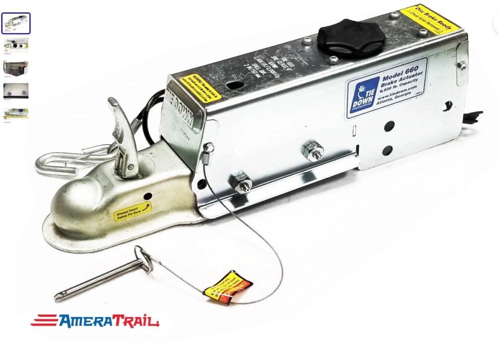

John E Davies Posted November 29, 2021 Posted November 29, 2021 No surge brakes, those are hydraulic drum or disk brakes, operated by the trailer pushing forward on the tongue mounted actuator. Here is what a surge brake actuator looks like. Notice the fluid reservoir cap. All Ollies are delivered with electric drum brakes operated by an electronic controller inside your truck. John Davies Spokane WA 1 SOLD 07/23 "Mouse": 2017 Legacy Elite II Two Beds, Hull Number 218, See my HOW TO threads: Tow Vehicle: 2013 Land Cruiser 200, 32” LT tires, airbags, Safari snorkel, Maggiolina Grand Tour 360 Carbon RTT.
ChrisMI Posted November 29, 2021 Posted November 29, 2021 Was literally typing an explanation of how surge brakes work but John did a better job than I would have. I’ll have to look up the trailer valet…looking for ideas to weld onto my aircraft tow to move trailers around. 2
