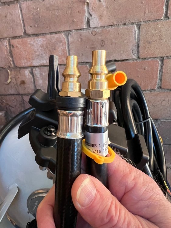

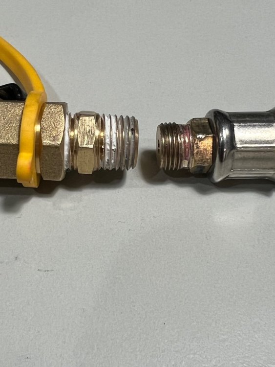

@Happy Camper, I also purchased a Champion Dual Fuel 2500 watt generator, Model 200961.  From reading the OTT forum I learned the regulator provided with the generator should not be used when connecting to the low pressure propane system on our LEII (pickup on Thursday).  So I set about checking that I had obtained the proper low pressure hose and connectors to eliminate the Champion regulator.
I tried connecting a low pressure hose with common ¼" NPT quick connectors to my generator.  I then learned the male quick connector on the hose was incompatible with the female quick connector on the generator, and could not be connected.  Comparing the male quick connector on the Champion regulator male quick connector (below, left) with the ¼" NPT quick connector the low pressure hose (below, right), I found they differ slightly, as can be seen in the photo below.  The ¼" NPT quick connector will not connect to the female quick connector on the generator.
On the left is the male connector on the Champion regulator assembly; on the right the low pressure hose and ¼" NPT quick connector I purchased on Amazon. DOZYANT 18 feet Low Pressure Propane Quick-Connect Hose, RV Quick Connect Propane Hose, Quick Disconnect Propane Hose Extension - 1/4" Safety Shutoff
I contacted Champion technical support and found them to be, essentially, no help.

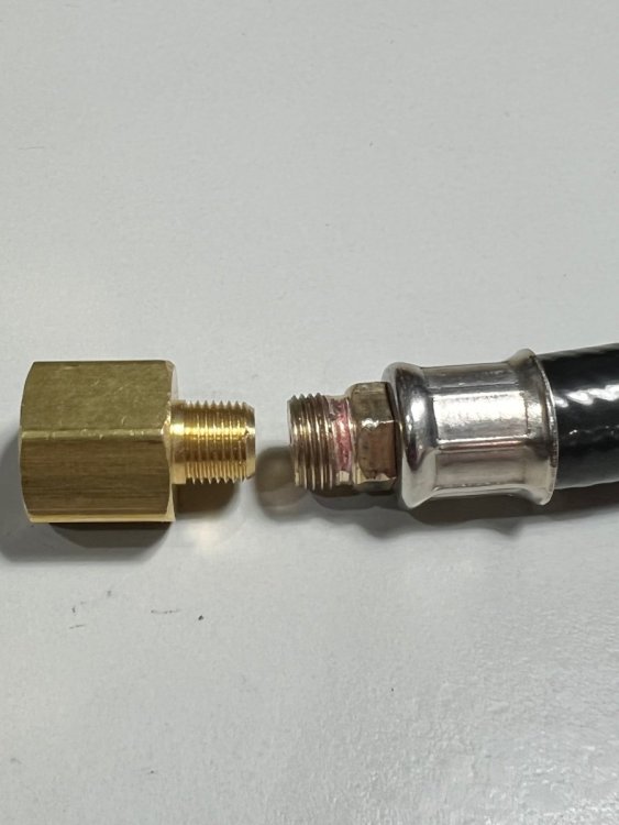

I searched extensively online and found this link: https://www.forestriverforums.com/forums/f224/champion-dual-fuel-inverter-q-c-to-rv-on-board-propane-153043.html
The photo shows a layout of various parts, with detailed notes.  This looked straightforward, so I proceeded to obtain the needed parts.  Only after receiving the parts and attempting assembly did I discover the ports on the safety valve are NOT ⅛" or ¼" NPT, but some ******* size no one has ever seen before.  I spent most of a day calling and visiting suppliers of hose connectors for gas and hydraulic applications in the DFW area.  None had any compatible adapters to connect the common ¼" quick connects to the ports of the safety valve.  The connectors on the  Champion hose connecting the regulator and safety valve measures 0.44" O.D., with a 12 pitch.
Left- ¼" NPT connector; Right- Champion regulator hose connector
Left- 1/8" NPT connector; Right- Champion regulator hose connector

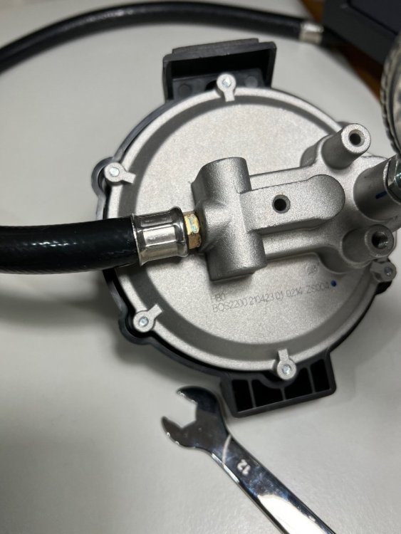

@CNC,  I did not see your post before submitting mine.
Your description caused me to look again at the regulator, and I noticed the regulator connects to the safety valve via an adapter, one end of which is ¼" NPT and the other end is the odd size used by Champion on the two ports the safety valve.  I believe you have solved my problem.  I can now connect a female ¼" NPT quick connect to the safety valve by using the adapter previously used to connect the regulator.
The solution is embarrassingly simple.
Thanks!

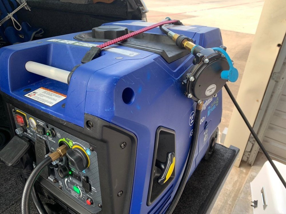

I have been able to run both of my dual fuel generators in the same manner, either directly to a propane tank or the OTT’s QC ports.  The following has been posted a few times on Oliver FBs in response to others requesting pertinent information:  To answer your question, alter the two stage regulator system that comes with most dual fuels by installing a QC between the first stage (primary) and second stage (secondary) regulators. When utilizing the Oliver’s QC for propane, the primary regulator is removed and only the secondary is needed to operate the genny within reach of a hose. I typically pass an extension hose connected to the Oliver’s front QC through the access port on the front tank housing and stage the genny on the trailer tongue, TV tailgate or ground. If you want to connect directly to one of the trailer’s tanks or a spare, you simply utilize the two stage regulator by rejoining with the QC.
Attached photos show the divided regulator and secondary stage only being used to operate generator by an extension hose from the OTT’s front QC.
Additional info: I too have the Westinghouse iGen4500DF and find on long hose runs to have the regulators close to the generator with use of an extension hose when spanning directly from a propane tank to the generator.

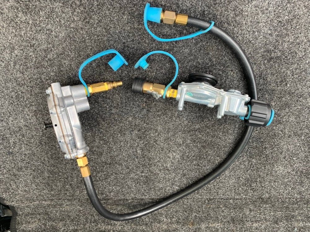

I own both the Champion 3500W and now the 2500W Generator.
I wanted to mod both to run off the Quick Connects from the Oliver...and also still have the ability to quickly setup with stand alone propane tanks for other applications.
Both use the 2500W and 3500W us a dual stage regulator propane hose (one with the little finger, one without.)
The first stage small regulator  connects to a standard propane tank with the larger plastic ACME fitting.
The first stage regulator knocks down the high pressure from  stand alone propane tanks in prep for the larger diameter second stage regulator.
This second stage (much larger size) provides a more precise regulation needed for the generator under various load situations. Stage 2 is really a flow regulator. It doesn't change pressure, it just restricts the amount of gas that flows into the generator. Without it you basically flood the generator with gas and it won't start.
To make the Generator work with the quick connects from the trailer, one must remove that smaller first stage regulator.
The Oliver Quick connects are already regulated to the correct pressure for the larger second stage regulator on the generator propane cable shipped with the Champion Dual Fuel Generators.
In my case, I've disassembled the original dual stage and broken it into two pieces at the coupler between the stage 1 and stage 2 regulators.
1) The second stage regulator has been modified to have a quick connect male feeding into the larger regulator.  That stage 2 regulator now connects to my long extension hoses that attach to the female quick connects on the trailer.
2) The first stage regulator is then coupled to a FEMALE quick connect for re-use with stand alone propane tanks.
Shown below:  First stage regulator with ACME fitting is modified to have a female quick connect coupler.
The benefit of this mod is that I still am able to use stand alone 20lb propane tank by coupling the modified smaller regulator to the tank, and the larger stage 2 regulator hose to that this modified coupler.
This may be a repeat but I was writing up for my blog anyway so thought I'd post it here.
Craig
