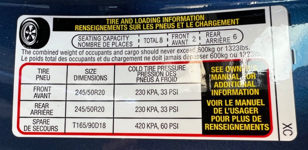

DunnYet Posted March 6, 2022 Author Share Posted March 6, 2022 On 3/2/2022 at 9:40 PM, ChrisMI said: I’m impressed that you could return over 13mpg with the engine holding 3.5-4k rpm’s! Thanks for the detailed report, could you provide the payload capacity shown on your door jam sticker? Would love to - even went out and took a photo. Unfortunately I can't figure out a way to attach a photo currently. Have tried three different image hosting sites as well as direct upload and nothing seems to be working. Will try again later. 2 Current: 2023 Oliver Elite II - Hull #1364 "Reset 2.0" (Second Owner) Tow Vehicle: 2023 Ford F-150 XLT 3.5L EcoBoost /w 3.55 axle and Max Tow Package "SIlver" Original: 2022 Oliver Elite I - Hull #1030 "Reset" (For Sale) Original Tow Vehicle: 2022 Subaru Ascent "Blue Moose" Home Base: Duncanville, TX Link to comment Share on other sites More sharing options...

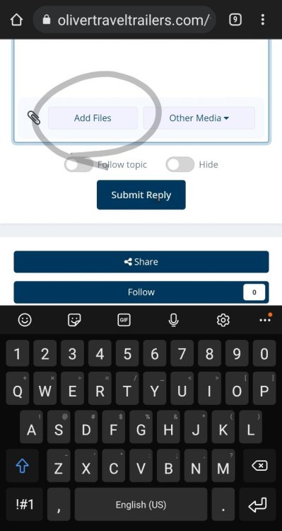

Moderators SeaDawg Posted March 6, 2022 Moderators Share Posted March 6, 2022 Look at "add files", at the bottom of the page. 1 2008 Ram 1500 4 × 4 2008 Oliver Elite, Hull #12 Florida and Western North Carolina, or wherever the truck goes.... 400 watts solar. DC compressor fridge. No inverter. 2 x 105 ah agm batteries . Life is good. Link to comment Share on other sites More sharing options...
Trainman Posted March 6, 2022 Share Posted March 6, 2022 14 hours ago, DunnYet said: Would love to - even went out and took a photo. Unfortunately I can't figure out a way to attach a photo currently. Have tried three different image hosting sites as well as direct upload and nothing seems to be working. Will try again later. Not sure what is going wrong with posting pics, but I do know that some pics that I would like to post from the internet will not transfer to My Pictures on my computer, they go into File Explorer, but can't get them out a pics. trainman 1 2019 RAM 1500, 5.7 Hemi, 4X4, Crew Cab, 5'7" bed, Towing Package, 3.92 Gears. Oliver was sold. Link to comment Share on other sites More sharing options...

Moderator+ ScubaRx Posted March 8, 2022 Moderator+ Share Posted March 8, 2022 On 3/5/2022 at 6:00 PM, DunnYet said: … Unfortunately I can't figure out a way to attach a photo currently. Will try again later. Or, You could just post the weight carrying capacity. 1 3 Steve, Tali and our dog Rocky plus our beloved Storm, Maggie, Lucy and Reacher (all waiting at the Rainbow Bridge) 2008 Legacy Elite I - Outlaw Oliver, Hull #026 | 2014 Legacy Elite II - Outlaw Oliver, Hull #050 | 2022 Silverado High Country 3500HD SRW Diesel 4x4 Link to comment Share on other sites More sharing options...
ChrisMI Posted March 8, 2022 Share Posted March 8, 2022 9 hours ago, ScubaRx said: Or, You could just post the weight carrying capacity. I’m not sure why I’m always so curious about payload. Same thing with useful load…if someone lists their plane for sale I could care less what color it is. I want to know what it’ll haul! 1 2 Link to comment Share on other sites More sharing options...
Frank C Posted March 8, 2022 Share Posted March 8, 2022 2 hours ago, ChrisMI said: I’m not sure why I’m always so curious about payload. Same thing with useful load…if someone lists their plane for sale I could care less what color it is. I want to know what it’ll haul! We are always curious about payload/cargo rating of the tow vehicle because it does affect “what it’ll haul”. Tongue weight of the trailer counts towards the tow vehicle payload number. And a lot of people are unaware that they have exceeded their payload limit with the trailer hooked up, driver and passenger(s) weight, any installed accessories on the tow vehicle like a bed liner, bed cover, or bed cap, a toolbox, a loaded cooler, camping gear, etc. all loaded up. It’s surprising how low the payload number is on some vehicles, even some 1/2 ton pickup trucks. An Elite II tongue weight plus a driver and 1 passenger are ~1,000 lbs. of payload. Even an Elite 1 with driver and passenger is ~750 to 800 lbs of payload. But that Subaru Ascent looks like a pretty good match for an Elite I. 1 2 Link to comment Share on other sites More sharing options...
John E Davies Posted March 8, 2022 Share Posted March 8, 2022 A quick search for that Ascent Limited shows 1485 pounds "as delivered". I can't vouch for the accuracy, but it is a pretty decent figure for a unibody SUV.. John davies Spokane WA 1 1 SOLD 07/23 "Mouse": 2017 Legacy Elite II Two Beds, Hull Number 218, See my HOW TO threads: Tow Vehicle: 2013 Land Cruiser 200, 32” LT tires, airbags, Safari snorkel, Maggiolina Grand Tour 360 Carbon RTT. Link to comment Share on other sites More sharing options...
Moderators topgun2 Posted March 8, 2022 Moderators Share Posted March 8, 2022 25 minutes ago, John E Davies said: but it is a pretty decent figure for a unibody SUV.. Actually - that is remarkable. 2 2023 Ford F150 Lariat 3.5EB FX4 Max Towing, Max Payload, 2016 Oliver Elite II - Hull #117 "Twist" Near Asheville, NC Link to comment Share on other sites More sharing options...
Rivernerd Posted March 8, 2022 Share Posted March 8, 2022 1 minute ago, topgun2 said: Actually - that is remarkable. (Referring to the 1485 lb. payload capacity of a Subaru Ascent). That number exceeds, by 50 lbs ., the specified payload capacity of my 2019 Tundra Double Cab 5.7L with standard bed and towing package. It is truly remarkable for a unibody SUV. 2 Hull #1291 Central Idaho 2022 Elite II Tow Vehicle: 2019 Tundra Double Cab 4x4, 5.7L with tow package Link to comment Share on other sites More sharing options...
ChrisMI Posted March 8, 2022 Share Posted March 8, 2022 1 hour ago, John E Davies said: A quick search for that Ascent Limited shows 1485 pounds "as delivered". I can't vouch for the accuracy, but it is a pretty decent figure for a unibody SUV.. John davies Spokane WA That is the manufacturers provided number for the trim level. On many other vehicles it seems like they are optimistic by 10-15%. Still curious to see the actual but agree it is very impressive for that size of car. 2 Link to comment Share on other sites More sharing options...

DunnYet Posted March 10, 2022 Author Share Posted March 10, 2022 Sorry for the delay in getting back to this, was on a work trip first part of the week and have some seat time flying back tonight to catch up. Seating Capacity : Total 8 Front: 2 Rear: 6 The combined weight of occupants and cargo should never exceed 600kg or 1323 lbs. Again this is from the Limited Trim line without the sunroof. 2 Current: 2023 Oliver Elite II - Hull #1364 "Reset 2.0" (Second Owner) Tow Vehicle: 2023 Ford F-150 XLT 3.5L EcoBoost /w 3.55 axle and Max Tow Package "SIlver" Original: 2022 Oliver Elite I - Hull #1030 "Reset" (For Sale) Original Tow Vehicle: 2022 Subaru Ascent "Blue Moose" Home Base: Duncanville, TX Link to comment Share on other sites More sharing options...
