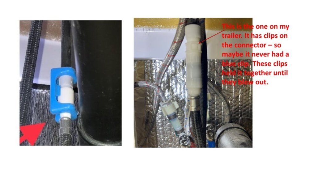

Lowes has the blue clip

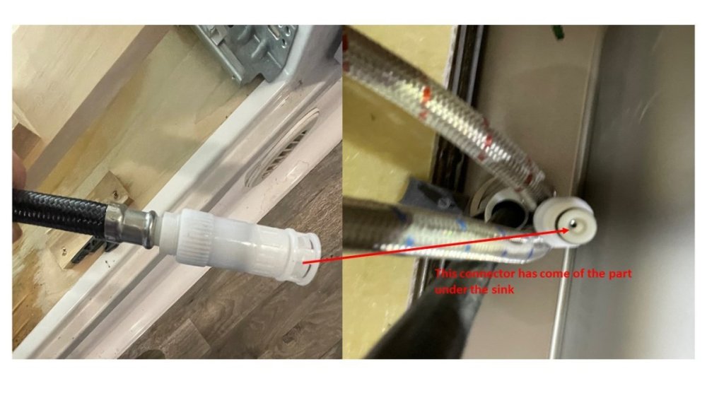

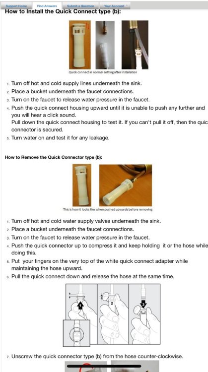

All, latest update. The saga continues.  I did get a blue clip that Townesw showed in his pic but now that I have looked at it I am left wondering if the faucet I have didn't come with a blue clip. If you look at Townesw pic on the left and mine on the right they do not look like the same connectors. Mine on the left has push in clips holding it together and now I have a blue clip I am not sure if I can get it on. Also my connector looks longer. I have a neighbor that is pretty handy with plumbing that is going to take a look. Maybe the push in clips in mine were all that was intended to hold it together until they didn't. So far with the water pump the connector is holding but I am wondering if I hook up city water that has higher pressure, will it blue apart again. I have put the drawers back yet.  Anyone have any thoughts?
I submitted a ticket to Oliver on this issue but I need to follow up with a phone call to them and get this cleared up.
Maybe I should just get duct tape and tape it together 😁
Or just not use the sink since it wasn't getting used as I didn't notice it actually had a pull down sprayer and someone pointed that out to me!
When you call Oliver's Service Department, see if they can tell you which brand of faucet was installed in your specific Hull #.  I presumed it was a Delta with the blue clip because I saw the blue clip in the Townesw photo.  But your new photo demonstrates that the two connections are not the same.
Even Delta uses different clips for different faucet models, like the black one pictured here:
https://www.amazon.com/Delta-Faucet-RP32522-Quick-Connect-Clip/dp/B000UB9U96/ref=asc_df_B000UB9U96/?tag=hyprod-20&linkCode=df0&hvadid=167155689281&hvpos=&hvnetw=g&hvrand=14985865155053231365&hvpone=&hvptwo=&hvqmt=&hvdev=c&hvdvcmdl=&hvlocint=&hvlocphy=9029558&hvtargid=pla-273474638602&psc=1
In addition to the "blue clip" models, I have also installed Delta faucets with this kind of black clip.  Maybe Oliver Service can send you in the right direction?
This incident, and the one referenced by Corvus above make me wonder if Oliver has installed some kitchen faucets that don't come with a clip, and thus the failures?  You might ask them about this.  If yours was a "clipless" faucet that failed maybe they would send you a replacement without charge?
I would also invest in a water sensor, like the one listed by Sakthorp, above.  I plan to place one of those under the kitchen sink in the new Elite II we are picking up in the fall!
If you go the tape route, I recommend Gorilla tape, cut into 1/2" strips and tightly spiral wrapped, over duct tape.
If you can't find a clip that fits, and you do end up taping to get you through your trip to Utah, I recommend you replace the faucet with one that includes the clip after you get home.

Not all quick connect faucet fittings use  a clip.  Some are just “Push to click” connections.   It’s possible your hose fitting just wasn’t installed properly when the trailer was built.   If you’ve pushed the connector back on until you heard or felt a click, it may be ok now.  But keep an eye on it.
