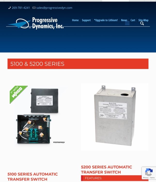

Interesting that the new version of the Progressive Dynamics transfer switch now uses the Wago lever type connectors instead of a terminal block strip.

My Progressive Dynamics transfer switch model has been discontinued. Their website states the new replacement model number is: PD5110010Q
I ordered a new one from E-trailer and it will arrive Wednesday. Now I need to find an electrician.

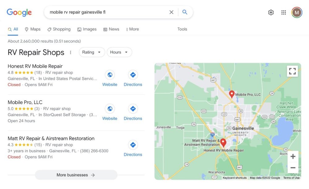

Try these if you haven’t found anyone.
Thanks. My electrician I use for my house wants to do it for me. I am glad. Now I am crossing my fingers that there wasn't more damage done that I didn't see.

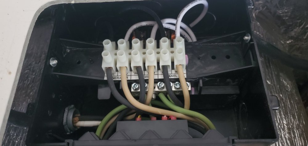

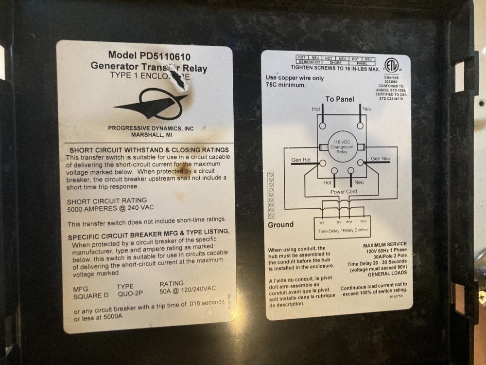

Thanks for posting this issue. As soon as I finished reading the post, I went out to my 2018 Elite II and checked to see if the connections were tight, which they were.
Attached is pictures of my transfer switch, which is a Series 5100 switch.
When you get the new one, let us know if the wire connectors are different then on our transfer switch.

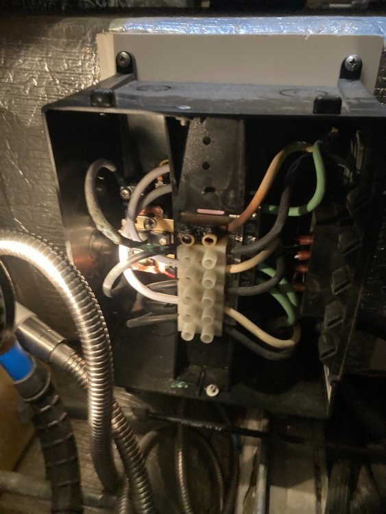

I discovered the problem. The lunchbox basically blew up at one connection. Pics will show. Now what? Call Jason or Progressive?
We had a very similar issue in our 2018 LE2 this past summer.  Fortunately, it happened while we were at the Oliver rally and expert help was literally all around us.  Long story short; our transfer switch almost caught on fire (worse than yours looking at the pic). It was determined that there was a loose connection in the box which caused a "low voltage" error code in the EMS in the overhead, rear compartment.  Low voltage equals "heat".  Don't remember off hand if the code was E4 or E8 but the system stores past codes so you should check yours to see what it reads.
In our situation, the Oliver Service folks at the rally arranged for us to get the trailer serviced the following day (first day following the rally) back at the mother-ship.  Transfer switch was replaced and we were headed back to VA before lunch time, no charge.
Recommend everyone with a transfer switch in their units (only applicable to units with the second 30 AMP receptacle for a generator), disconnect their shore power, open up the transfer switch (located under rear dinette seat) and check tightness of their connections.  Might be something you would want to do annually if you bounce down the road a lot each year.  They shouldn't loosen up but.......  2 HOBOS
Still waiting on my electrician. He got Covid-19 almost immediately after receiving the new transfer box and arranging our appointment. He told me to wait for him if I could. So I wait. Thanks for the info.
