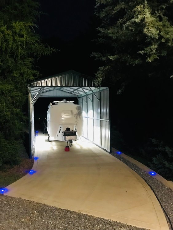

Patriot Posted December 28, 2022 Posted December 28, 2022 We kept it fairly simple 13’w 11’h 25’L and no doors just an all steel building. Having a (3) car garage upper attached and a lower basement garage we just did not need another garage. So we had an “Ollie Hangar” built 6 months ago. Lead time from when we ordered was two weeks. In a day and a half we had our Ollie under cover. The concrete pad is 13x55. This has worked perfectly for our needs. From this - . To this- 5 2020 OLEII - Hull #634 aka- “XPLOR” 2021 F350 6.7 liter Diesel Lariat Ultimate Tremor aka - “Beast of Burden” Truma Aventa 13.5 AC, Alcan 5 leaf pack, Alcan HD shackles & HD wet bolts, 5200lb never lube axles.XPEL 10 mil PPF front both front corners, 30 lb LP tanks, Sea Biscuit Front Cargo Storage box. ⚡️⚡️11/2025- Lithium upgrade to XPLOR - (2) Epoch 300ah Lithium batteries, Victron 3000W MultiPlus-II, Victron GX Touch 70, Victron Cerbo GX, Victron Smart Solar MPPT, Victron Smart Shunt, Victron Orion XS 1400 DC-DC charger, RV Soft Start. Zamp 90W suit case solar panel for 420W of solar.⚡️⚡️ North Carolina
Moderators SeaDawg Posted December 29, 2022 Moderators Posted December 29, 2022 Lovely olllieport, @Patriot. Could you remind folks where you are? I don't think snowload is a big part of your equation. But, I could be wrong. 1 2008 Ram 1500 4 × 4 2008 Oliver Elite, Hull #12 Florida and Western North Carolina, or wherever the truck goes.... 400 watts solar. DC compressor fridge. No inverter. 2 x 105 ah agm batteries . Life is good.
John and Debbie Posted December 29, 2022 Posted December 29, 2022 2 hours ago, Patriot said: We kept it fairly simple 13’w 11’h 25’L and no doors just an all steel building. Having a (3) car garage upper attached and a lower basement garage we just did not need another garage. So we had an “Ollie Hangar” built 6 months ago. Lead time from when we ordered was two weeks. In a day and a half we had our Ollie under cover. The concrete pad is 13x55. This has worked perfectly for our needs. From this - To this- They did a nice job. Love the "airport lights" and pad area. John 1 1 John and Debbie, Beaverton, Oregon, 2017 Ford Expedition EL 4x4 3.5 liter Ecoboost, with heavy duty tow package. Hull #1290, twin bed with Truma package (a/c, furnace, hot water heater with electric antifreeze option), lithium pro package, picked up November 7, 2022 Alcan 5 leaf springs and Bulldog shocks done May 20, 2025 in Grand Junction, Colorado
Patriot Posted December 29, 2022 Posted December 29, 2022 4 hours ago, SeaDawg said: Lovely olllieport, @Patriot. Could you remind folks where you are? I don't think snowload is a big part of your equation. But, I could be wrong. @SeaDawg Thank you. 😊 We are located in Western NC and we rarely get very much snow at all. And not having any frost in the ground during winter what little snow we do get does not last long. Our roof on the Ollie Hangar is snowload certified/rated for 35# per square foot. We sure hope it’s never tested. 2 2020 OLEII - Hull #634 aka- “XPLOR” 2021 F350 6.7 liter Diesel Lariat Ultimate Tremor aka - “Beast of Burden” Truma Aventa 13.5 AC, Alcan 5 leaf pack, Alcan HD shackles & HD wet bolts, 5200lb never lube axles.XPEL 10 mil PPF front both front corners, 30 lb LP tanks, Sea Biscuit Front Cargo Storage box. ⚡️⚡️11/2025- Lithium upgrade to XPLOR - (2) Epoch 300ah Lithium batteries, Victron 3000W MultiPlus-II, Victron GX Touch 70, Victron Cerbo GX, Victron Smart Solar MPPT, Victron Smart Shunt, Victron Orion XS 1400 DC-DC charger, RV Soft Start. Zamp 90W suit case solar panel for 420W of solar.⚡️⚡️ North Carolina
Patriot Posted December 29, 2022 Posted December 29, 2022 3 hours ago, John Welte said: They did a nice job. Love the "airport lights" and pad area. John John, Thank you it took a little time for it to all finally come together. We sure are very grateful to have a place at home to park our Oliver. Those lights are solar powered and we purchased them off Amazon. -Patriot 🇺🇸 3 2020 OLEII - Hull #634 aka- “XPLOR” 2021 F350 6.7 liter Diesel Lariat Ultimate Tremor aka - “Beast of Burden” Truma Aventa 13.5 AC, Alcan 5 leaf pack, Alcan HD shackles & HD wet bolts, 5200lb never lube axles.XPEL 10 mil PPF front both front corners, 30 lb LP tanks, Sea Biscuit Front Cargo Storage box. ⚡️⚡️11/2025- Lithium upgrade to XPLOR - (2) Epoch 300ah Lithium batteries, Victron 3000W MultiPlus-II, Victron GX Touch 70, Victron Cerbo GX, Victron Smart Solar MPPT, Victron Smart Shunt, Victron Orion XS 1400 DC-DC charger, RV Soft Start. Zamp 90W suit case solar panel for 420W of solar.⚡️⚡️ North Carolina
