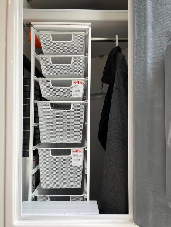

Steve Morris Posted June 10, 2023 Share Posted June 10, 2023 That looks pretty useful! For additional ideas, there's a place called Katy's Casita Closets that makes the rounds at fiberglass rallies, installing closet inserts. And here's a link to the Oliver Facebook group, where a lady used Elfa baskets in her closet. These look interesting, too. https://www.facebook.com/groups/OllieOwners/posts/1320869994984785/?__cft__[0]=AZUYzaw7itmIpwTl-fIsYD1PrXn88-adduelPhPaNGvVh31UKWdEHCPD2RMyfcl__eZj2wRX3oRL0ZTuu82-3R5xNtPz3PK1ZClQeTY4VOzEdEgjcwFxRB0IC6ahDmL5pIkR5o4f_THtV4mBO0KW0CiH71rjGcU5pASc6AJ3LTwMF8L6p-7DgR_PF-g-j7oMtRg&__tn__=%2CO%2CP-R 3 ----- Steve - Northern Ohio, USA Wandering around on occasion, always lost. 2021 Toyota Land Cruiser - 2023 Oliver Elite II Twin Hull #1360 “Curiosity” Facebook - Instagram Camped in Curiosity = Green —— Visited with Curiosity = Gray Link to comment Share on other sites More sharing options...

rich.dev Posted June 14, 2023 Share Posted June 14, 2023 On 6/10/2023 at 10:45 AM, Steve Morris said: I like the Elfa baskets but the link doesn’t work…shows “content not available”, do you maybe have more info or another link? Thanks! 2023 Elite II, Hull# 1386, Lithium Platinum Package (640AH, 400W Roof Solar, 3000W Xantrex Inverter), added 400W Renogy Solar suitcase with Victron MPPT 100/30 CC, Truma water heater & AC TV: 2024 Silverado 2500HD 6.6L 10-Speed Allison Link to comment Share on other sites More sharing options...
Steve Morris Posted June 14, 2023 Share Posted June 14, 2023 @rich.dev I guess you need to be a member of that Facebook group to view the post. She says: ” Hull #1216 “Ollie Belle” I just completed the Elfa closet project and wanted to share because I’m relieved to be done with it LOL! I went with the X-Narrow because I tried the Narrow and it gave me less room for hanging coats. I’m a coat/sweatshirt hoarder so I wanted to split the space. If you go with the X-Narrow, you have 10” +/- wide of a container and 10” +/- wide of hanging space or “other” space. If you decide on Elfa, you have a handful of configurations for drawer combinations. You’ll absolutely want a 3-runner drawer in the bottom for long term storage because you can’t pull it out, you have to remove drawers above to get to the items, no biggie. I duct taped a piece of styrofoam to create a “shim” at the bottom so it’ll stay in place. I also cut a pool noodle and added it to the clothes rod just for a “shim”. The telescopic ladder is beside it. You also have space for an additional container below the clothes if needed but there’s lots you can do with the space split in half. Others have the Narrow collection which is 14” wide.” 1 ----- Steve - Northern Ohio, USA Wandering around on occasion, always lost. 2021 Toyota Land Cruiser - 2023 Oliver Elite II Twin Hull #1360 “Curiosity” Facebook - Instagram Camped in Curiosity = Green —— Visited with Curiosity = Gray Link to comment Share on other sites More sharing options...
