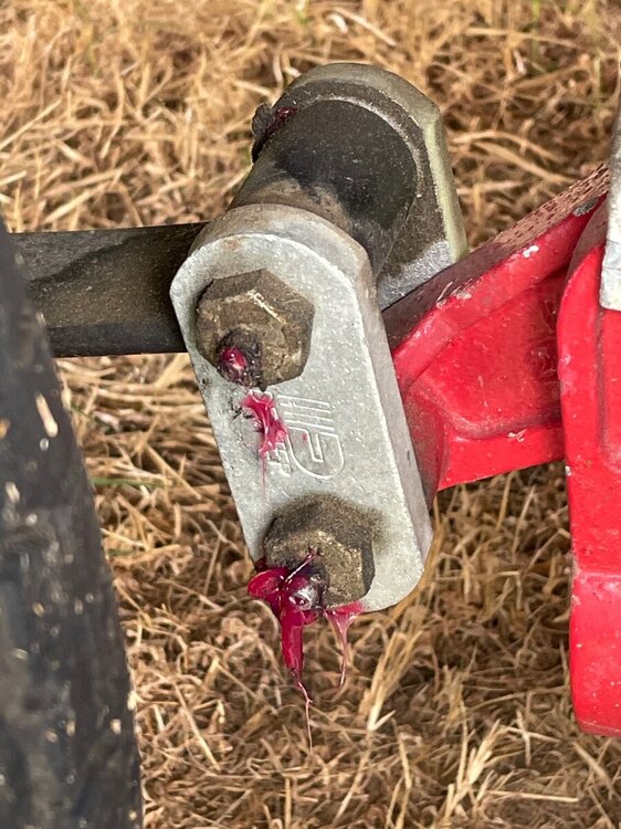

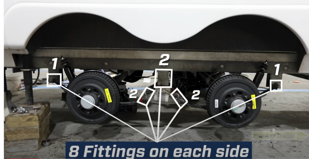

On 6/15/2023 at 8:12 AM, John E Davies said:
regular servicing, a warning sign that you need to relube is creaks or pops when making tight turns.
This forum, and you sir, rock.
I had called Oliver service after hearing such a noise.  I never heard back from them and forgot about it until I read this.
I was hearing the "creaks and pops".  I just lubed the 12 zerks.
Thanks so much
Thanks so much
@HDRider FWIW there are 16 zerks on my 2022 #1047. There are two on each side where suspension attaches to frame that are easy to miss.
2022 Oliver Elite II Hull#1047 "Saunter"
Solar Pro 390 aH Lithionics
2022 Ram 1500 5.7L Hemi
ALAKAZCOILINIAKSMIMONENVNMNCOHSCTNTXUTWV

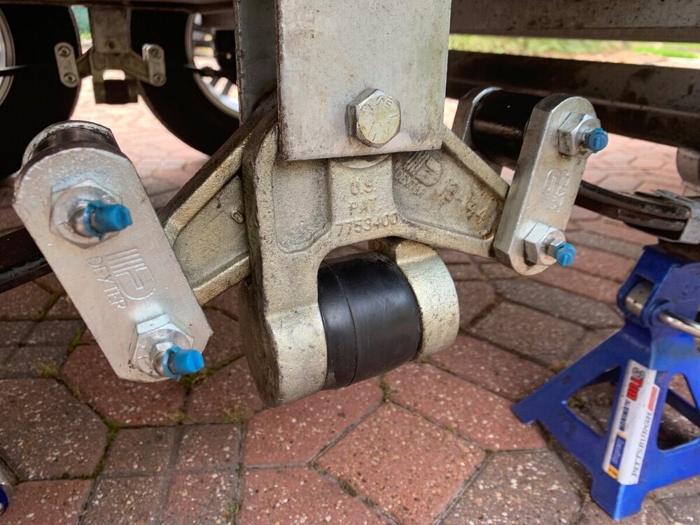

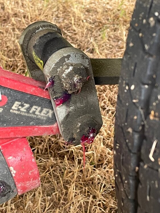

I hit these on both sides. What did I miss?
There are two more Zerks fittings in the center EZ-Flex mount on the frame - one facing fore, one aft, here's a couple pix to orient your perspective:
Above pic show the forward facing Zerk...
Above pic show aft facing Zerk...
FYI:  There's 8 zerks per side on our 2017 OTT...

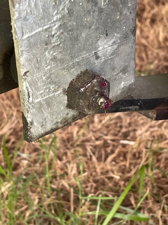

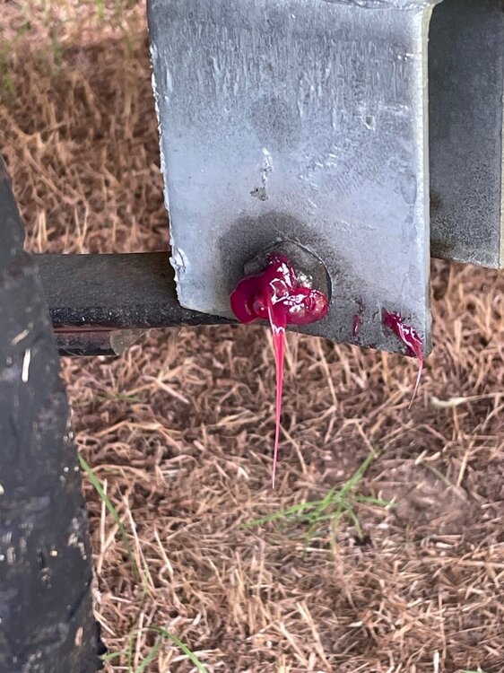

Also not the use of zerk caps.  Very good way to keep junk out of the grease fittings.
Also, you want to clean up all the excess grease after every lube job. You can see in the pics above how grease left there previously collects more dirt. In the pic below, clean Zerk caps were fitted on clean Zerks.
