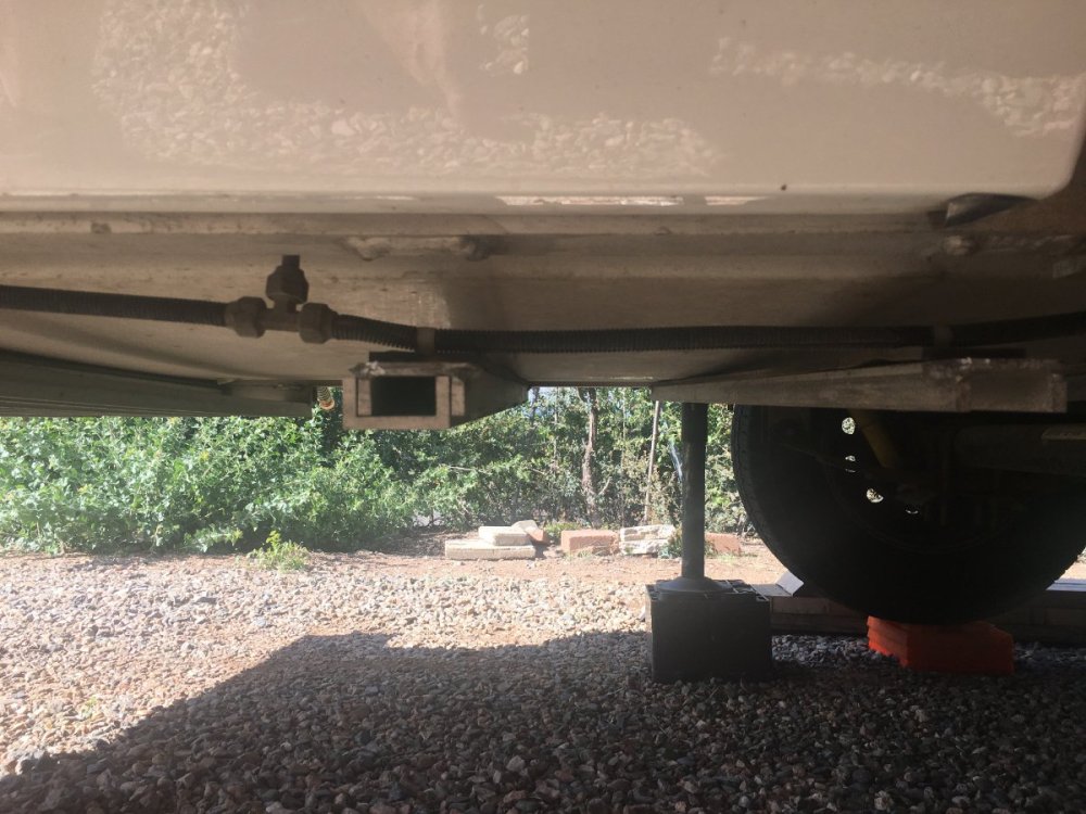

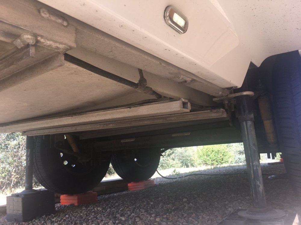

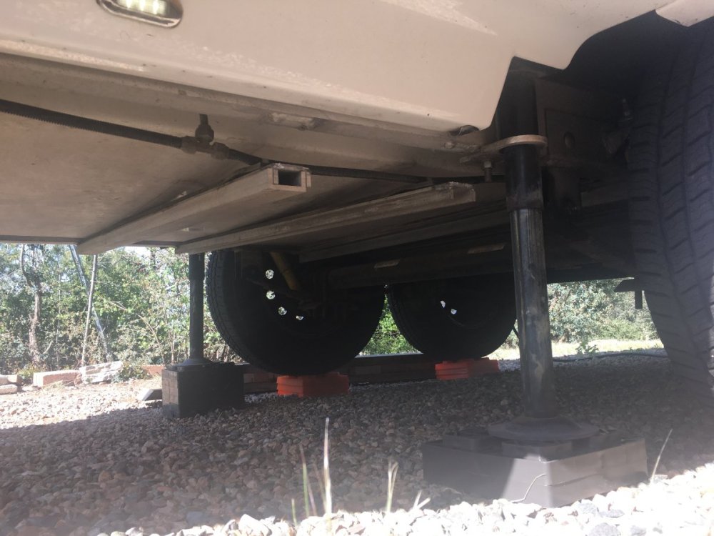

I just thought I would make others aware of an issue I found, go figure just the week after we bought our older Oliver EII. I can't remember a time, when purchasing a used car or truck that I had not laid on the ground inspecting the bottom side, left, right and front to back! For some reason, when we first viewed our OTT listed locally for sale, I did not look underneath. I think I was enamored by the beauty of and cleanliness of it, along with I felt we were just looking, and I wasn't thinking I would spend this kind of money on a TT. Later we closed the deal over the phone. Paid for it 2 days later and the prior owner brought it to our home.
I was down low installing 6" hose extensions on all the hose inlets, and I thought it was a good time to inspect underneath and could NOT believe what I found!
Pictures to follow. I found 2 broken welds, curbside the first two right behind the wheels. OMG, my heart sunk! I called the prior owner. He thought I did it by overdoing the stabilizer jacks (not). He said he recently greased the Dexter components and he could swear the damaged was not there before (again, not). You could tell by the aluminum corrosion that these had broken some time ago.
I'm not asking for help here, as I found a guy in town who runs a welding shop and does contract welding for many metal artists in town. He repaired this, charging an hour $75. Most of the hour was setting up for aluminum welding and creating a heat shield. I believe he used MIG. I gave him a Ben Franklin and it was done prior to our maiden voyage a few weeks back.
I had no idea the aluminum welds would break at the contact point. The OTT welds must have been defective when the frame was built (edit: OTT likely welded this fine, later replies show this to be 80 PSI tire pressure). I called OTT service to ask about this and other questions, and the rep really had little to comment.
My reason for writing this thread, is to let others know and to suggest that if you haven't looked under recently, it is a good idea to inspect your frame soon and regularly. Thanks for reading.

I think it is very good that the sagging crossmember did not break the gas line. If you haven’t already, take a very close look at all the propane lines you can get to inside the trailer. Was there any damage to the fiberglass belly from hanging down unsupported?

The first thing welder said was, "That wouldn't be an LP line, would it?" I said, "Yeah, the tanks are off and I released the gas in the line." and he proceeded without worry. There is a little kink in the line, as you can see front of the T, but it holds pressure, so I left it as-is. Yes John, good observation. The vertical line is right there, going up to the kitchen (edit: Furnace and HWH) which could have been damaged. We camped 3 days, just after fixing this and if there was an interior leak, I certainly would have smelled it. I would think it would be difficult to eyeball/follow that line along its entire length. No sag, no fiberglass damage visible.

What were the tire pressures when you first checked them?
34 minutes ago, John E Davies said:
What were the tire pressures when you first checked them? John Davies
Yep, they were 80 and I believe all former owners ran this trailer at 80 PSI. Do you think that alone could cause alum welds to fail?
This does make good sense! And let's say the habit was to leave home or campsite, black and gray empty, fresh and HWH full, making the right-rear heavier and that's where the welds failed!

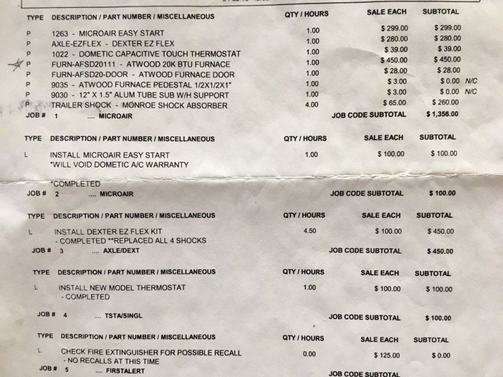

John, you and others reading might be interested in this. Your question got me looking at the old maintenance records. Our Hull 113 made its way back to OTT twice, April 2018 and May 2021. In 2018 it received the EZ FLEX upgrade, new Atwood furnace and another page shows "Replaced gas line to furnace and performed yellow jacket gas and function test." The LP line is wrapped in an automotive plastic wire loom. Our Oliver received major upgrades for 2018 (pic below).
I imagine the welds broke in the year after OTT serviced the trailer May 2021, because certainly they would have seen it. The breaks looked 1-2 years old and it must have come from the rigid tires at 80 PSI. The 2018 receipt also shows new Monroe shocks, the ones on the trailer are yellow, looking like Bilstein from a glance, but perhaps Monroe also used yellow paint. I will know when I service them and will remove the shocks to bench test, replace if worn.
I imagine prices would be 2x today!
(Tried 3 times to get this photo right-side up.)

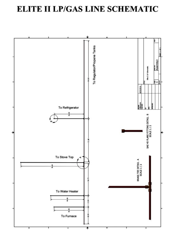

On 7/24/2023 at 7:59 AM, Boudicca908 said:
Is there a diagram for that? I didn't see one in my manual. Does the LP go to the WH first, then the furnace, then back to the stove and fridge?
If you have an original refrigerator that Oliver installed and it runs on propane, the schematic below from 2017 may be of interest.  You can probably verify the propane line running from the propane box in front to the rear bumper by looking for the copper tubing below and outside of the trailer on the curb side.  And if you have an outside access panel at the bottom of your refrigerator, the penetration of the gas line is probably visible coming through the floor.
