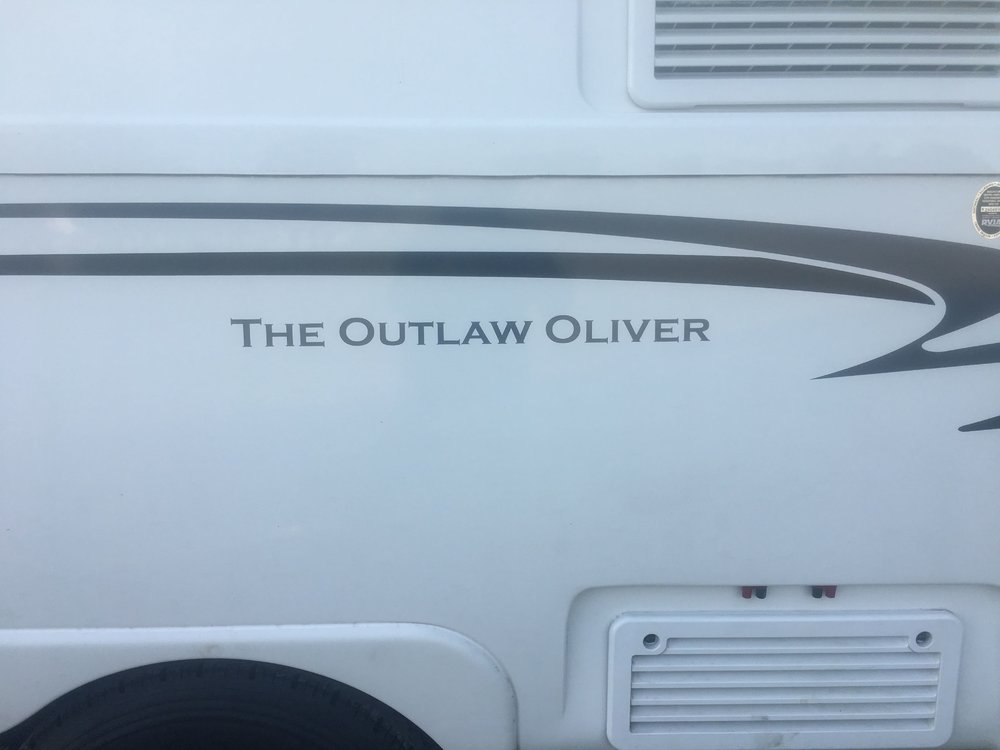

Size of Custom Vinyl Graphic On Trailer Front?
ScubaRx replied to CedarForks's topic in Mechanical & Technical Tips
My custom front graphic is about 20 inches across. -
