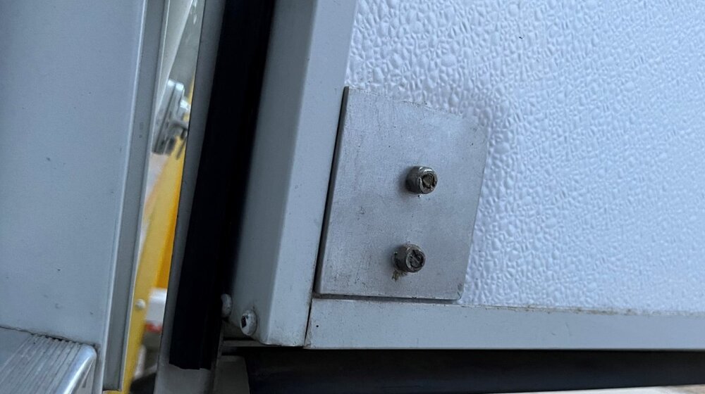

Here again is the picture I took to show the Lippert Friction Hinges installed. I hadn't paid attention to the cracks on our door until this thread was started Nov '24, since the cracks are minor and often hidden by the screen door. I believe if Lippert or OTT made Friction Hinges standard, we would not see this wind damage, but not Craig's issue which looks like a manufacturing defect.
Were the doors made differently through the years? I think not, except perhaps for Chris' @CRM with his one-off 2010 hull. Bill's @topgun2 door has no cracks. Mike @Mike and Carol and I both have minor cracks. These hulls are all 2016 and the doors likely came from the same Lippert batch.
Perhaps Bill kept his door from banging on the stopper better than Mike did and I did (including prior owners). I know before I installed friction hinges the door flew out of my hands several times banging against the stopper as I cringed! It's often very windy where we camp! No more door bangs, no further damage since the friction hinges were installed.
Craig, I'm very sorry to hear of your misfortune. I believe Lippert owes you a door. Your damage is not from abuse. At a minimum, ask them for money back on the core you paid for, that should still be under warranty, towards purchase of a new door. Make some noise and hope for some help! Best wishes, JD
