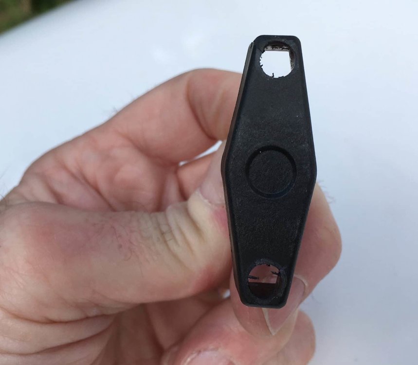

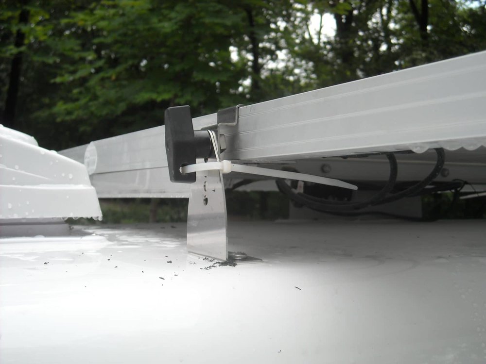

Popular Post John E Davies Posted July 14, 2017 Popular Post Posted July 14, 2017 Three days after we took delivery of Mouse, I climbed up my ladder for a check of the roof. Everything looked fine, except for the solar panels. Three knobs were slightly loose, perhaps a 1/16th of a turn. One was a full half turn loose. This is dangerous since a loose or lost knob could wreck the panel and possibly the vent and AC unit behind it, especially if you are towing into a stiff and gusting headwind. I got out my Dewalt driver drill and modified the knobs so that I could secure them tight. I can't recall the hole size, probably 1/4 inch, big enough for a standard sized nylon wire tie. This is just like safety wiring a bolt using steel wire, but the advantage is that the big white ties are highly visible from the ground, so you can include a visual check of all four as you do your final walk around before leaving. You must route the tie so that all the forces are acting to tighten the knob. I think this should be done at the factory, but in the meantime I strongly recommend that everyone with panels on the roof secure the knobs. A better fix would be to drill out the threaded inserts and install through bolts with self locking nuts, but this would make it very hard to reposition the panels for cleaning the roof underneath.... Here is a question: have you ever checked them? If not, then please do so before your next trip. They may be loose.... Be safe. Here is my Werner convertible ladder in action. It is good to have access to your roof, always. John Davies Spokane WA 11 4 SOLD 07/23 "Mouse": 2017 Legacy Elite II Two Beds, Hull Number 218, See my HOW TO threads: Tow Vehicle: 2013 Land Cruiser 200, 32” LT tires, airbags, Safari snorkel, Maggiolina Grand Tour 360 Carbon RTT.

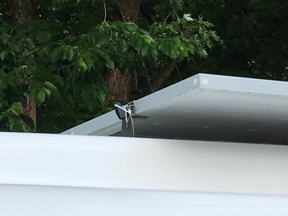

John E Davies Posted July 14, 2017 Author Posted July 14, 2017 Here's a pic from the ground, showing a tie: John Davies Spokane WA 1 1 SOLD 07/23 "Mouse": 2017 Legacy Elite II Two Beds, Hull Number 218, See my HOW TO threads: Tow Vehicle: 2013 Land Cruiser 200, 32” LT tires, airbags, Safari snorkel, Maggiolina Grand Tour 360 Carbon RTT.

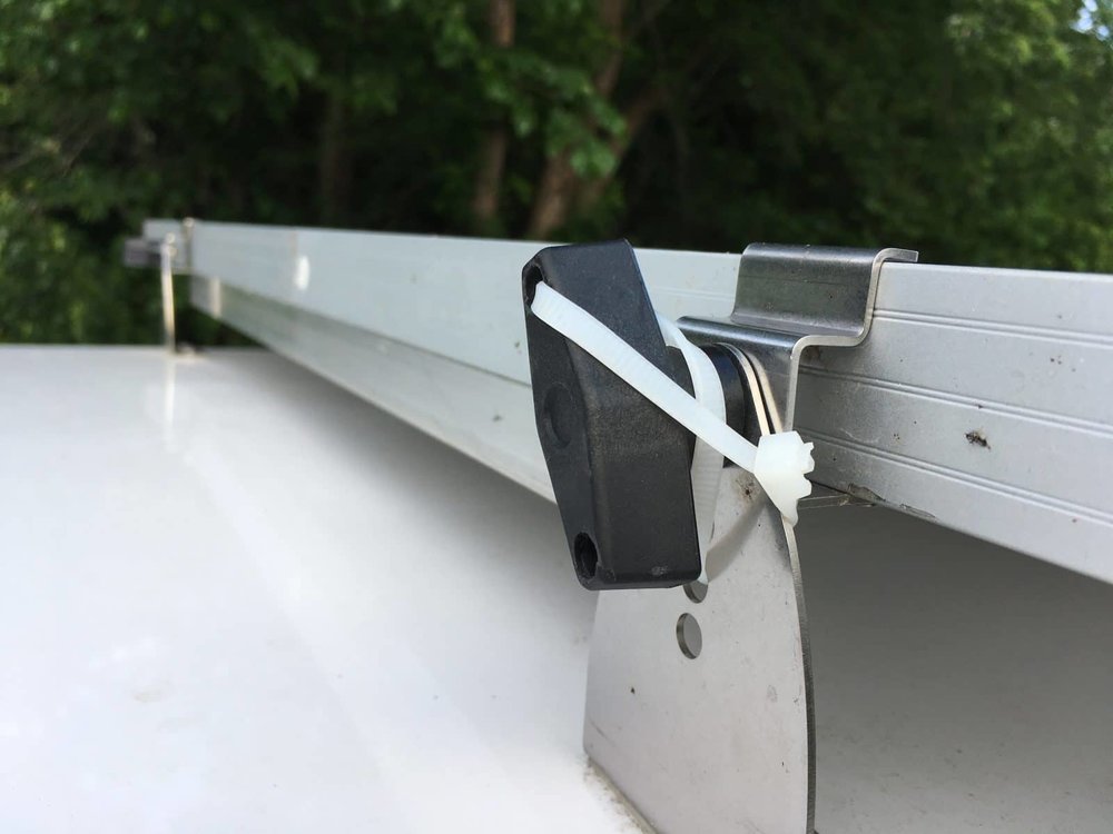

skalywag Posted July 15, 2017 Posted July 15, 2017 Good Catch John, Most of ours were slightly loose to loose. I thought about using a lock nut behind the attachment flange but there is no room for a wrench in that space. So I used the nylon safeties after drilling the handles. I drilled one 1/4" hole thru the flat end and fed the safeties thru the bracket , then thru the handle hole and secured it. I was able to tighten each of the 4 knobs to the vertical orientation a seen. It should keep it from rotating, but I will continue to check them. While I was up there, I noticed that, at the junction box, there is a spare input receiver with a cap on it. Can this be used for an "add on"? Cheers, Terry 4 Legacy Elite I #240

T-Oliver Posted July 16, 2017 Posted July 16, 2017 You might find this product useful, not as much fun as safety wire or tie wraps Vibra-tite VC-3 threadmate Adjustable and reuseable 2 2

Hokieman Posted August 29, 2022 Posted August 29, 2022 See this Facebook post from May 2021 for supporting evidence for this mod. If you haven’t already done so, please check and modify the mounting knobs on your solar panels. Having a panel fly off at speed could not only be expensive, it could be a major liability if any following vehicles sustain damage or injuries. 2 3 “Ramble” - 2021 Legacy Elite II #797; 2020 Ford F-250
Jim and Chris Neuman Posted August 30, 2022 Posted August 30, 2022 I have been using zip ties for years on my sailboat. They are a fine way to make a light fastening but do have the drawback of degrading in sunlight to the point where, after a season or two, their resistance to abrasion and breaking is seriously compromized. Replacing these plastic ties would be on my annual to-do list. I have looked for UV restant zip ties but no luck so far ... would like very much if someone here could post a source. In this application stainless or monel seizing wire would be a superior option. 4
