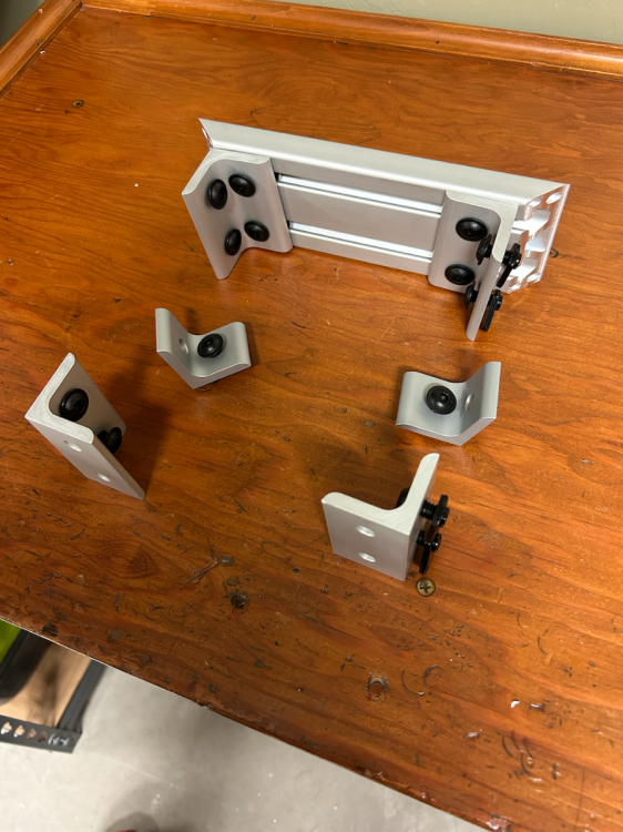

Lagun Table Project Update:  Moved the table mount from night stand to street side bed rail using @Overland's detailed instructions:
Been wanting to finish this up since building the Lagun Table top last spring!!!

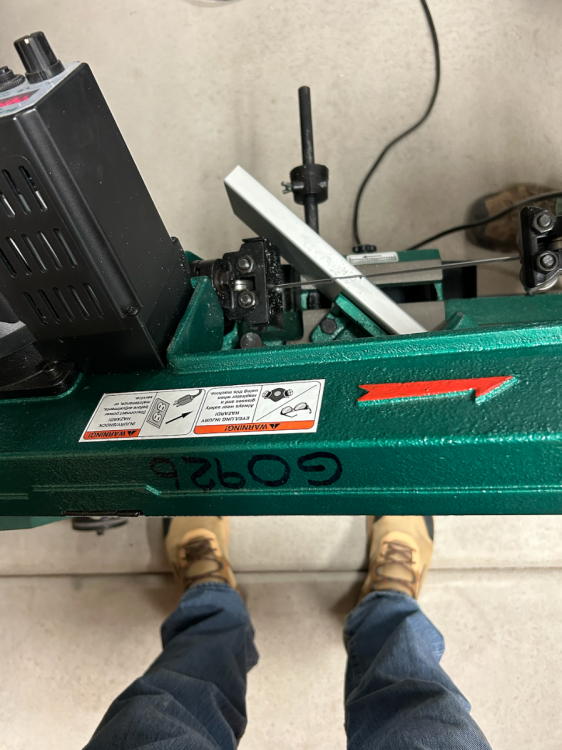

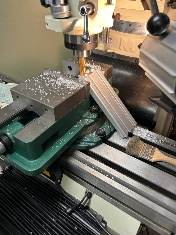

Used a bandsaw to rough cut the four 45-degree ends - then finished them with an end cut bit on the mill:

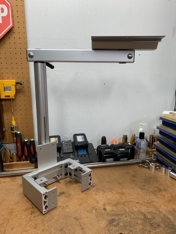

Assembled finished parts and checked fitment on PORT side bed rail:

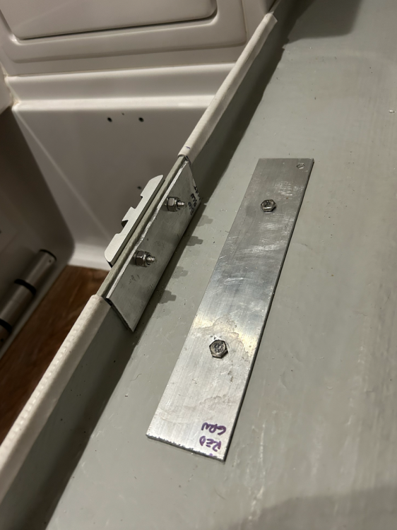

Used three 1/8" aluminum backing plates behind each of the mounting points:
View from underneath:

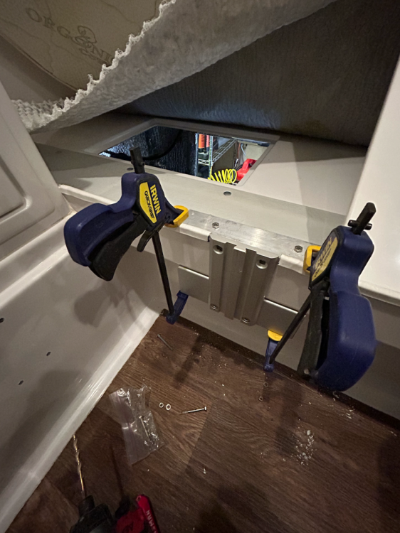

Completed new mounting area:
Now we've got nightstand drawer access with table in place - whereas before, the mount was just below the drawer making it impossible to gain access to the drawer with the table mounted there:
