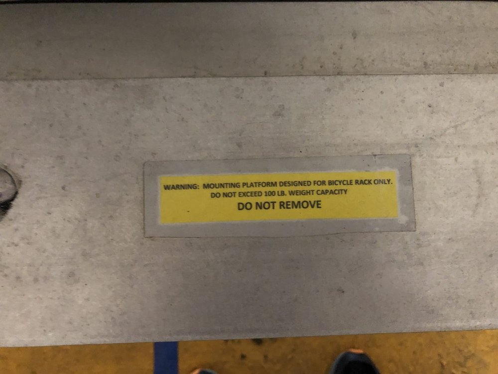

Jitters Posted July 29, 2019 Share Posted July 29, 2019 Good morning. Does anyone know the weight limits for this setup? Trying to figure if it is safe for a 1-UP bike rack with around 80lbs of bikes. Thanks Greg Greg USN Retired ARS AB7R Link to comment Share on other sites More sharing options...
John E Davies Posted July 29, 2019 Share Posted July 29, 2019 I believe Oliver recommends 100 pounds max load on the recommended Lets Go Aero BikeWing 1.25" rack (which you can find that weight online).... if I am interpreting their data right. ... https://olivertraveltrailers.com/topic/new-bike-hitch-capacity/ A call to Howenwald would clarify. I personally find the idea of hanging floppy cargo off that very small receiver MORE than a little disconcerting. The back end of your Ollie is a pretty violent location when you hit a big bridge dip at 65 mph. I double strap everything in my rear rack so I don't lose cans and chocks en route. John Davies Spokane WA 5 SOLD 07/23 "Mouse": 2017 Legacy Elite II Two Beds, Hull Number 218, See my HOW TO threads: Tow Vehicle: 2013 Land Cruiser 200, 32” LT tires, airbags, Safari snorkel, Maggiolina Grand Tour 360 Carbon RTT. Link to comment Share on other sites More sharing options...

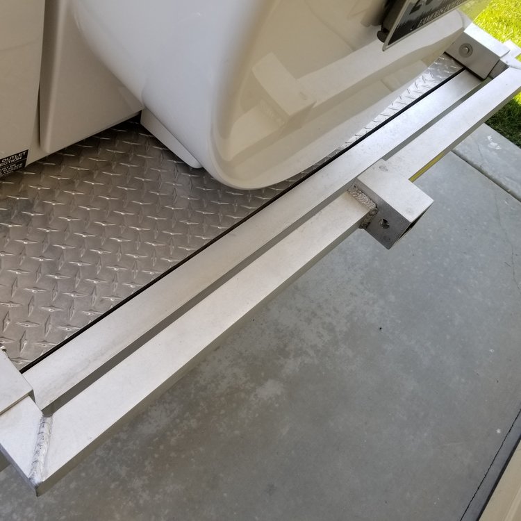

Jitters Posted July 29, 2019 Author Share Posted July 29, 2019 Thanks. This is for a 2" hitch, not 1 1/4. Should make a little difference. But now their cross piece looks to be twice as wide and the receiver part is clamped vice welded. Greg USN Retired ARS AB7R Link to comment Share on other sites More sharing options...
DavidS Posted July 29, 2019 Share Posted July 29, 2019 I have the Oliver Rear Bumper Bike Rack holder with the 2-inch receiver. They put a sticker on there stating a 100 lb weight limit. 2 1 David Stillman, Salt Lake City, Utah 2016 Oliver Elite II Hull 164 | 2017 Audi Q7 tow vehicle. Travel and Photography Blog: http://davidstravels.net Link to comment Share on other sites More sharing options...

Pat Maundrell Posted March 14, 2021 Share Posted March 14, 2021 I've heard both 100 Lbs and 150 Lbs, (never in print) this is the first time I've actually seen a Sticker indicating 100lbs! It critical to consider any additional weight placed on the Rear End of a trailer and how it affects the overall handling of the TV & Trailer combination. To much weight can upset the stability of the Tow Combination and can induce TRAILER SWAY! On the other hand staying within the recommended limits can have a positive effect on the Tongue Weight. 2 Link to comment Share on other sites More sharing options...

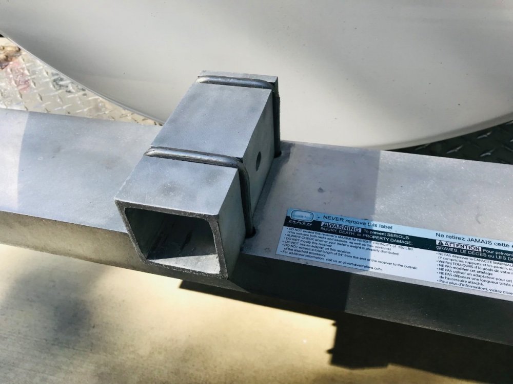

Jairon Posted March 14, 2021 Share Posted March 14, 2021 I heard it was previously 100 pounds but recently updated to 150 Lbs. If 150 Lbs is true, I don't know if it only applies to the new rack design. Please let us know if you contact Oliver. 1 2019 Toyota Land Cruiser 2021 Oliver Elite II, Hull #748 Link to comment Share on other sites More sharing options...
dewdev Posted March 14, 2021 Share Posted March 14, 2021 I just purchase the (current) receiver from Oliver and installed it myself. It is the same receiver that you can see on Oliver's web site pictures. They sent me a sticker with the 150 lbs limit. The receiver is a 1-1/4" unit. 1 4 2018 Oliver Elite II, Twin Bed, Hull #354 2024 RAM 1500, 4 x 4; Gas. 5.7L V8 Hemi MDS VVT Torque; 3.21 rear axle ratio Maine Link to comment Share on other sites More sharing options...

Patriot Posted September 24, 2021 Share Posted September 24, 2021 Here is the 150# load rating sticker for our 2020 OLEll. I had the 1.25” core removed by a local machine shop for $30. Our bikes and the 1 Up Super Duty rack won’t come close to the load rating. 2 2020 OLEII - Hull #634 aka- “XPLOR” 2021 F350 6.7 liter Diesel Lariat Ultimate Tremor Link to comment Share on other sites More sharing options...
John E Davies Posted September 24, 2021 Share Posted September 24, 2021 32 minutes ago, Patriot said: I had the 1.25” core removed by a local machine shop How long have you used it this way? Any sign of cracks around the corners? 1/4” of aluminum is too thin to support that load for a long period of time. That is one reason Oliver engineers doubled up the thickness (they really do understand aluminum structural properties). 1 Up uses a very cool anti-rattle design but it is meant for steel, and it applies a very heavy point load at just one location.. Have they commented about its suitability for use in a much softer material? As an ex-A&P technician that mod really worries me. I think you risk having the rack and bikes drop down onto the road, or worse yet, come off completely, causing an accident. At the very least you should install a stout cable lock through the bike frames, rack AND around the bumper.I am not trying to sound hysterical, I truly think that is unsafe. John Davies Spokane wA 5 SOLD 07/23 "Mouse": 2017 Legacy Elite II Two Beds, Hull Number 218, See my HOW TO threads: Tow Vehicle: 2013 Land Cruiser 200, 32” LT tires, airbags, Safari snorkel, Maggiolina Grand Tour 360 Carbon RTT. Link to comment Share on other sites More sharing options...
Patriot Posted September 24, 2021 Share Posted September 24, 2021 6 hours ago, John E Davies said: How long have you used it this way? Any sign of cracks around the corners? 1/4” of aluminum is too thin to support that load for a long period of time. That is one reason Oliver engineers doubled up the thickness (they really do understand aluminum structural properties). 1 Up uses a very cool anti-rattle design but it is meant for steel, and it applies a very heavy point load at just one location.. Have they commented about its suitability for use in a much softer material? As an ex-A&P technician that mod really worries me. I think you risk having the rack and bikes drop down onto the road, or worse yet, come off completely, causing an accident. At the very least you should install a stout cable lock through the bike frames, rack AND around the bumper.I am not trying to sound hysterical, I truly think that is unsafe. John Davies Spokane wA I have done a fair amount of research prior to pursuing this mod/application with a local aluminum engineer, aluminum tech and actually spoke at length with Oliver Service and 1Up USA. I have also communicated recently with another OLEll owner who has several thousand miles on this same identical mod and bike rack with zero structural integrity issues with the rack or receiver. Based on these conversations I am not concerned about the structural safety of this mod. My 1Up USA Super Duty bike rack (engineered for a TT) just shipped from the factory. I look forward to the install sometime next week. *My understanding is one of the big reasons Oliver inserted the 1.25” reducer is owners were overloading the aluminum receiver and exceeding the engineered rack weight limit which will naturally could result in a catastrophic failure. Cheers! 5 2020 OLEII - Hull #634 aka- “XPLOR” 2021 F350 6.7 liter Diesel Lariat Ultimate Tremor Link to comment Share on other sites More sharing options...
Overland Posted September 24, 2021 Share Posted September 24, 2021 I think I agree with that. Structurally, the aluminum sleeve can be thought of as a shim to hold the rack snug to the steel U-bolts, which are what's truly holding the rack. That is, I think the only stress on the sleeve is compression, not shear or torque. The anti-rattle bearing on the 1-up is certainly a stress point, but I think you could solve that by lining up the bearing with the forward U-bolt. From the photos, it looks like that would be possible. I do wonder how thin the aluminum is where it's been routed to accept the U-bolts. I think a failure there could allow the sleeve to work it's way out. But it would have to fail at both bolts for that to happen, which is probably unlikely on a single drive. Worth inspecting every so often I'd imagine, but I don't see a failure as being catastrophic - you'd have time to notice. 6 Link to comment Share on other sites More sharing options...
John E Davies Posted September 25, 2021 Share Posted September 25, 2021 While I won’t change my feelings about that mod, please keep everybody informed in the long term, if it works out, that would be great. My concern is the up and down torque loads, they can be tremendous, for example hitting the two whoopdedoos of a poorly graded Interstate highway bridge at 70 mph. That bottoms out the trailer suspension and transfers most of that energy to the frame and rack. It happens as you hit the bridge, and then again as you depart it. Most unnerving! I hope you have a rear camera that can be adjusted low enough to see the bikes, you can modify the power wires to operate it when driving forward. Good luck. John Davies Spokane WA 4 SOLD 07/23 "Mouse": 2017 Legacy Elite II Two Beds, Hull Number 218, See my HOW TO threads: Tow Vehicle: 2013 Land Cruiser 200, 32” LT tires, airbags, Safari snorkel, Maggiolina Grand Tour 360 Carbon RTT. Link to comment Share on other sites More sharing options...
