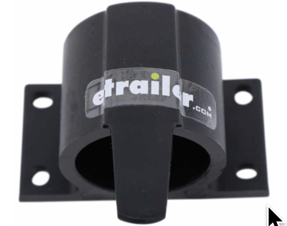

Galway Girl Posted September 10, 2019 Posted September 10, 2019 see Updates below Update: some have reported back that the holder now shipping doesn’t fit the new 7pin plugs Oliver now uses. The plugs a MM bigger than the holder. An alternative is to tuck your 7 pin up under the fiberglass cowling on the tongue. The 7 pin fits snugly there out of the rain for storage. This afternoon my wife said.... "I noticed the tail lights of the trailer on this morning. It's not hooked to the truck. Are they supposed to be on?" When I went out to look and sure enough the rear tail lights were on. I went immediately to look first at the "emergency brake" switch and then at the front 7 pin connector...which has a "rubber cover" on it to keep water out. We had 2" of rain in the past day and that rubber 7pin cover did a much better job of keeping the water in. I drained the connector, blew it out and dried it with air. Then cleaned it and lubricated it with electrical silicone grease. The lights are no longer on. I'm assuming this was a draw from the house batteries through that connector. Passing along if of any use to folks in the future. If there's a similar post somewhere I didn't find it in a quick search. Craig Short 3 2019 Elite II (Hull 505 - Galway Girl - August 7, 2019 Delivery) Tow Vehicle: 2021 F350 King Ranch, FX4, MaxTow Package, 10 Speed, 3.55 Rear Axle Batteries Upgrade: Dual 315GTX Lithionics Lithiums - 630AH Total Inverter/Charger: Xantrex 2000Pro Travel BLOG: https://4-ever-hitched.com

Galway Girl Posted September 16, 2019 Author Posted September 16, 2019 I've done a modification to add an Optronics 7-Way trailer harness plug protector. Here's the link to the part I used from e-trailer.(Including shipping and tax < $10 https://www.etrailer.com/Trailer-Plug-Covers/Optronics/ACP7B.html And here's where I mounted it...on the back of my Tongue Box. I used stainless #10 bolts to mount the unit. It could be mounted with zip ties to the bottom of the tongue as well if you don't want to drill holes. The cover is a semi rigid type of rubber material but with enough flex to make it easy to insert or remove with one hand. In any case, I switched to this after my original "rubber cover" leaked. 4 2019 Elite II (Hull 505 - Galway Girl - August 7, 2019 Delivery) Tow Vehicle: 2021 F350 King Ranch, FX4, MaxTow Package, 10 Speed, 3.55 Rear Axle Batteries Upgrade: Dual 315GTX Lithionics Lithiums - 630AH Total Inverter/Charger: Xantrex 2000Pro Travel BLOG: https://4-ever-hitched.com

Rivernerd Posted January 25, 2023 Posted January 25, 2023 On 9/16/2019 at 10:20 AM, Galway Girl said: I've done a modification to add an Optronics 7-Way trailer harness plug protector. I bought an Optronics 7-way trailer harness plug for our new Elite II. But, the opening is too small for the 7-way female plug Oliver installed on our Hull #1291. I had to increase the inside diameter of the plug protector by about 1mm, using a small drum sander chucked into a Mototool, to enable the factory 7-way plug to fit into the inside the plug protector. So, be prepared to modify the Optronics plug protector for use with an Oliver. 1 Hull #1291 Central Idaho 2022 Elite II Tow Vehicle: 2019 Tundra Double Cab 4x4, 5.7L with tow package

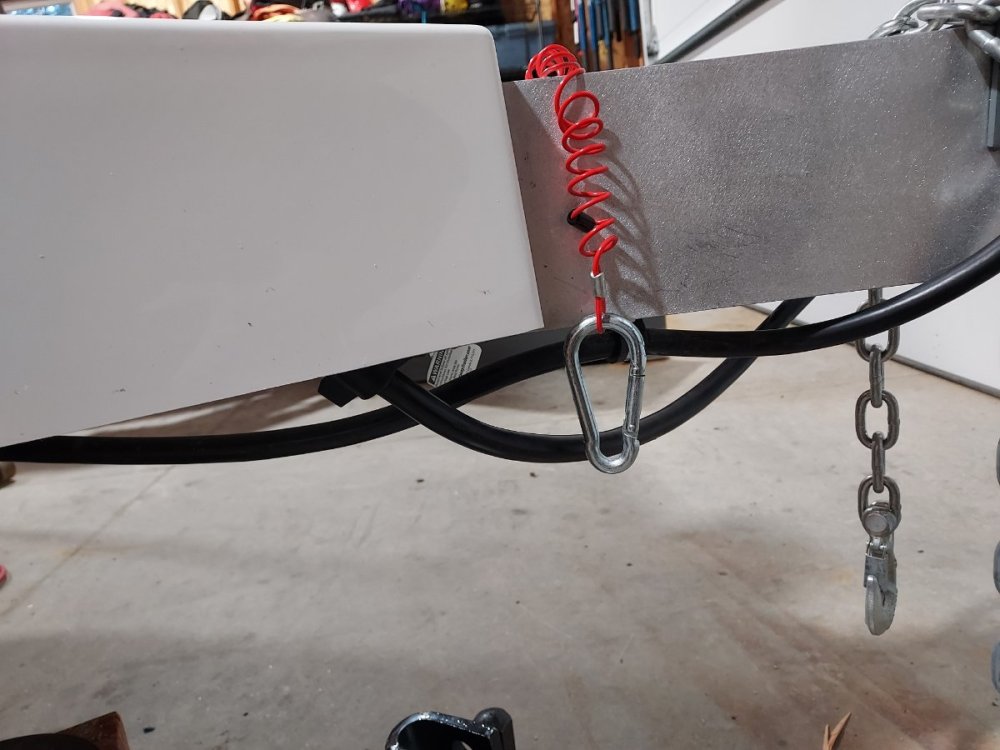

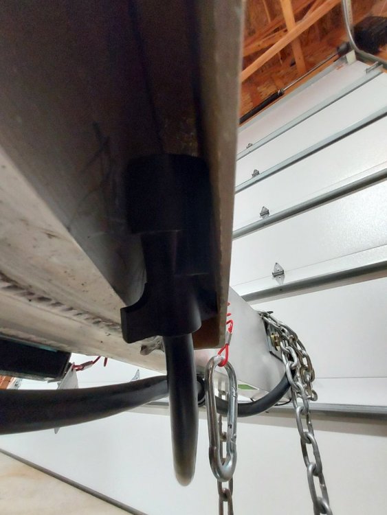

dewdev Posted January 25, 2023 Posted January 25, 2023 The previous owner of my Ollie showed me the following storage procedure after he had a problem with the Ollie lights being on: Costs nothing. If you look at where the Oliver fiberglass hull is near the trailer's tongue, you will see there is a gap between the fiberglass and the trailer frame. This gap is big enough for the trailer plugs to fit up into and out of the weather. I have never had a problem with moisture or rain water storing it this way. 2 3 1 2018 Oliver Elite II, Twin Bed, Hull #354 2024 RAM 1500, 4 x 4; Gas. 5.7L V8 Hemi MDS VVT Torque; 3.21 rear axle ratio w/TIMBREN spring rear suspension addition Maine
Rivernerd Posted January 25, 2023 Posted January 25, 2023 12 minutes ago, dewdev said: If you look at where the Oliver fiberglass hull is near the trailer's tongue, you will see there is a gap between the fiberglass and the trailer frame. This gap is big enough for the trailer plugs to fit up into and out of the weather. I have never had a problem with moisture or rain water storing it this way. Great tip! I wish I had thought of that clever trick before I spent $10 on an Optronics plug protector, and an hour+ modifying and mounting it! 1 Hull #1291 Central Idaho 2022 Elite II Tow Vehicle: 2019 Tundra Double Cab 4x4, 5.7L with tow package
Galway Girl Posted February 1, 2023 Author Posted February 1, 2023 Rivernerd: I posted an update based on your feedback. What a pain. I wonder if the connector changed at the factory or if the holder inside dimensions changed. 1 2019 Elite II (Hull 505 - Galway Girl - August 7, 2019 Delivery) Tow Vehicle: 2021 F350 King Ranch, FX4, MaxTow Package, 10 Speed, 3.55 Rear Axle Batteries Upgrade: Dual 315GTX Lithionics Lithiums - 630AH Total Inverter/Charger: Xantrex 2000Pro Travel BLOG: https://4-ever-hitched.com

Geronimo John Posted February 2, 2023 Posted February 2, 2023 On 1/25/2023 at 11:17 AM, dewdev said: The previous owner of my Ollie showed me the following storage procedure after he had a problem with the Ollie lights being on: Costs nothing. For us locationally impaired, would you be so kind as to post a picture of your wonderful approach? Mahalo GJ TV: 2019 F-150 SuperCrew Lariat, 3.5L EcoBoost, 10 Speed Trans, Max Tow, FX-4, Rear Locker OLLIE: 2018 OE2 Hull 342, Twin Bed. OLLIE DIY’s: Timken Bearings, BB LiFePO4's, Victron 712 Smart, 350 Amp Master Switch, Houghton 3400, Victron Orion DC - DC, 3000-Watt Renogy Inverter, P.D. 60-amp Converter, Frig Dual Exhaust Fans, Kitchen Drawer Straps. Front Wardrobe Shelves, Snuggle Shelf. TV DIY’s: 2 5/16" Anderson System, Nitto recon’s, Firestone Rear Air Bags, Bilstein 5100’s, Mud Flaps & Weather Tech all, installed Ham Radio (WH6JPR).
Rivernerd Posted February 3, 2023 Posted February 3, 2023 2 hours ago, Geronimo John said: For us locationally impaired, would you be so kind as to post a picture of your wonderful approach? See attached photos. The first was shot from the side of the trailer A-frame. The second was shot from underneath. 2 1 Hull #1291 Central Idaho 2022 Elite II Tow Vehicle: 2019 Tundra Double Cab 4x4, 5.7L with tow package
Geronimo John Posted February 3, 2023 Posted February 3, 2023 That's amazing! I shall implement your suggestion. Thanks GJ TV: 2019 F-150 SuperCrew Lariat, 3.5L EcoBoost, 10 Speed Trans, Max Tow, FX-4, Rear Locker OLLIE: 2018 OE2 Hull 342, Twin Bed. OLLIE DIY’s: Timken Bearings, BB LiFePO4's, Victron 712 Smart, 350 Amp Master Switch, Houghton 3400, Victron Orion DC - DC, 3000-Watt Renogy Inverter, P.D. 60-amp Converter, Frig Dual Exhaust Fans, Kitchen Drawer Straps. Front Wardrobe Shelves, Snuggle Shelf. TV DIY’s: 2 5/16" Anderson System, Nitto recon’s, Firestone Rear Air Bags, Bilstein 5100’s, Mud Flaps & Weather Tech all, installed Ham Radio (WH6JPR).
Rivernerd Posted February 3, 2023 Posted February 3, 2023 15 minutes ago, Geronimo John said: That's amazing! I shall implement your suggestion. Thanks GJ dewdev gets the credit for the suggestion. I just shot the photos! 2 Hull #1291 Central Idaho 2022 Elite II Tow Vehicle: 2019 Tundra Double Cab 4x4, 5.7L with tow package
dewdev Posted February 3, 2023 Posted February 3, 2023 Rvernerd: Thanks for posting the pictures. Your pictures are exactly how I do it. When first using the Ollie In 2018, the moisture problem (rear lights on) appeared. Tried a holder bracket mounted to the front storage bin but that was not the best approach. Have not had a problems since implementing the mentioned storage location. If the cord is not plugged into the TV it is stored in this location 100% of the time. 1 2018 Oliver Elite II, Twin Bed, Hull #354 2024 RAM 1500, 4 x 4; Gas. 5.7L V8 Hemi MDS VVT Torque; 3.21 rear axle ratio w/TIMBREN spring rear suspension addition Maine
