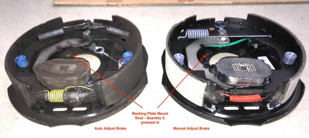

BackofBeyond Posted December 20, 2019 Posted December 20, 2019 (edited) I thought a separate spot for feedback on the latest Dexter axle bulletin would be a good spot for folks to relay their findings, concerns, and such. So this morning I crawled under Ollie to check the 16 fasteners referenced in the bulletin, I found all the lower bolts loose, about 1/2 to 3/4 turn "loose" and the top ones were mostly secure, one or to were just slightly - maybe a 1/4 turn. No I didn't use a torque wrench, as next month I am planning to do a wheel bearing repack and I'll put the measurement on them then, a proper triple check. FYI - Ollie #359 RB Edited December 20, 2019 by BackofBeyond 1 Cindy, Russell and "Harley dog" . Home is our little farm near Winchester TN 2018 Oliver Legacy Elite II - 2018 GMC 2500 Duramax "Die young - As late as possible"
John E Davies Posted December 20, 2019 Posted December 20, 2019 (edited) I replaced my front brakes only last year and the four NUTS were fine. I did not check the rears, I will do so this winter when I do a bearing repack. For anyone who has had their brakes replaced by a shop, this bulletin should not apply since the brake backing plates are held on with this hardware. Normally the entire units are swapped, not rebuilt. But it would not hurt to check all 16 anyway! The four nuts secure each plate, which has four pressed-in STUDS which are probably splined near the head, as are the suspension shackle bolts. Those studs should never, ever rotate! If they do the backing plate or assembly should be replaced IMHO. And brakes must always be replaced in pairs (on the same axle) so that stability during operation will not be affected. I don't know what Dexter says about this, they may be OK with simply driving out a loose stud and putting another in there. I personally would not trust it to remain tight. John Davies Spokane WA Edited December 20, 2019 by John E Davies 1 SOLD 07/23 "Mouse": 2017 Legacy Elite II Two Beds, Hull Number 218, See my HOW TO threads: Tow Vehicle: 2013 Land Cruiser 200, 32” LT tires, airbags, Safari snorkel, Maggiolina Grand Tour 360 Carbon RTT.

John E Davies Posted December 22, 2019 Posted December 22, 2019 (edited) I think the problem is not so much that parts will fall off, more that the brake will start to act weird, binding and locking up possibly. I would like to see more official information about “secondary steps” beyond notifying Dexter for help.... If I find a nut loose and I tighten it, do I call it a day? Two nuts? Three? What if they are really falling-off-loose but I can torque them down satisfactorily? At what point does this become a real concern? What happens next if I find a nut that will not tighten, indicating a stud that is turning? Is it required that an RV tech do this recall? If a problem is found by an OWNER, will that affect Dexters response in any way? It would be good to know where the limits are. If a significant number of nuts are found loose I would want to pull the drum/ hub off completely to clean and inspect the backing plate for trauma - cracks or bending. (These parts can be subject to very violent torque effects, especially if you slam on the brakes at freeway speeds.) For those who want to have this done buy a shop, you could have a traveling tech come by your place of storage to perform the recall. Cost will be about the same as for an RV dealer but the hassle is way less, especially in winter. Google “mobile Rv service”. I used one last year to do the Inverter Service Bulletin and was very pleased. John Davies Spokane WA Edited December 22, 2019 by John E Davies 2 SOLD 07/23 "Mouse": 2017 Legacy Elite II Two Beds, Hull Number 218, See my HOW TO threads: Tow Vehicle: 2013 Land Cruiser 200, 32” LT tires, airbags, Safari snorkel, Maggiolina Grand Tour 360 Carbon RTT.
John E Davies Posted December 22, 2019 Posted December 22, 2019 On 12/20/2019 at 2:57 PM, Townesw said: I don’t think a torque setting between 45-70 lb-ft applied with a torque wrench using a universal joint as shown in this photo actually transfers the set amount of torque to the fastener. From what I have read it is much lower and can vary greatly depending on how the torque wrench is supported and the angle of the universal joint. If the angle is under 15 degrees the error can be ignored. For larger angles the torque will be less. No worries in this situation..... John Davies Spokane WA 1 SOLD 07/23 "Mouse": 2017 Legacy Elite II Two Beds, Hull Number 218, See my HOW TO threads: Tow Vehicle: 2013 Land Cruiser 200, 32” LT tires, airbags, Safari snorkel, Maggiolina Grand Tour 360 Carbon RTT.
