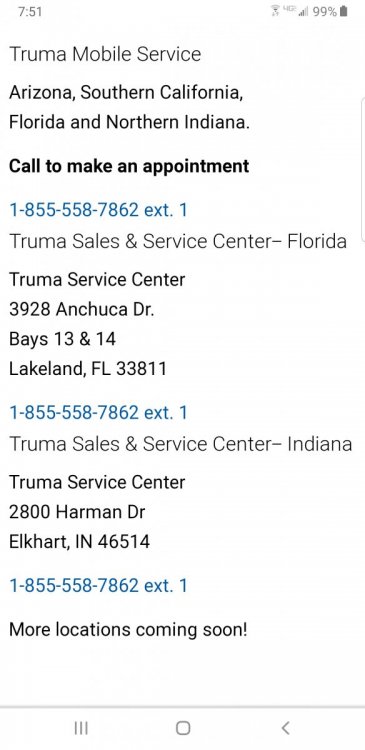

Moderators SeaDawg Posted January 30, 2020 Moderators Share Posted January 30, 2020 (edited) For those of you in Florida, or traveling through, Truma opened a corporate sales and service office in Lakeland, just a few minutes off of I-4. (That's about halfway between Tampa and Orlando.) I spoke to the manager there a few months ago when I was looking into their new furnace. Sherry Edited January 30, 2020 by SeaDawg 2 2008 Ram 1500 4 × 4 2008 Oliver Elite, Hull #12 Florida and Western North Carolina, or wherever the truck goes.... 400 watts solar. DC compressor fridge. No inverter. 2 x 105 ah agm batteries . Life is good. Link to comment Share on other sites More sharing options...

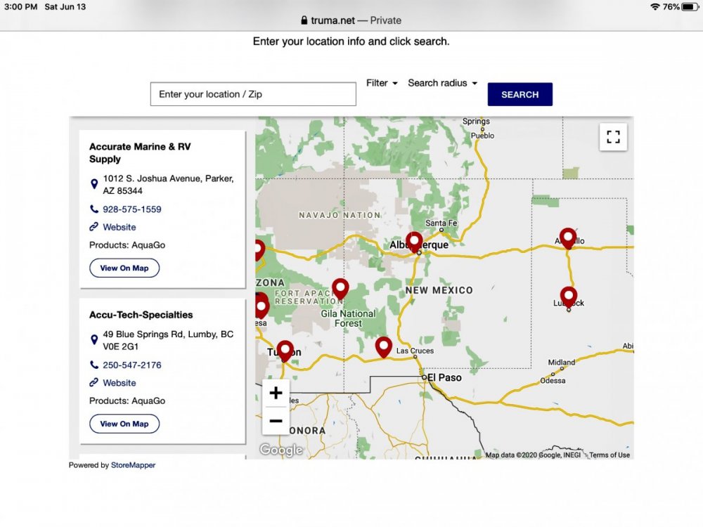

wlonghurst Posted June 13, 2020 Share Posted June 13, 2020 We have the Truma. It has not worked from the first night of camping at David Crockett State Park. We should have gone back to Oliver the next day but headed for home (New Mexico) thinking that we just had not been properly operating it. Now it is June and still not working. Oliver washed their hands of it saying that we had to go through Truma even though it was a faulty unit right from the start. Truma is mostly shut down because of the corona virus. I suspect it will be several more months of camping until it can be replaced. We would not have opted for a Truma (Trauma) if we had known about the troubles we have had. Link to comment Share on other sites More sharing options...
Moderators mossemi Posted June 13, 2020 Moderators Share Posted June 13, 2020 Have you tried any of the Truma service partners in your area? Would you care to share any details about what is not working? Mossey Mike and Krunch Lutz, FL 2017 LEII #193 “the dog house” Link to comment Share on other sites More sharing options...
Moderators Mike and Carol Posted June 13, 2020 Moderators Share Posted June 13, 2020 1 hour ago, wlonghurst said: Oliver washed their hands of it saying that we had to go through Truma even though it was a faulty unit right from the start. I don’t know what Oliver could do unless you drove back to Hohenwald. If it is a defective unit I would check out one of the Truma service centers in your area, as Mike suggested. It could be something simple but even if the entire unit needs to be replaced it should be under manufacture warranty. Texas Hill Country | 2016 Elite II #135 | 2020 Ram 2500 6.7L Link to comment Share on other sites More sharing options...
Moderators SeaDawg Posted June 13, 2020 Moderators Share Posted June 13, 2020 Take heart, though. Even though you didn't go back to Hohenwald, I'm sure Truma stands behind its product, like most of the notable TV accessory and appliance manufacturers. Most local businesses here have extended returns, and warranties, if they were unable to respond due to the covid 19 shutdowns. I'd advise you to continue to communicate with Truma. Were it me, I'd use email, so that I had a paper(less) trail. I'm assuming you are still under Truma warranty? Sherry 2008 Ram 1500 4 × 4 2008 Oliver Elite, Hull #12 Florida and Western North Carolina, or wherever the truck goes.... 400 watts solar. DC compressor fridge. No inverter. 2 x 105 ah agm batteries . Life is good. Link to comment Share on other sites More sharing options...

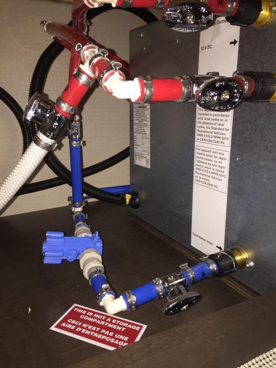

Overland Posted July 25, 2020 Share Posted July 25, 2020 (edited) On 1/28/2020 at 9:57 PM, Overland said: I would say that overall we’re happy with the Truma, with the caveat being that it has definitely been the most finicky and delicate component on the trailer. I can’t say whether I’d opt for it again if I were doing it all over. Probably...not? I need to amend this comment slightly. One of the finicky things that we've had problems with on the Truma is getting consistent hot water out of it. Sometimes it's hot, sometimes warm, sometimes frigid, and often during a shower you get all three. Not great. Well, as part of my plumbing renovations, I'm thinking about swapping out all of the plastic pex fittings with brass, and while I was counting fittings this afternoon, I was staring at the connections at the Truma and just had to laugh when the mistake that's causing my problems was suddenly obvious. On my unit there are three connections: cold water goes in the bottom, hot water out the top, and the circulation return is in the middle. Let's see if you guys can spot it, too (the blue pex you're looking at is the winterization bypass). 🙄 😂 I can't be too hard on Oliver for this one, since mine was the first unit with the circulator that they installed. But I was told that there's one other Ollie out there with the same unit, that was on the line next to mine - so I'm sure it has the same problem. Edited July 25, 2020 by Overland 1 Link to comment Share on other sites More sharing options...

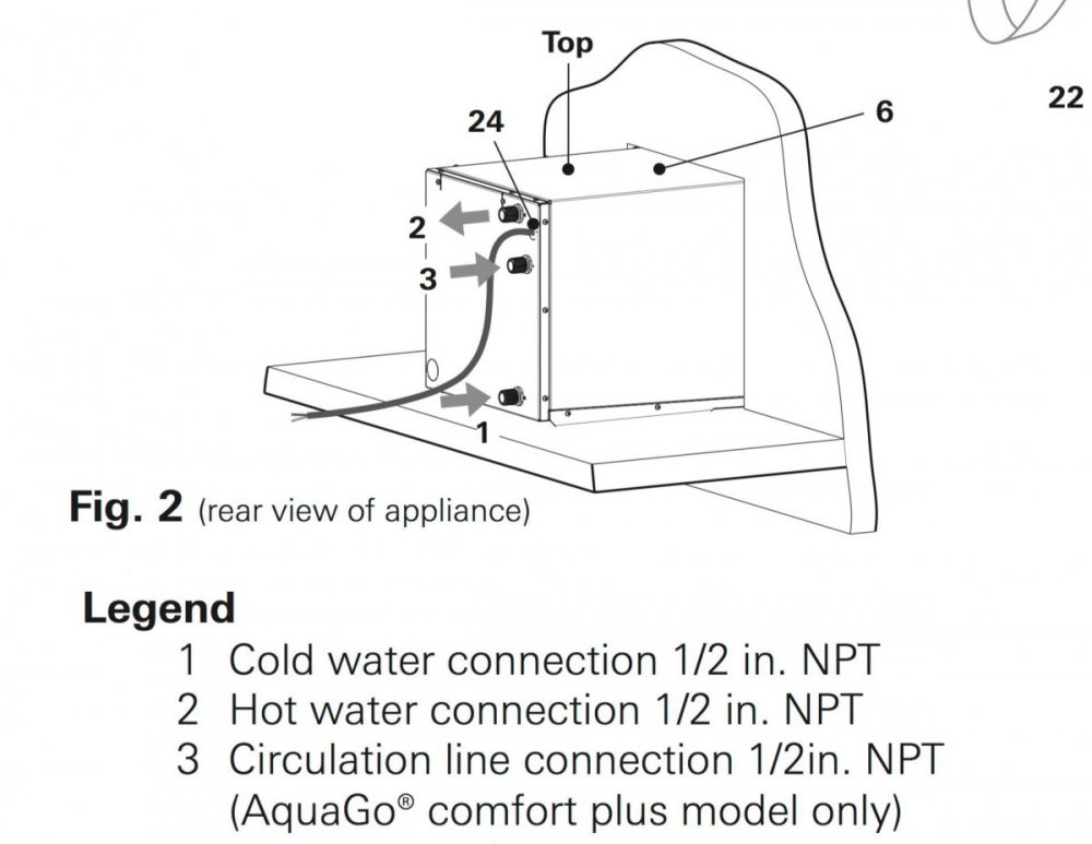

bhncb Posted July 26, 2020 Share Posted July 26, 2020 In spite of how it's drawn in the Truma connection diagram, the return line should not be connected to the bypass circuit. 1 Link to comment Share on other sites More sharing options...
Overland Posted July 26, 2020 Share Posted July 26, 2020 (edited) Yeah, the Truma diagram is a bit confusing. They draw the bypass in a different shade of grey to show that it doesn’t intersect the return; but printed or at a distance, it’s easy to assume that it does. Of course, logic tells you that it shouldn’t. The way it’s connected, the bypass creates a short circuit in the circulation line. Edited July 26, 2020 by Overland Link to comment Share on other sites More sharing options...
Ray and Susan Huff Posted July 26, 2020 Share Posted July 26, 2020 (edited) On 7/25/2020 at 3:39 PM, Overland said: I need to amend this comment slightly. One of the finicky things that we've had problems with on the Truma is getting consistent hot water out of it. Sometimes it's hot, sometimes warm, sometimes frigid, and often during a shower you get all three. Not great. Well, as part of my plumbing renovations, I'm thinking about swapping out all of the plastic pex fittings with brass, and while I was counting fittings this afternoon, I was staring at the connections at the Truma and just had to laugh when the mistake that's causing my problems was suddenly obvious. On my unit there are three connections: cold water goes in the bottom, hot water out the top, and the circulation return is in the middle. Let's see if you guys can spot it, too (the blue pex you're looking at is the winterization bypass). 🙄 😂 I can't be too hard on Oliver for this one, since mine was the first unit with the circulator that they installed. But I was told that there's one other Ollie out there with the same unit, that was on the line next to mine - so I'm sure it has the same problem. When you say yours is the first unit with the circulator, do you mean the Comfort Plus model that recirculates the water supply in the lines, as needed, so the water between the heater and the faucet is always hot? This is the model we have in our motor home. It makes more sense, from a water conservation standpoint, since you don't have to run a bit of cold water in order to get hot from the lines. This would be a more attractive option for us, but I still feel the "tried and true" standard heater scores more points. 1. We don't use the shower that often 2. Even with our Truma Comfort Plus, we only turn it on when we need hot water. I can live with having to turn on the tank heater a bit sooner. 3. Truma is a bit more "finicky", but easier to drain. That being said, I hesitate to get one because, in our area it is hard to find someone certified for warranty work (the nearest is 2 1/2 hrs away with only 5 in Oregon). 4. With the standard heater, you have the option of using LP or 120v power. Our installation is a bit easier to use bypass valves since it is mounted under the galley sink. When I can get to our RV, I'll post a picture of the Truma installation. Maybe it will make it easier to understand; it makes more sense to me. Edit: here are pictures of the Truma AquaGo Comfort Plus installation, located under the galley sink of our Leisure Travel Vans Unity Edited August 5, 2020 by Susan Huff additional info Ray and Susan Huff Elite II Twin "Pearl" - Hull#699; delivered December 7, 2020 2013 F350 6.7l diesel Super Duty 4x4 long bed crew cab 1UP-USA Heavy-duty bike rack 2017 Leisure Travel Van Unity Twin Bed (sold) Link to comment Share on other sites More sharing options...
bhncb Posted July 26, 2020 Share Posted July 26, 2020 12 hours ago, Overland said: Yeah, the Truma diagram is a bit confusing. They draw the bypass in a different shade of grey to show that it doesn’t intersect the return; but printed or at a distance, it’s easy to assume that it does. Of course, logic tells you that it shouldn’t. The way it’s connected, the bypass creates a short circuit in the circulation line. It's easy to see why an installer could make this mistake. The drawing should show either connection points or jumps. I'm sure you'll make this a lot cleaner. Seems to me you could replace three of those valves with one bypass and a check. Link to comment Share on other sites More sharing options...
