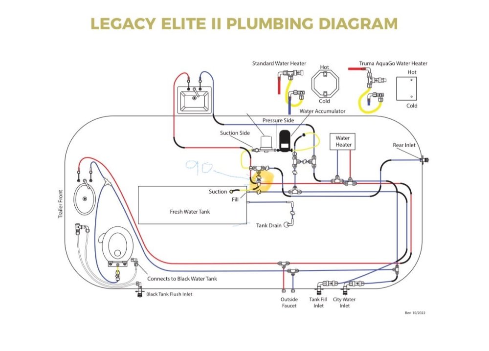

On 7/9/2022 at 3:14 PM, jordanv said:
Although I miscounted 1 “L” fitting and one “T” fitting so I have 2 more to do.
Hey Jordan, I know it’s been a while, but where did you miss the one 90° elbow. I only see one on the plumbing diagram?
**Sold😞**
Too long ago now for me to remember lol, sorry!
