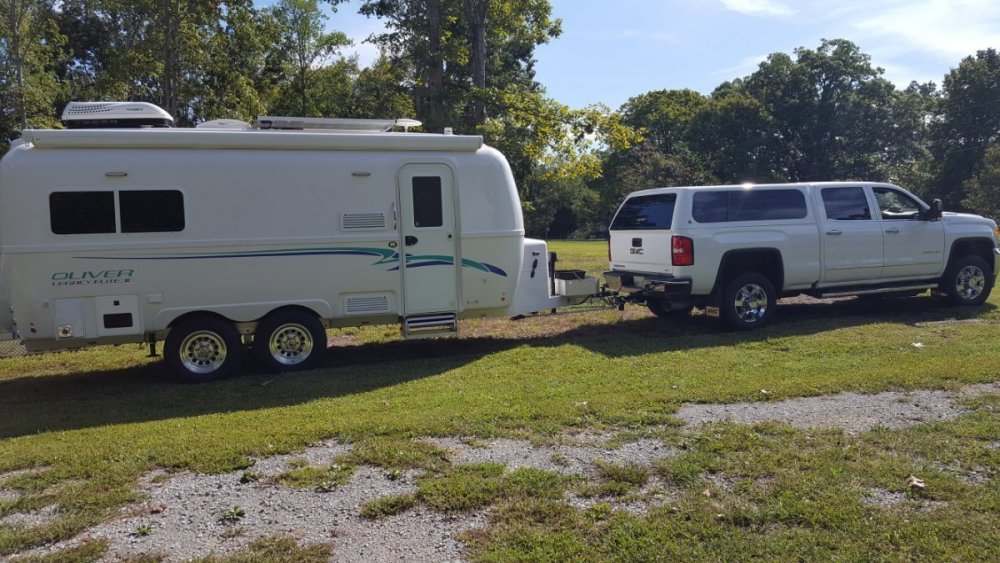

Moderator+ ScubaRx Posted September 17, 2021 Moderator+ Posted September 17, 2021 We ordered a new truck in the middle of June. We got it a little over a week ago. I replaced our 2017 Silverado 2500 HD with a Silverado 3500 HD. The reason for my decision was to increase the payload capacity of our tow vehicle. For those of you who know us personally, you've seen all that we carry. For those that we've not had the pleasure to yet meet, suffice it to say that the load is legendary. I'll never be accused of minimalism and when it comes to my stuff, like the American Express advertisements of old, I... "don't leave home without it..." The 2500 HD had a cargo capacity of 2110 pounds, But, upon taking into account the topper, front hitch, two tier bed slide, Dometic fridge, a rather large tool box, two adults, three dogs, hitch, tongue weight and THEN all the assorted accoutrements of camping, we found ourselves about 500-600 pounds overweight. The new truck has taken care of that deficit and them some. As far as the price went, being a 2022, we did not know what it would cost at the time we ordered it. I had gone online and "built" a 2021 to the same specs but in June, there was no provision to spec out a 2022. But, everything I read said not to expect the price to go up too much for the model year change. When the truck arrived it was essentially the same price as the previous year model. The salesman had told me not to expect any rebates and incentives as none of the different manufacturers were offering any. But the owner of the dealership in Memphis is a lifelong friend of my son-in-law and he gave me a good deal. With our trade in we got out the door for about twice what a new Ferrari 275 GTB would have cost you in 1965. Now "all" I've got to do is re-install all the gear that came from the old truck into the new one. 1 Steve, Tali and our dog Rocky plus our beloved dogs Storm, Lucy, Maggie and Reacher (all waiting at the Rainbow Bridge) 2008 Legacy Elite I - Outlaw Oliver, Hull #026 | 2014 Legacy Elite II - Outlaw Oliver, Hull #050 | 2022 Silverado High Country 3500HD SRW Diesel 4x4

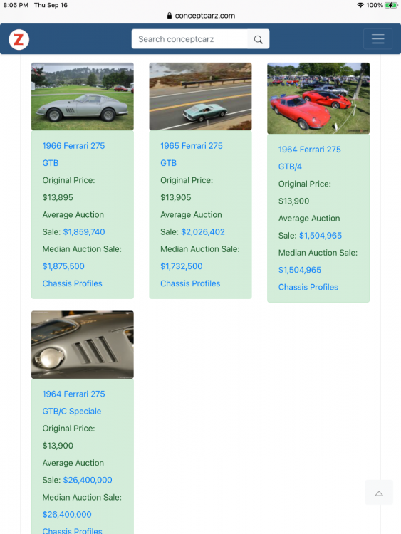

John E Davies Posted September 17, 2021 Posted September 17, 2021 38 minutes ago, ScubaRx said: With our trade in we got out the door for about twice what a new Ferrari 275 GTB would have cost you in 1965. Wow, that was a tough one!!! It took me ten minutes to find that figure….. I am really glad you did not have to pay their current market value. I had a poster of a 250 GTO on my wall for maybe twenty years, what luscious cars. Listen here. The Ferrari 250 GTO Speaks For Itself John Davies Spokane WA SOLD 07/23 "Mouse": 2017 Legacy Elite II Two Beds, Hull Number 218, See my HOW TO threads: Tow Vehicle: 2013 Land Cruiser 200, 32” LT tires, airbags, Safari snorkel, Maggiolina Grand Tour 360 Carbon RTT.
taylor.coyote Posted September 17, 2021 Posted September 17, 2021 That's funny. My father paid $16,000 for our first family home when i was a kid in the mid-60's. Clearly the Ferrari proved to be the better investment in 1964. For towing it comes down to payload for your gear and trailer. the new fore f150's have a nice payload range from 1,800 - 3500 lbs but largely depends on the engine choice https://www.ford.com/cmslibs/content/dam/brand_ford/en_us/brand/resources/general/pdf/guides/21Towing_Ford_F150_Dec3.pdf if you get the cool turbo diesel with lots of torque at low rpm's the engine weight kills you payload.. (1,850 lbs). It's kind of crazy to have all that power and such a small payload. My last 1/2 ton would pull the the LE II fine but we were fighting the payload on every trip... What a pain. We went to an F250 6.7 diesel and don't need to worry about payload. Lot's of 1/2 will do a good job pulling the LE II but few will give you much payload. this said, the f250 is not a good daily driver. 2016 Legacy Elite II, Twin Beds, Hull #124 Tow Vehicle: 2019 Ford F250 4x4 / Short Bed / Crew Cab / 6.7 Diesel Fieldbrook, Ca
