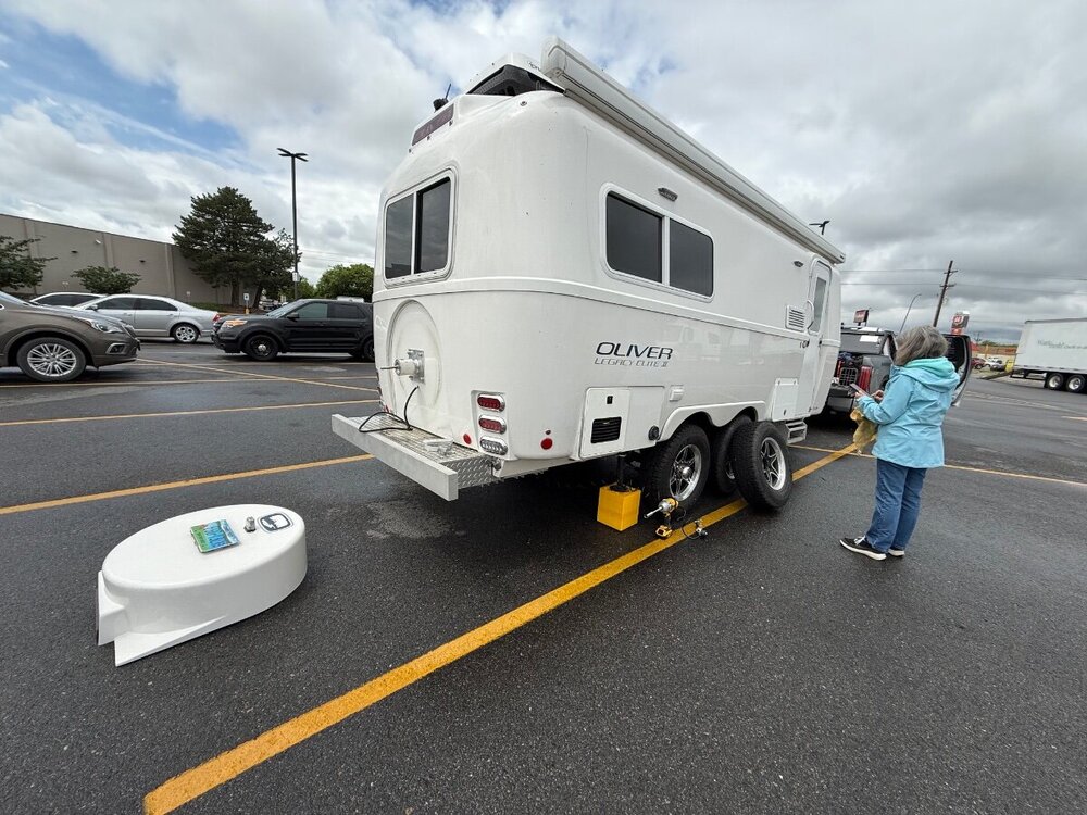

Galileo Posted June 30, 2025 Posted June 30, 2025 After upgrading my grease gun to a “LockNLube Professional Series”, I discovered I couldn’t sneak the coupler behind the tires to get to some of the fittings, so I figured it was time to pull the wheels off to get to them. While I was at it, I intended to try the “unloading the suspension” to get some of the Zerk fitting unwilling to accept grease to submit. Then again, taking the wheels off without unloading the suspension would be more fun than I was up for. Anyway, a lot of realizations in what should have been a fairly straightforward operation: First off, getting a floor jack under the best lifting points on the axles isn’t very easy. That’s something an owner would have to do just to change a tire. What kind of jacks are people out there using? Related to the above, the marked lifting points on the frame require a jack that has pretty high lifting ability. So again, best kind of jack? (I currently have an AC “Racing Jack” - which is fine for most vehicle, easier than a hydraulic bottle jack, and a lot less effort than the mechanical jack that comes with your average TV.) I decided to rotate the tires - front to rear only - since I was gonna have them off. Seemed prudent. I had been naively been trusting the 120 foot-pound torque specs from the Oliver owners manual. I’d been re-torquing them periodically as advised by the manual. No issues until now. This was the first time I had a wheel off. So it’s the first time I’ve actually tightened a lug nut that wasn’t already tight. On the right side - aside from struggling to jack the beast up - everything went fine. However - on the left side - when trying to torque the lug nuts, I found that a couple of them didn’t seem to tighten. They didn’t feel stripped, just wouldn’t tighten. My wild guess is that the studs are pressed in, but don’t have splines to keep them from spinning - which would be unlike every other wheel stud I’ve replaced. (I had even snapped a couple off back in the old days when I tried to remove a lug nut on a ‘64 Dodge that had left hand threads on one side of the vehicle.) Once I searched here and found that 120ft/lbs is likely too high, I tried again at 100ft/lbs and I was able to torque them to that spec. (Kinda like that 80psi on the tires….) So does anyone know if the studs are not splined? Im sure I’ll have more questions as time goes by… 1 2022 Oliver Legacy Elite II Hull #1029 King Bed Floorplan electronics package Truma Aqua-Go LOUD Dometic Penguin A/C LevelMate Pro+ Valterra Electric Black Tank Dump Valve TV - 2025 GMC Sierra 1500 Denali, 3.0l Duramax Diesel, Crew Cab 4WD RealTruck hard tonneau cover Rove R2-4K DashCams Canada: New Brunswick, Nova Scotia, Prince Edward Island
routlaw Posted June 30, 2025 Posted June 30, 2025 I've used both a bottle jack and conventional auto jack with long handle pump. Both work just fine but honestly the bottle jack is easier to get placement with given the limited amount of space and the small target areas. Of course I always use jack stands too. As for the wheel lug nuts, have never ran into what you're describing but do torque them to 110 ft/lbs. Seems like this is the official torque values the last time this came up on the forum. Don't have a clue as to whether the bolts are splined or not. 1 Legacy Elite II #70
Tom and Doreen Posted June 30, 2025 Posted June 30, 2025 (edited) 1 hour ago, Galileo said: ...Related to the above, the marked lifting points on the frame require a jack that has pretty high lifting ability. So again, best kind of jack? This is the method that I've used. Also it's a good idea to have the trailer connected to the tow vehicle for safety while jacking the trailer. I also block the wheels on the other side of the trailer. The second picture was a parking lot tire change from a failed tire valve. If you have rubber tire valve stems and you have tire pressure sensors installed I suggest that you change the tire valves to metal tire valves. Luckily we were close to a Discount Tire location and had all the tires valve stems changed to metal. Edited June 30, 2025 by Tom and Doreen 4 Tom & Doreen • 2023 Elite ll • Hull #1321 • 2023 Tundra Platinum Crew Max • Cheshire CT
John and Debbie Posted June 30, 2025 Posted June 30, 2025 2 hours ago, Galileo said: After upgrading my grease gun to a “LockNLube Professional Series”, I discovered I couldn’t sneak the coupler behind the tires to get to some of the fittings, so I figured it was time to pull the wheels off to get to them. While I was at it, I intended to try the “unloading the suspension” to get some of the Zerk fitting unwilling to accept grease to submit. Then again, taking the wheels off without unloading the suspension would be more fun than I was up for. Anyway, a lot of realizations in what should have been a fairly straightforward operation: First off, getting a floor jack under the best lifting points on the axles isn’t very easy. That’s something an owner would have to do just to change a tire. What kind of jacks are people out there using? Related to the above, the marked lifting points on the frame require a jack that has pretty high lifting ability. So again, best kind of jack? (I currently have an AC “Racing Jack” - which is fine for most vehicle, easier than a hydraulic bottle jack, and a lot less effort than the mechanical jack that comes with your average TV.) I decided to rotate the tires - front to rear only - since I was gonna have them off. Seemed prudent. I had been naively been trusting the 120 foot-pound torque specs from the Oliver owners manual. I’d been re-torquing them periodically as advised by the manual. No issues until now. This was the first time I had a wheel off. So it’s the first time I’ve actually tightened a lug nut that wasn’t already tight. On the right side - aside from struggling to jack the beast up - everything went fine. However - on the left side - when trying to torque the lug nuts, I found that a couple of them didn’t seem to tighten. They didn’t feel stripped, just wouldn’t tighten. My wild guess is that the studs are pressed in, but don’t have splines to keep them from spinning - which would be unlike every other wheel stud I’ve replaced. (I had even snapped a couple off back in the old days when I tried to remove a lug nut on a ‘64 Dodge that had left hand threads on one side of the vehicle.) Once I searched here and found that 120ft/lbs is likely too high, I tried again at 100ft/lbs and I was able to torque them to that spec. (Kinda like that 80psi on the tires….) So does anyone know if the studs are not splined? Im sure I’ll have more questions as time goes by… I use the 90° LockNLube attachment for those Zerk fittings that won't take a straight on attachment. Be very careful with attaching the 90° to the Zerk and also unattaching so you don't loosen too much and lose the three small pieces. I did that and had to buy a new 90°. I torqued my wheel lug nuts to 90ft pounds. I thought I read that somewhere. I use the rear stabilizer jack and a bottle jack with chocking the opposite tires. Attaching to the tow vehicle sounds good too. I have done that before and chocked the TV also along with the trailer wheels. John 3 John and Debbie, Beaverton, Oregon, 2017 Ford Expedition EL 4x4 3.5 liter Ecoboost, with heavy duty tow package. Hull #1290, twin bed with Truma package (a/c, furnace, hot water heater with electric antifreeze option), lithium pro package, picked up November 7, 2022 Alcan 5 leaf springs and Bulldog shocks done May 20, 2025 in Grand Junction, Colorado
jd1923 Posted July 1, 2025 Posted July 1, 2025 3 hours ago, Galileo said: First off, getting a floor jack under the best lifting points on the axles isn’t very easy. That’s something an owner would have to do just to change a tire. What kind of jacks are people out there using? Related to the above, the marked lifting points on the frame require a jack that has pretty high lifting ability. So again, best kind of jack? Please, please, please just use your stabilizer jacks! It’s safer and easier, recommended in the OTT 2016 Owners Manual, later OTT lawyers changed their recommendation. “What do you call a thousand lawyers at the bottom of the ocean?” a good start. 🤣 i suggest using a jack stand close as possible or on bottom-center of leaf springs for safety except for a quick tire change. Yes, connected to TV is always safer, yet not possible in my driveway or other locations. I wrote all this up in another post last week and quoted the 2016 OTT manual. Floor jacks don’t fit and bottle jacks can slip. Do it the easy way, takes just 2 min! 3 1 Chris & John in Prescott, AZ | 2016 EII #113 | '01 Ram 2500 Cummins!
johnwen Posted July 1, 2025 Posted July 1, 2025 4 hours ago, Galileo said: After upgrading my grease gun to a “LockNLube Professional Series”, I discovered I couldn’t sneak the coupler behind the tires to get to some of the fittings, so I figured it was time to pull the wheels off to get to them. While I was at it, I intended to try the “unloading the suspension” to get some of the Zerk fitting unwilling to accept grease to submit. Then again, taking the wheels off without unloading the suspension would be more fun than I was up for. Anyway, a lot of realizations in what should have been a fairly straightforward operation: First off, getting a floor jack under the best lifting points on the axles isn’t very easy. That’s something an owner would have to do just to change a tire. What kind of jacks are people out there using? Related to the above, the marked lifting points on the frame require a jack that has pretty high lifting ability. So again, best kind of jack? (I currently have an AC “Racing Jack” - which is fine for most vehicle, easier than a hydraulic bottle jack, and a lot less effort than the mechanical jack that comes with your average TV.) I decided to rotate the tires - front to rear only - since I was gonna have them off. Seemed prudent. I had been naively been trusting the 120 foot-pound torque specs from the Oliver owners manual. I’d been re-torquing them periodically as advised by the manual. No issues until now. This was the first time I had a wheel off. So it’s the first time I’ve actually tightened a lug nut that wasn’t already tight. On the right side - aside from struggling to jack the beast up - everything went fine. However - on the left side - when trying to torque the lug nuts, I found that a couple of them didn’t seem to tighten. They didn’t feel stripped, just wouldn’t tighten. My wild guess is that the studs are pressed in, but don’t have splines to keep them from spinning - which would be unlike every other wheel stud I’ve replaced. (I had even snapped a couple off back in the old days when I tried to remove a lug nut on a ‘64 Dodge that had left hand threads on one side of the vehicle.) Once I searched here and found that 120ft/lbs is likely too high, I tried again at 100ft/lbs and I was able to torque them to that spec. (Kinda like that 80psi on the tires….) So does anyone know if the studs are not splined? Im sure I’ll have more questions as time goes by… FWIW...I've had the springs and later, axles, installed by Alcan. I had a wheel stud snap off and Alcan said they would take care of it. I went to them and sure enough they took care of it. They did say the stud is indeed pressed in. I don't know about the splines. I have been torquing at 100# and have not had any issues...don't know why the one snapped. While I was there I asked them to remove all the wet bolts and had them installed so the zerks are all on the inside as to not have to deal with tire clearance for the zerks. The only issue with that is I have to lube from beneath the trailer and that is ok for now... I can still get under there! I had some issues with the zerks accepting lube so I wanted the bolts removed and inspected, all was fine, and put back with the zerks on the inside. My thought was since I rotated back to front every 5000 miles and lubed every 3000 miles, I compromised in that at the 4000 mile point I would remove the tires and lube. Maybe the lube hardened up and couldn't accept lube, I don't know. I did replace all the zerks in case they were filled with whatever, and that didn't work. And I do use caps on the zerks. So the happy ending is Alcan replaced the stud and reoriented the wet bolts the way I wanted and since they reused the bolts...they did all for no charge. No labor charge either. Alcan is top shelf IMO. John 5 2022 Oliver II #996 "Bessie", 2019 Silverado LTZ 5.3, Veterans https://wenandjohnsadventure.com/
