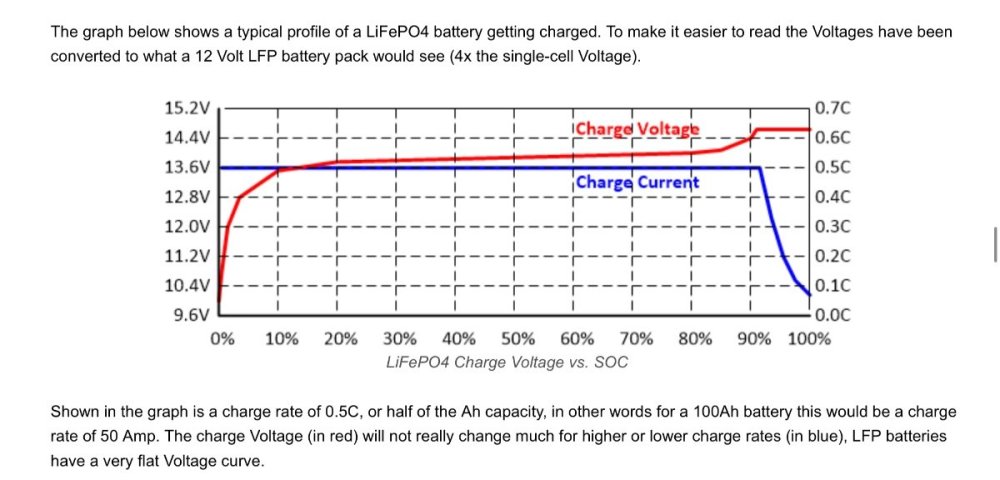

The percent State of Charge (SOC) can be a little deceptive, it isn’t an absolute condition, it is the result of the little computer chip doing all sorts of calculations about charge and discharge rates. My Victron smart bus system actually has a calibration button to “Set SOC to 100%”, for example when it reads say 98% but the charge rate has dropped down to zero. Where I am getting is, don’t rely too much on that figure. OTH I would tend to believe the lithium battery results rather than the solar monitor one. Fully charged resting voltage (no load) should be around 13.5 to 13.6. Your 12.7 volts means a dead battery bank.
Do you have a generator? You need one, in this case you should connect it and charge that way for at least three hours. Your tow vehicle doesn’t do anything, Oliver leaves that charge wire disconnected for the lithium packages, and your solar may just not have had enough actual sun exposure. What has the weather been like? The 75% SOC Zamp solar figure sounds very bogus to me.You need to read and understand more about how your lithiums work, they are completely different form the typical lead acid battery in your truck.
From an article linked below:
Your voltmeter shows not just the condition of the battery but the voltage of what is charging it, for example in full sunlight at full charge my battery voltage is around 14.4. That shows the result of the current coming in from the panels, which operate at a higher voltage than the batteries, otherwise nothing would happen (no current would flow). If the sun goes behind a tree, the panel voltage drops and what you see is the resting battery voltage. Without any major loads it should be about 13.2 to 13.4. Your 12.7 volts represents a dead battery. The battery voltage typical changes very little as it discharges, then it quickly tanks at the bottom. If you have a lthium battery powered drill, you see that when it works fine up to the very end, then it just dies.
https://olivertraveltrailers.com/forums/topic/6629-how-to-find-happiness-with-lifepo4-lithium-ion-batteries-solacity-article/

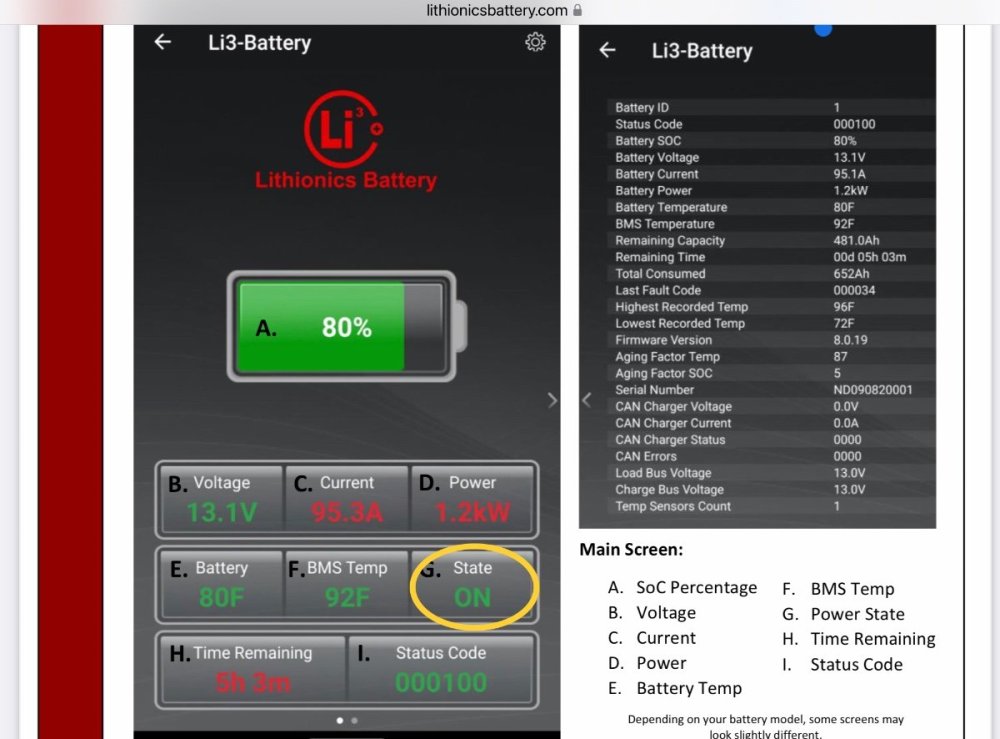

Would the battery on/off state show on the app like the picture below?  Does the picture below show the status of 1 battery or a battery bank?  Or would the app show on even if only 1 of 2 or 3 batteries is on?  I do not have Lithionics batteries, but I am trying to understand them a little better?
Mossemi:
In the Lithionics app you see each battery as it's own entity.
They have a specific SN and you can rename them ...like Battery 1, Battery 2 or Front/Rear etc.
In the Lithionics app then you  see each battery on or off and it's specific details.
Folks with 3 Lithionics battery configurations have 3 different battery screens available to look at the details.
For the Platinum Package with 2 of the 315AH batteries you see 2 screens.
In our case we also installed a Victron Smart Shunt on the negative side of the bank of 2 batteries.
This way we monitor the total of both batteries.
(To do that we're using 2 bluetooth based apps,  one from Lithionics and one from Victron.)

Open the Lithionics App....here is the initial screen showing three batteries in my case. If you don't have all batteries showing....make sure they are on and then tap the discover button shown below. Tap on each battery to see the specifics as you show in your attachment.
By the way your screen shot is showing 95 amp load....which seems alot if you have more that one battery. Boondocking....my AC will pull 28 amps each battery.
