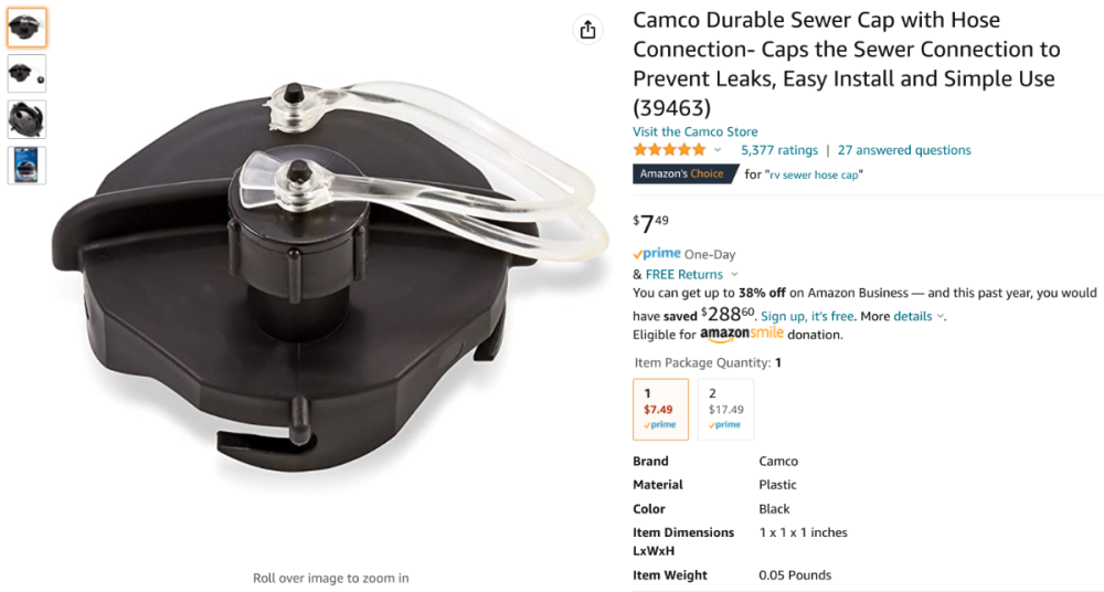

Sak Posted July 7, 2022 Posted July 7, 2022 Am I the only person having difficult time twisting off the sewer cap? Any tips for making it easier. Thinking about swapping out to one of these but not sure if it's going to help. 2021 Oliver Legacy Elite II - Hull #854 2021 Ford Expedition Platinum
Moderators Mike and Carol Posted July 7, 2022 Moderators Posted July 7, 2022 You could try a little lubricant to see if it makes the twist easier. I switched hoses a few years ago to the Valterra Dominator. It doesn’t have that kind of locking cap, just a plug that goes in and stays by friction. Never had an issue with it. The other advantage to the Dominator (and Camco RhinoFLEX I think) is that when you scrunch them up they stay scrunched up. You only need to unscrunch what you need. Mike 2 2 Texas Hill Country | 2016 Elite II #135 | 2020 Ram 2500 6.7L Cummins

Trainman Posted July 7, 2022 Posted July 7, 2022 I can understand what you are talking about, not that I find it hard to twist, but it just at an angle which makes it a little harder to twist on and off. I did see sometime back that someone used a Camco 6" extension tube which extended the factory tube longer which makes it easier to get the cap off and hook up the sewer drain tubes. Here is one that I'm talking about, shop around for better price, https://www.alumigogo.com/product_detail.php?id=SKUB016V2JMBS&last_node=General&click_src=bingads trainman 1 2019 RAM 1500, 5.7 Hemi, 4X4, Crew Cab, 5'7" bed, Towing Package, 3.92 Gears. Oliver was sold.
Townesw Posted July 7, 2022 Posted July 7, 2022 What about this https://www.amazon.com/Valterra-F02-3106BK-Black-Coupler-Handle/dp/B0006MRR2Q 1 1 Bill and Martha 2018 LEII Hull 313 Original owners 3/14/2018 2019 Chevrolet 2500HD Duramax
Sak Posted July 7, 2022 Author Posted July 7, 2022 41 minutes ago, Townesw said: What about this This looks promising. Thank you! 1 2021 Oliver Legacy Elite II - Hull #854 2021 Ford Expedition Platinum
