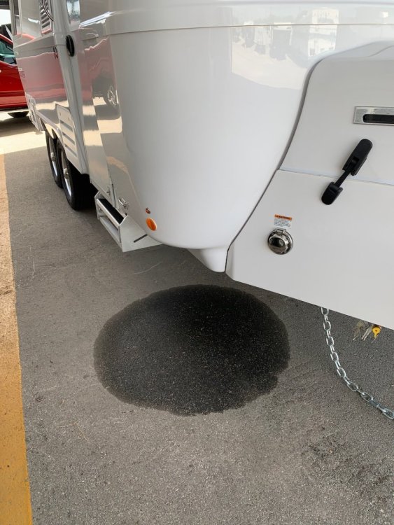

We live in San Antonio and it hasn't rained for a month. The power is completely off and the trailer hasn't moved in a couple of weeks. Every time I visit the trailer, it has this fresh spot of liquid (appears to be water) under the right front of the trailer (see photo below).
The liquid seems to be coming from a drain (see photo below).
Does anyone have an idea of what this drain drains? And is this a problem?

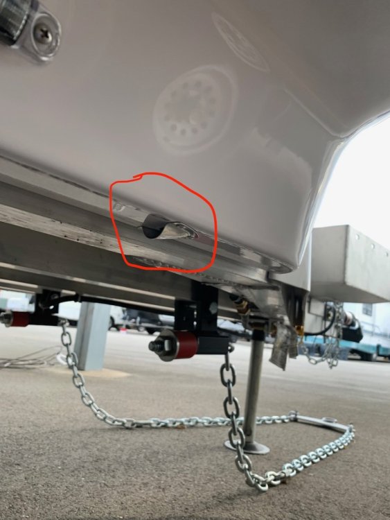

There is a weep/drain hole under that cover.  It and the others like it are located around the underside of the trailer.  It looks like your parking space is under cover, so it shouldn’t be weather related.  That mean’s there is probably a water leak inside.  Is the front curbside corner the lowest part of the trailer?  Is the water pump on?  How much water is in the black, grey and fresh water tanks?  Are you storing drinking water in bottles or jugs in the trailer.  I would start troubleshooting with a bucket under the weep hole to quantify the amount of water your a dealing with. Then I would look for moisture under the rubber mat in the closet.  I would also look under the kitchen drawers and bathroom vanity for signs of leakage from the faucets or drains.  Let us know if you find any sign of water.

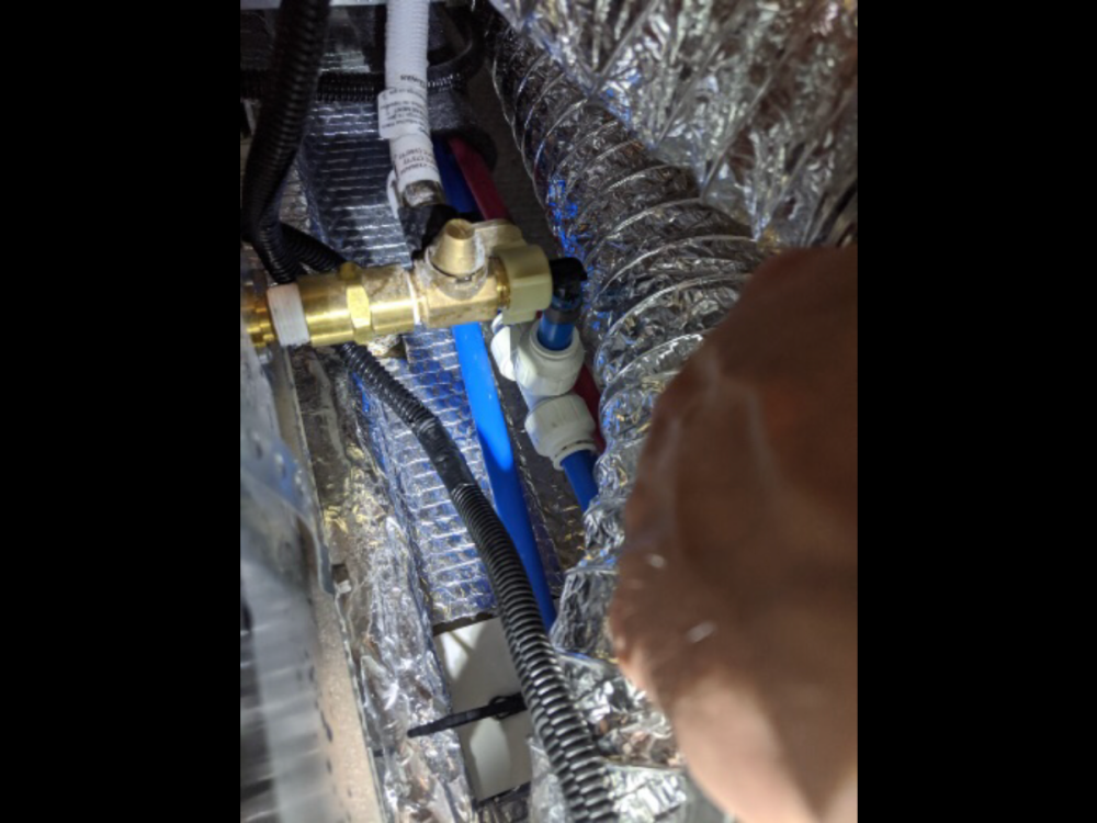

@John and Jodi also consider checking ALL of your white compression fittings on the curb side under belly area where your waterlines lay in the belly of the Ollie floor. If one of these fittings are loose and they do loosen ask me how I know😅, just hand tighten only and recheck to see if you have any further leaks. A blue shop paper towel aid in showing you if any or which ones are leaking or even seeping. Try this using your pump and then try this with just your city water on.
Any loose compression fitting can allow enough water to travel to that scupper if your Ollie is just slightly nose down.
I find myself checking all of these fittings before and after long trips. After a good hand tightening I have not had any come loose. You can also install foam rubber pipe insulation to reduce the vibration between the plastic connectors and the Ollie interior shell.
You many already know what a compression fitting looks like, incase you don’t here is a pic of a white compression fittings look like. Don’t over tighten these as there is a potential for it to break or split, it’s only plastic. A good gentle snug tightening has served me well.
Hope this helps!

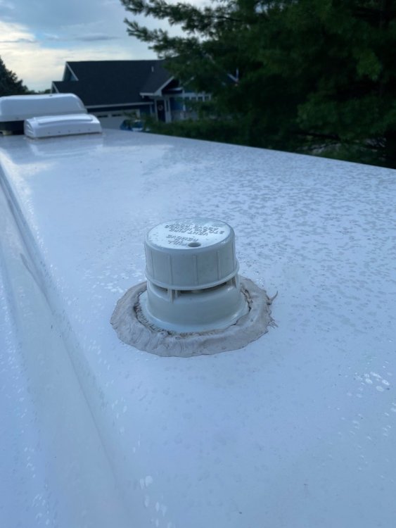

The big black pipe in the closet is the vent pipe.  It goes up through the roof and has a cover on it up on the roof.  It shouldn’t be wet, especially since we haven’t had any rain.  Like Steve explained, the front of the vanity comes off after removing the screws and cutting the caulking.  Not difficult to do and once done it’s easy to re-caulk.  Mike

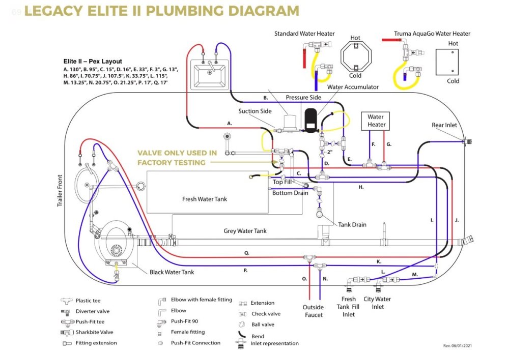

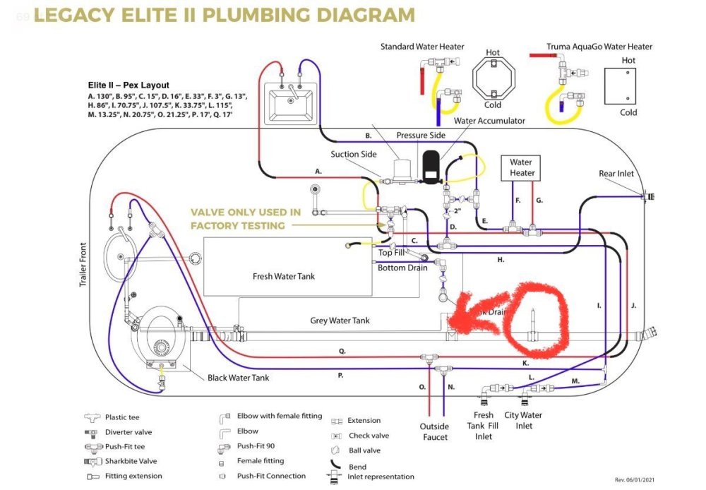

Does anyone’s Oliver actually have the gray tank drain located as shown on that schematic (red circle)?  Mine is located properly directly at the outlet of the gray tank (red arrow).  Having it located as shown on that Oliver schematic would let black water flow into the gray tank when the black tank drain valve is opened.

@John E Davies Yes, I've studied the diagram and I can even pick out the pipe on the diagram, but it's not labeled as to its function, so I asked.

Before you dig into the vanity,, If the black vent pipe in the closet is  is wet to the touch, you possibly have a sealing issue at the roof penetration.
I'd take a hose to it, and see what happens.  Means cleaning up the closet area well first, and, maybe a second time as well.
Side force strong  hoses act like wind driven rain. You may never have a problem again. Or, it could need resealing. Even a tiny air bubble in the caulk could break open under a powerful spray, and introduce some water, running down the side of the vent pipe. Imo.
Good luck. It's aggravation,  but I'd start there, if it were me. Water driven into the vent pipe cover shouldn't give water on the outside of the pipe, imo.

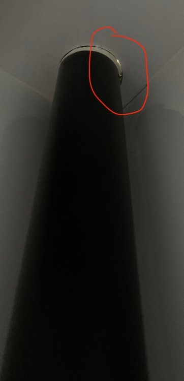

So after troubleshooting most of the day, this is where I am:
  1. Without opening the bathroom vanity, the liquid seems to be contained in the closet and then drained through the floor cover to the weep/drain hole.
  2. We believe this is related to the wash/ceramic coating service that I had done recently because:
    1. The liquid feels "slick"
    2. Washing our hands after touching the liquid causes the water to bead up on our hands
    3. We never noticed a spot under the camper prior to the service
  3. There do appear to be caulking issues both outside and inside (see photos below)
  4. In spite of all of this, using our hose, we could not duplicate the issue
    1. We confirmed with our detailer that he did not use a pressure washer or any other high pressure device to wash or apply the coating
    2. We both "soaked" the roof next to the vent checking for seepage and also used the "jet" setting on the vent to try to generate some splash
    3. Additionally, when we returned home from Hohenwald, we drove through some hellacious t-storms and did not notice a leak
  5. Next steps include:
    1. Calling Oliver and opening a service ticket
    2. Attempting to recaulk the exterior seam next to the vent
    3. Determining whether the interior seams need to be caulked: around the pipe; closet side wall to ceiling; closet front wall to ceiling; as well as the entire length of the closet front wall to side wall
    4. Monitoring for additional liquid in the closet. As @mossemi noted, our storage spot is under cover and it doesn't rain here a lot right now so we'll see.
Please let me know if you have any recommendations for type/brand of caulk to use.

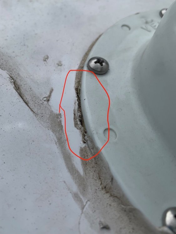

Photo 1: exterior vent seam on roof
Photo2: light through hole in closet ceiling

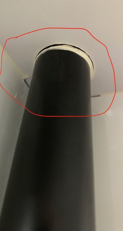

Photo 3: interior caulking issues?

I’d clean out the old caulk and recaulk the exterior vent flange/hull connection.  The interior joint where the black pipe goes through the interior hull should never see any water, since ideally you want all water being stopped OUTSIDE the exterior hull.  My roof vent has always had really heavy caulking around it.  Doesn’t look the greatest but it’s not something that noticeable since it’s on the roof, and it’s never leaked (knock on wood), (or is it “knock on fiberglass” for an Ollie?).
You said the pipe was still wet when this thread was started, also your Ollie is under cover; how long ago was the ceramic job performed? Would the pipe have had time to dry prior to today?
David & Kim | Chattanooga, TN | 2017 Ram 2500 Laramie 4x4, Hemi 6.4 | Legacy Elite II Twin, Hull# 1213
CanadianProvincesVisited.jpg.b955f763ac89bc32484dc71390bbeb5b.jpg       ALAZCAFLGAIDIAKYLAMIMNMSMOMTNENMNCNDORSC
If you can see light in the inner hull seal, its an opportunity for a leak to run down that pipe? But, if water got into the interstitial space between the hulls, it has to go somewhere...
Unfortunately,  doesn't mean it's coming from the vent. Doesn't necessarily narrow it down, actually.  Could be coming from another roof penetration.  How is your trailer sitting? Nose down, or up? Level side to side? Do you leave the bath vent open while parked?
As a roofer friend said once, you have to think like a rain drop...

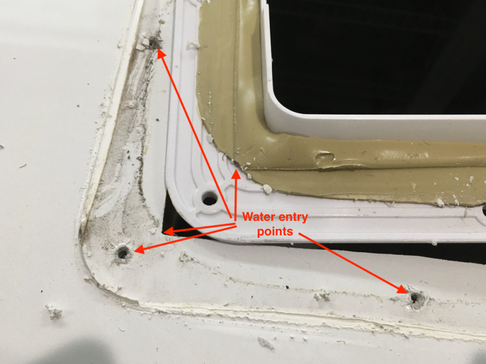

The screws should be sealed as well as the flange. That screw shows no sign of sealant around its head, water can and will go down around them. Oliver has been known to mess up here. I had to remove and reseal my roof vent because the installer did it wrong. Since you have NO idea what the actual condition of the sealant is, you should remove that vent entirely, clean off the old sealant underneath, and reinstall it properly. Or have Oliver do it for you under warranty.
FYI, lack of sealant shows as dirt on an older trailer. Water and dirt was traveling down those three screws and then into the ceiling below. Adding more sealant around the outside would have done nothing to correct the root cause.
