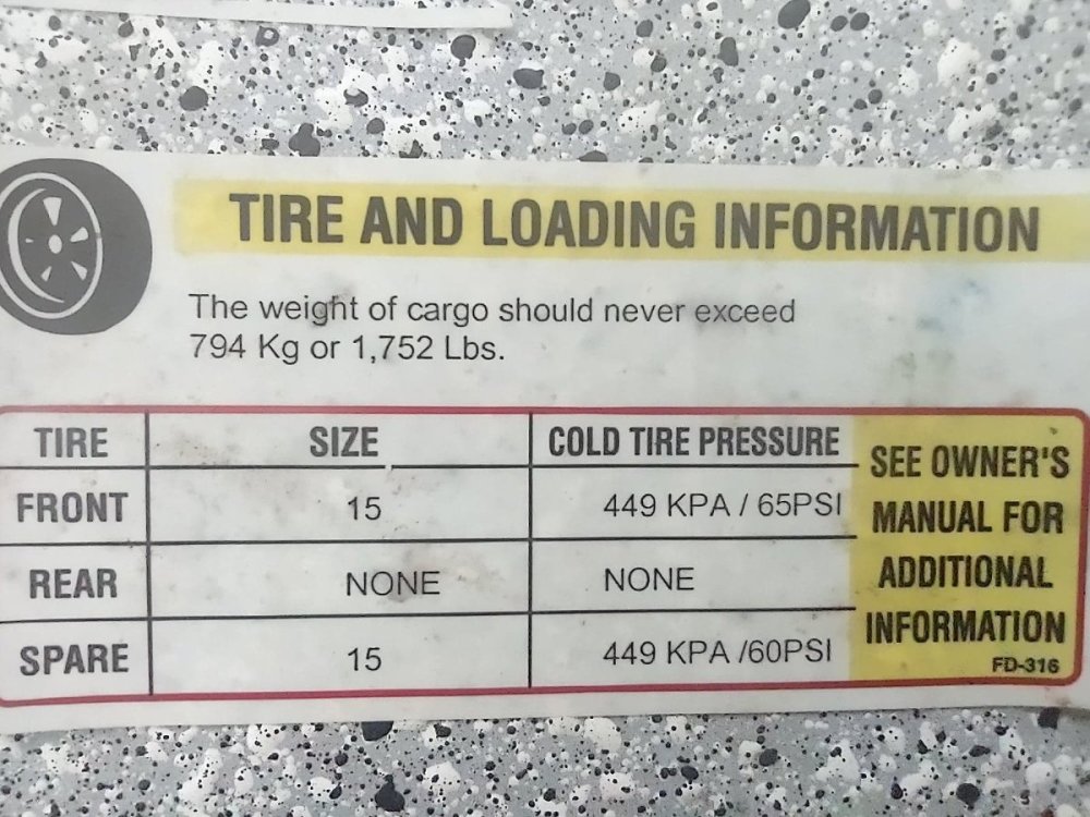

IF YOUR PLACARD IS DIFFERENT FROM THIS PLEASE POST A PICTURE.
Mine shows 65psi, but then again, it looks like my labels were made on a late Friday afternoon. Missing tire sizes and incorrect GVWR and GAWR ratings. Edit- And even "V.I.N" is spelled incorrectly. 😄

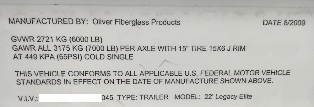

On 8/20/2022 at 9:16 AM, John E Davies said:

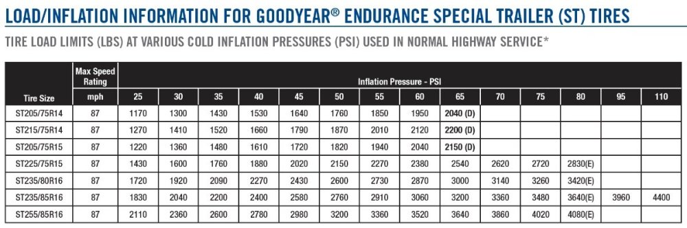

This has not yet happened, here is the one I made for the older tires (I run mine at 42 psi, with an approximate 6000 pound trailer weight.):
From the 2022 Owners Manual
This does not surprise. From the chart above one could even assume a tire pressure of 40 and perhaps even 35 might be adequate given the weight of a 6000 lb trailer. From various other online charts I've come across they tend to be approximately the same as above. Thanks
Legacy Elite II #70
From the charts I agree.  But...
If we are running 34 or 40 PSI with a tire minder, we would need to set it lower to alarm.  I run our OE2 @ 50 PSI.  This gives my tire minder an opportunity to alarm earlier, for the express purpose of giving me more time to find a safer place to get off the highway.  Yes, this is a compromise of sorts, but far less than what John D. and I tussled OTT to reduce their required PSI of 80 a couple of years ago.
