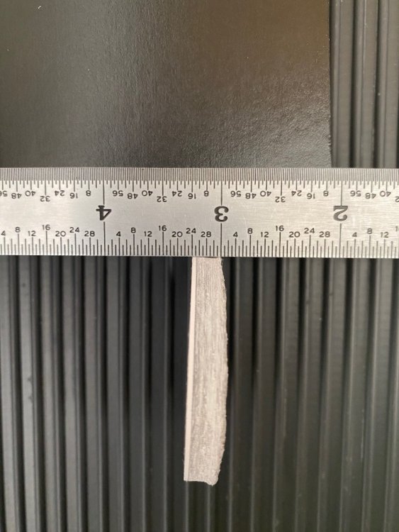

For reference, here’s a couple pics of what the outer Oliver hull fiberglass construction is like.  I have this piece from a 2” diameter hole I cut in the lower hull for a modification I did.  The total thickness in the area I cut through is about 1/4”.  Some high stress areas are thicker with additional reinforcement in the fiberglass.  The outer white gel coat layer is about 1/32” thick.  A small pin head size ding is not a problem for an Ollie 🙂

For reference, here’s a couple pics of what the outer Oliver hull fiberglass construction is like.  I have this piece from a 2” diameter hole I cut in the lower hull for a modification I did.  The total thickness in the area I cut through is about 1/4”.  Some high stress areas are thicker with reinforcement in the fiberglass.  The outer white gel coat layer is about 1/32” thick.  A small pin head size ding is not a problem for an Ollie 🙂

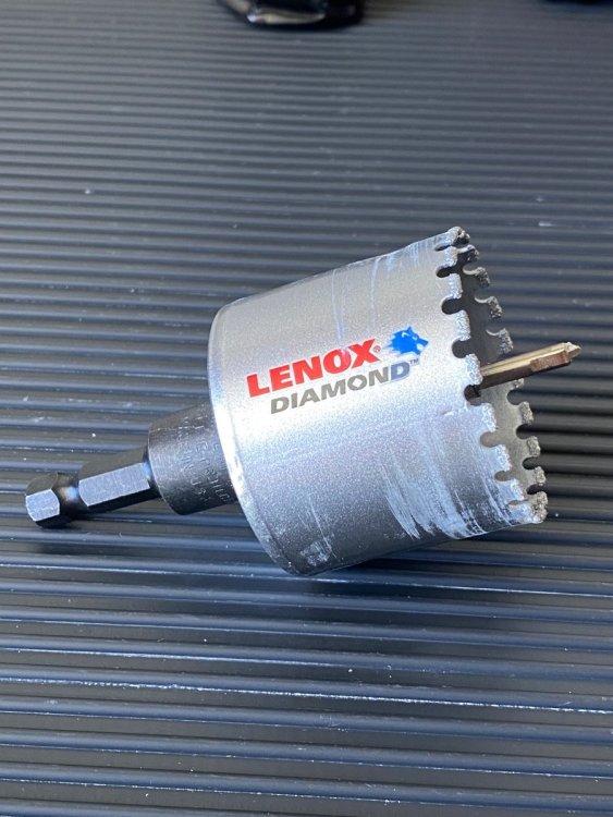

It’s always a bit tense when cutting or drilling into the nice pristine glossy surface of the Ollie, you just have to make sure that the drill bit or hole saw doesn’t go skidding across the surface and create a big ugly scar, and also taking care not to crack or chip the gel coat layer.   But I’ve had very good success using diamond grit hole saws on the Ollie for making holes.  The diamond grit hole saw makes a very nice clean cut, and doesn’t cause any chipping or cracking of the top gel coat layer.  The center pilot bit creates a nice starter hole to keep the hole saw from shifting while drilling.
Frank, that is good to hear, are the diamond saws expensive? I use plain old bimetal steel ones from a kit. which work well enough, though they do leave frayed fibers on the back side of the hole. I just use 80 grit sandpaper to CAREFULLY hand sand that smooth. Use gloves because those fibers make nasty splinters in your fingers that are nearly impossible to see and remove, because they are clear glass (silica). I have lost count of how many big holes I have drilled in “Mouse”.  The first one requires bravery, after that, no big deal. I do try to not drill when I can use velcro or VHB tape instead.
From Lowe’s, $40 for the 2” hole saw plus $18 for the pilot bit.  So definitely more expensive than standard hole saws.  But very nice results.

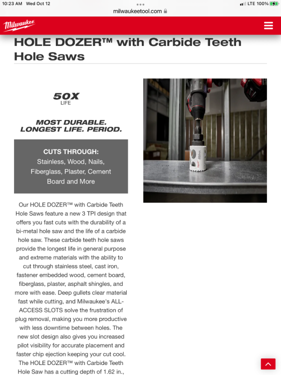

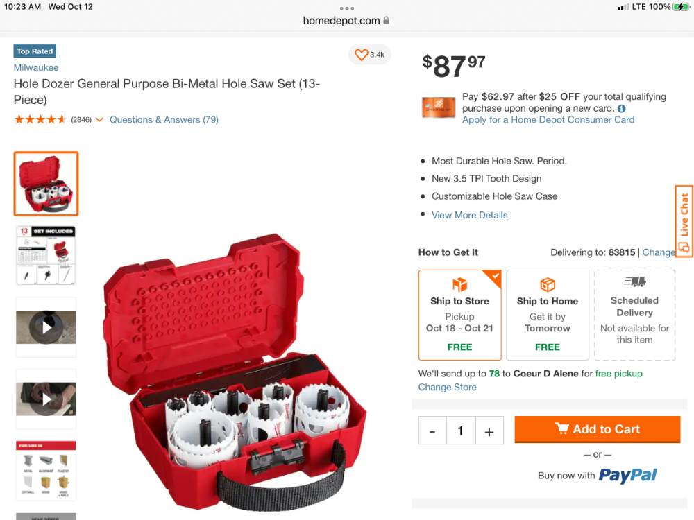

Yikes, too pricy for me….l I bought this set on sale at HD for around $65.
The individual saws are affordable, I used a 4” one to cut two holes in fiberglass and two in 1/8” aluminum plate. The aluminum took a while and a drill press with cutting oil and lots of patience. (I literally shattered a 20 volt DeWalt 1/2” drill gearbox trying this by hand 😳) Milwaukee makes specialty ones, for example this carbide unit, they are expensive and more suited for a production line application or a professional plumber or HVAC guy...

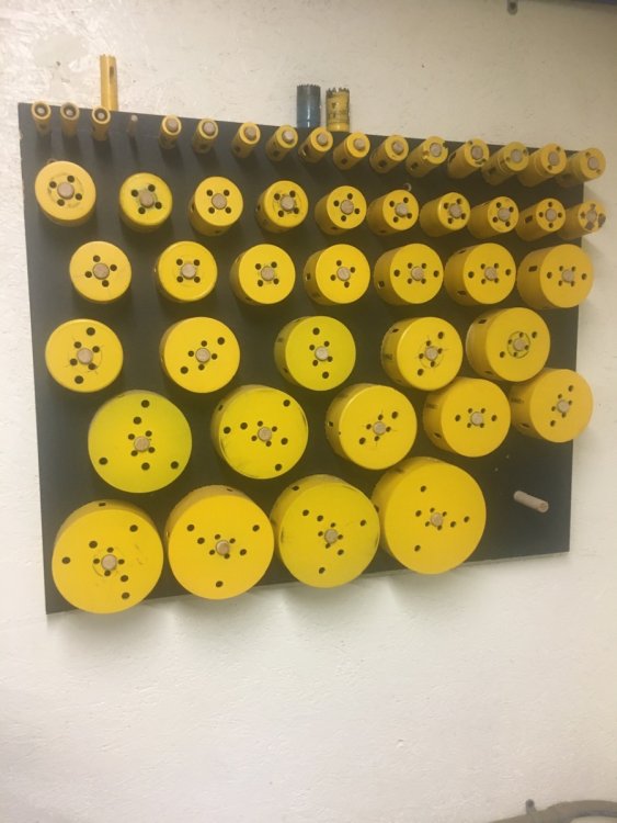

Through the years I have acquired every size hole saw that Dewalt makes from 9/16” to 6”. I have used them many times to cut perfectly sized holes in wood, acrylic, fiberglass, aluminum and mild steel. It’s much cleaner and easier if you can put your piece into a drill press rather than trying to use a hand drill.

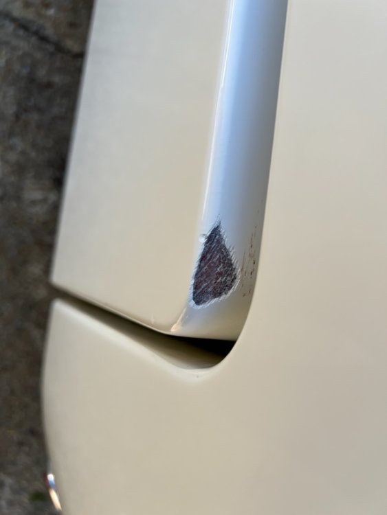

This is a deep scrub into the upper edge of the basement door. I had it open and moved the trailer forward allowing it to contact the concrete.
