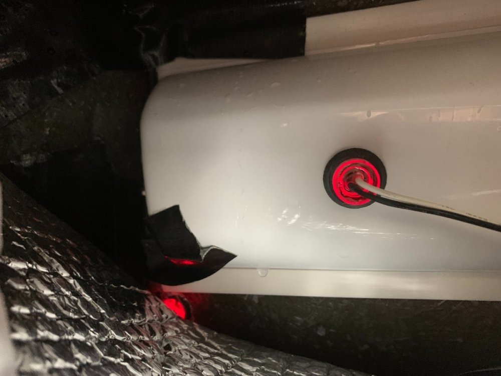

I can confirm with pictures that water does indeed condense on the hull.  I was looking at the way the King Omnidirectional antenna was routed into the attic when i found this horrible leak.  After further investigation involving paper towel, a fan and a water hose, I determined it was just condensation on the hull.  I will be leaving the scupper holes open but I would sure like a one-way valve on it to reduce air infiltration.

You may be right.  i never actually blocked the skuppers.  My thought is that as long as there is moisture in the trailer and temperature differential on between air surfaces, condensation will happen.  I was planning on blocking the holes just for the winter in an effort to minimize all that cold air intrusion. Guessed that warm, moist air would rise (like in the atmosphere) and that I could vent through Maxair Fan.  Even mid winter, we would crack the fan cover, not turning on the fan itself unless cooking and it did wonders to cut back on condensation.  Pretty much limited to windows over beds where we were breathing.  We had reflectix inserts in all windows so would open up the ones by beds every couple of days to find a modest amount of frozen condensate.  Took no time to dry out.  I ultimately gave up on the plan as my experience with digital thermometers in vulnerable spots, proved to me that my un-winterized Oliver, even after mods, had limited cold weather use.  Some have had success down to zero with their trailers.  I accept their account but could not reproduce the experience myself even after literally month's of winter camping and careful testing.  I always found multiple spots in the hull, that had water lines run through them, that would drop to below freezing given consistent exterior temperatures in low teens or lower.  Covering some of the skuppers during the dry winter time may have really helped improve performance.

We have two small electric de-humidifiers we use in Ollie.  Condensation will collect between the hulls where the Oliver Sign is located in the overhead storage.  Been thinking about installing a 2" vent in each removable bulkhead partitions where the Oliver sign is located along with using a small de-humidfier in that compartment to better help with condensation.
