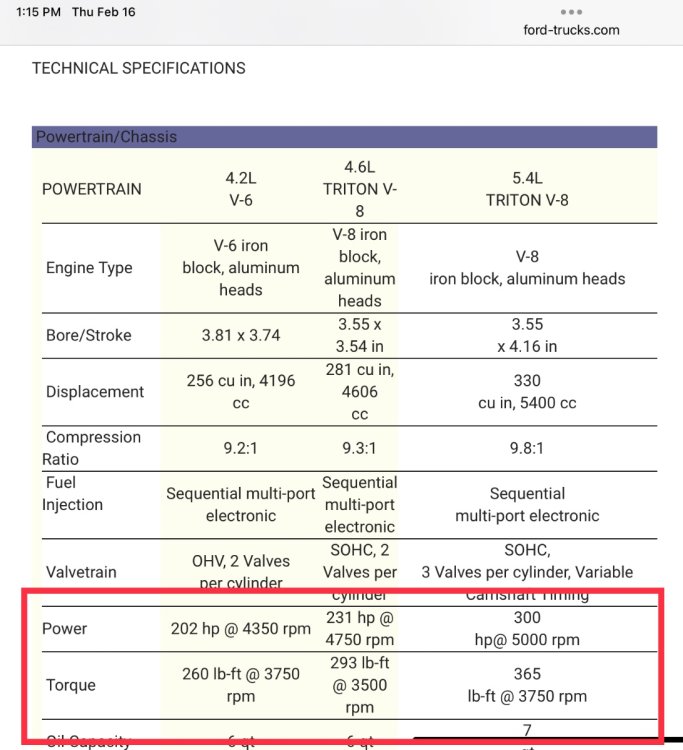

Hello all. I have not purchased my Ollie yet but I would like to do my due diligence. Can I tow with the aforementioned vehicle? It has no tow package. This would be for the Ollie Elite II. Any insight would be much appreciated.
A quick look on the internet I found this https://www.ford-trucks.com/specs/2006-2/2006-ford-f-150-specifications/
Without knowing more about your TV I would say looking at these charts that towing the Elite ll might be more than your TV should tow.
I know I would not want to tow with that. I think the Elite ll weighs almost 5000lbs empty. I figure that after we put our things in our that we are pushing 6000 lbs.

Hi Melody, welcome to the forum, I agree, you don’t have enough power to safely tow an LE2 which can weigh as much as 7000 pounds. Compare the power figures for your engine vs the big V8.
You might be able to CAREFULLY  tow it home to Florida from the factory, but the first steep grades you encounter will show you that it just isn’t going to be satisfactory.  You will 100% need to upsize your tow vehicle, or downsize your trailer. Considering the age of your truck, it makes sense to get a more modern, more powerful, much safer truck.
