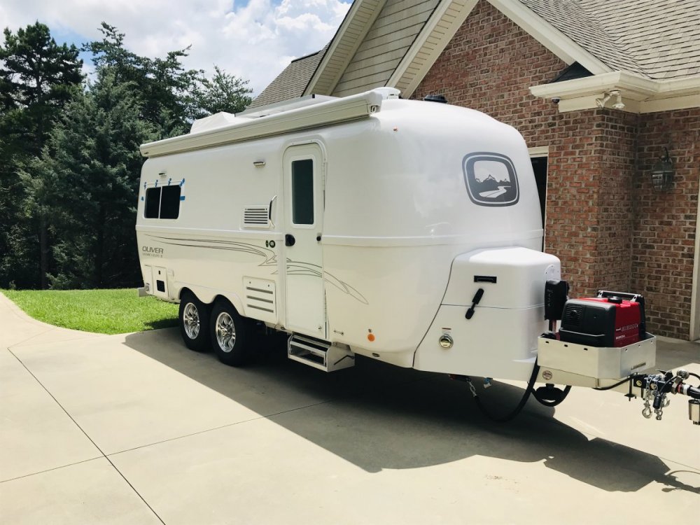

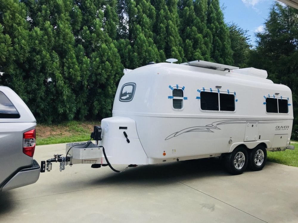

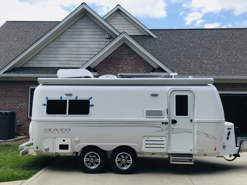

Patriot Posted July 8, 2020 Posted July 8, 2020 (edited) A beautiful 78 degree gorgeous North Carolina foothills morning and time for Hull# 634 to have EZE gutters installed. The install went really well and we are happy with the results. My bride was my extra set of hands which really helped. I will leave the painters tape on for another day or two ensuring a good curing of gutter adhesion material. We let the gutter material heat up in the sun which made it easier to work with. We ordered the Bright White gutter color for our 2020 Ollie which matched up perfect. We even did a gen set cargo box fit check with our new Honda Handi eu3000i and all is well. Thanks to everyone who posted up on EZE gutter install info. Another mod done! -David Edited July 8, 2020 by Patriot 2 2 2020 OLEII - Hull #634 aka- “XPLOR” TV 2021 F350 6.7 liter Diesel Lariat Ultimate Tremor aka - “Beast of Burden” Truma Aventa 13.5 AC, Alcan 5 leaf pack, Alcan HD shackles & HD wet bolts, 5200lb never lube axles.XPEL 10 mil PPF front both front corners, 30 lb LP tanks, Sea Biscuit Front Cargo Storage box. ⚡️⚡️11/2025- Lithium upgrade to XPLOR - (2) Epoch 300ah Lithium batteries, Victron 3000W MultiPlus-II, Victron GX Touch 70, Victron Cerbo GX, Victron Smart Solar MPPT, Victron Smart Shunt, Victron Orion XS 1400 DC-DC charger, RV Soft Start. Zamp 90W suit case solar panel for 420W of solar.⚡️⚡️ North Carolina
Moderators SeaDawg Posted July 8, 2020 Author Moderators Posted July 8, 2020 That looks really nice, Patriot! I think the painter's tape is a good idea for the first day. Sherry 1 2008 Ram 1500 4 × 4 2008 Oliver Elite, Hull #12 Florida and Western North Carolina, or wherever the truck goes.... 400 watts solar. DC compressor fridge. No inverter. 2 x 105 ah agm batteries . Life is good.
