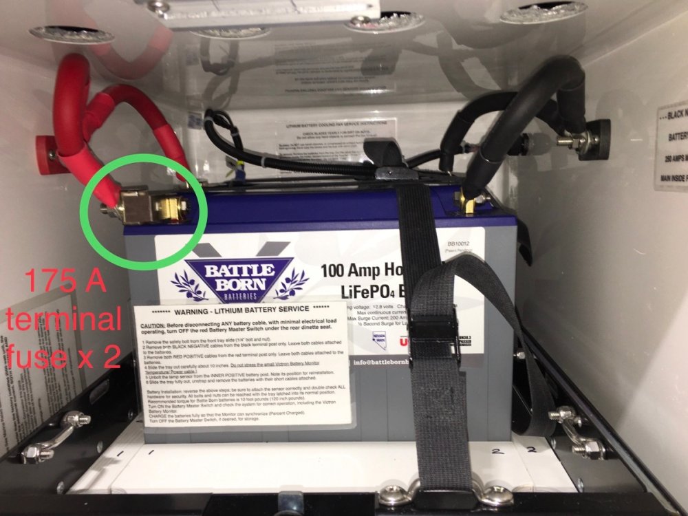

I think the entire electrical system has some VERY major design flaws that should be corrected. An owner should not have to worry about cr@p like this due to shoddy design!

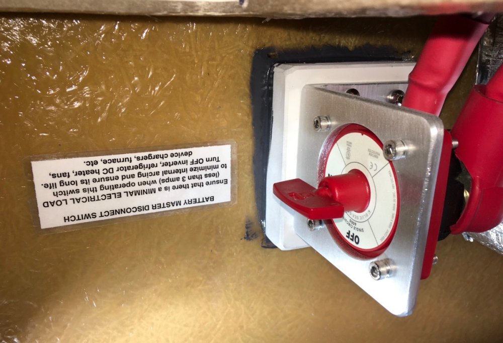

Ollies need a central battery master on/ off switch inside the trailer, not at the batteries...
(No - the picture is not upside down.) All the cables should be run to two central internal positive and negative buses. EACH battery positive terminal needs a limiting fuse of an adequate rating to operate normally, but it would blow in the event of a current overload. There should be no unfused wires anywhere, ever!!!!
And …… every owner should have full access to up-to-date wiring diagrams.
Does Oliver consult with professional electrical engineers? I seriously doubt it …
As a side note, “old school” electronics and appliances with separate functions, such as a charger and an inverter, or a water heater and furnace, do perfectly fine in an RV environment, they are very simple to troubleshoot or cheap to repair, and they don’t cause major system headaches when one fails. If one goes out in the field, you usually can continue camping without very much trouble.
Properly designed systems should make life easier and more trouble free for owners. Not make things complicated. OK, I am done ranting 😉
I respect your opinion on this.  If the fire is in the Battery Box, inside is logical.  So long as every occupant of the trailer knows where it is.
On the other hand some believe that if there is a fire situtation, get all occupants out NOW and away from the trailer.  Then once the family and pets are safe, kill the power source at the batteries or some other outside accessible location.  Looking for a master switch hidden under the beds or in a closet somewhere is not time efficient.
However fire fighters will go to the battery box and either cut the 4/0 cable or use the red master switch.  That likely will be their first action once finding the buring trailer.
Regardless, your comment begs having clearly visable signage that "Emergency Battery Switch Here" would be advisable for all locations where the switch is located.  Personally I show my guests our 350 amp rated Blue Seas master switch as part of our trailer tour.

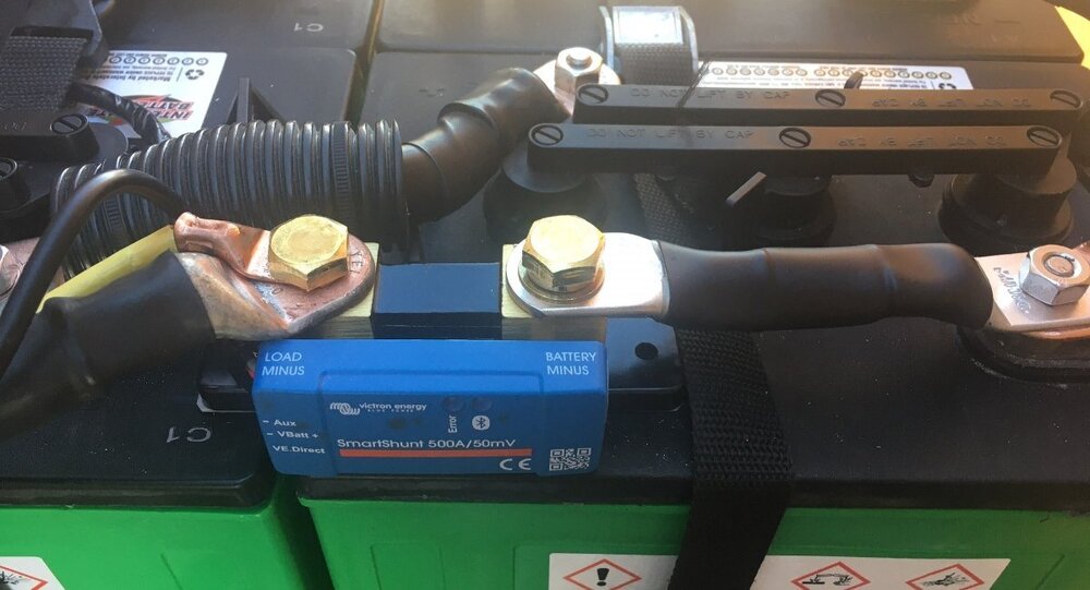

For $100 and easy installation, the Victron SmartShunt is a very nice accessory! Now with Victron MP2 Inverter and MPPT Solar charger, I have 3 app screens to view. This one is for the SmartShunt. It's about 2PM, SOC is 100%, so the solar charger is only needing to add +0.75A net (in addition to amperage being used by 12V accessories/lighting and the inverter at idle.
This can be added regardless of make and model of other system components: Amazon.com: Victron Energy SmartShunt IP65 Battery Monitor (Bluetooth) - Victron Smart Shunt - 6.5V-70V, 500 amp : Automotive

@jd1923 I installed a Victron SmartShunt along with the LFP upgrade to the Oliver, as well as one in my portable power station, which has dedicated solar. The VictronConnect app is a great tool for monitoring our DC systems!
2020 OLEll, Twin, 579:
11 minutes ago, Ronbrink said:
I installed a Victron SmartShunt along with the LFP upgrade to the Oliver...
I did this upgrade first and by itself. Made a shorty cable and just mounted it at the batteries. You also need to connect the red wire to positive, so simple.
When I upgraded to LFP and new inverter, I mounted the shunt at the other end of the B- battery cable closest to the inverter to get it out of the battery bay.
