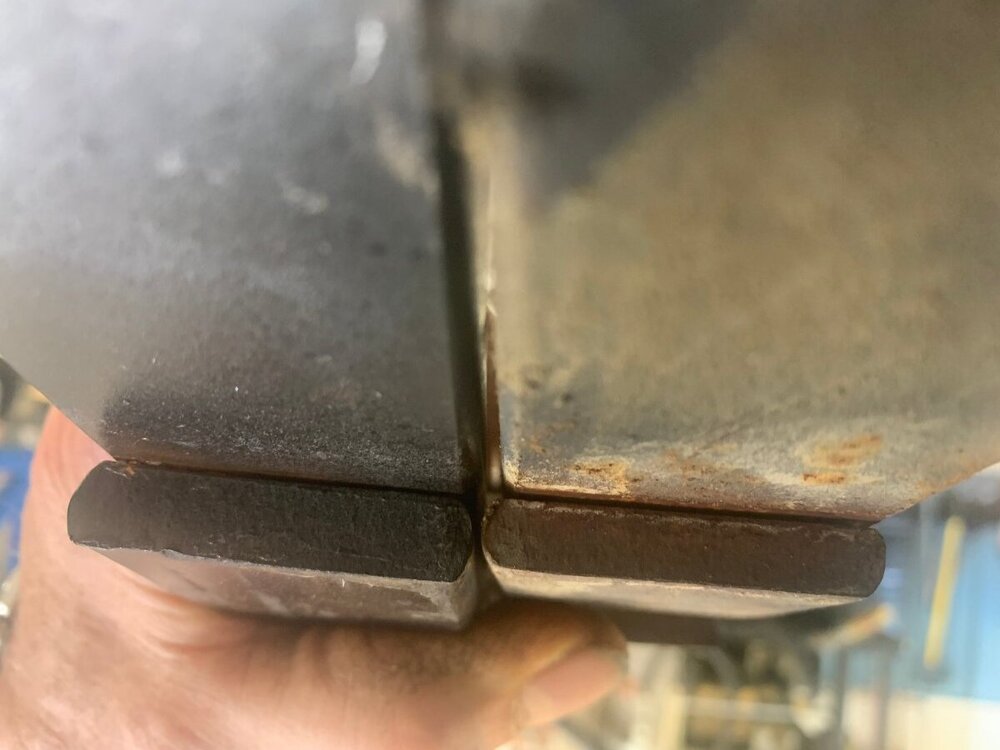

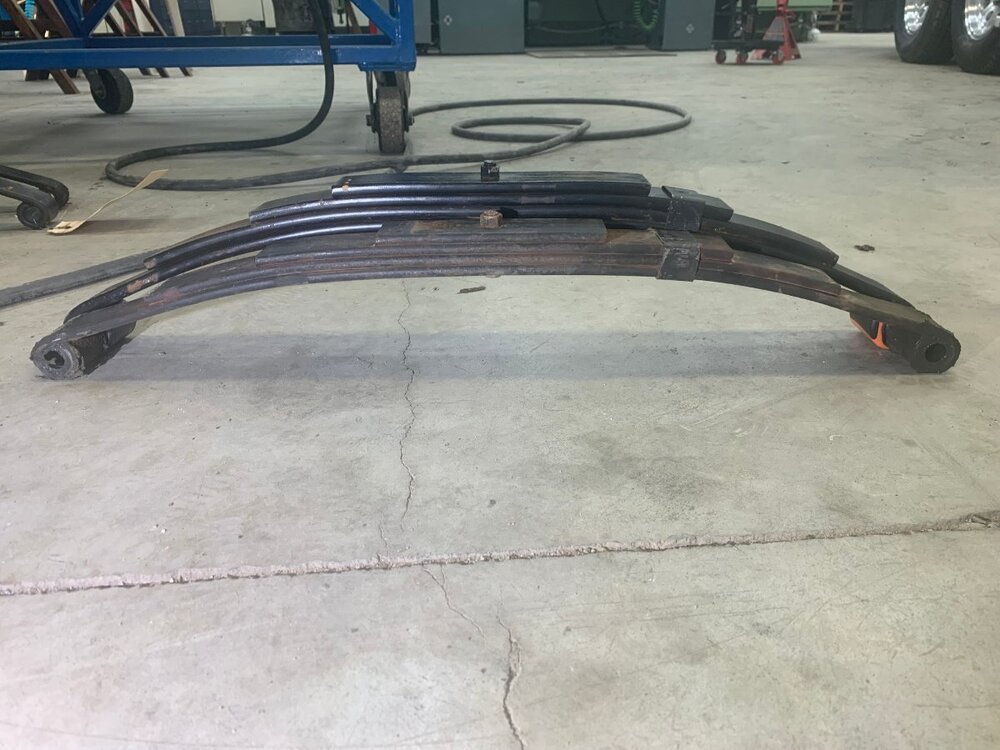

I been following this topic and it got me to look at my springs and sure enough 1,750 pound four leaf springs were failing. I was leaning to ALCAN five leaf for replacement but when Geromimo John came up with the Dexter 2400 pound rated 4-leaf I decided that would be a better fit. My thinking is keep the ride as soft as I can but have springs  strong enough not to distort them from the load that the Oliver puts on them. So this bumps the 7000 pound rating to 9600 pound rating and I think this should be sufficient for them to carry the load with out distorting the springs. I included a pic of the 2400# spring next to the worst 1750# spring.
This is the differences in thickness of the leafs.
The individual leafs are longer.
I didn't think to measure the height before I started the job but when I had one side installed I measured from side to side and there was 1-1/2 inches difference at the wheel wells.
Thanks for sharing. Please let us know how the ride is after you have some miles on them. I believe you will be the first to test the 2,400lb springs as a full set of four. Always good to have proven alternatives.
