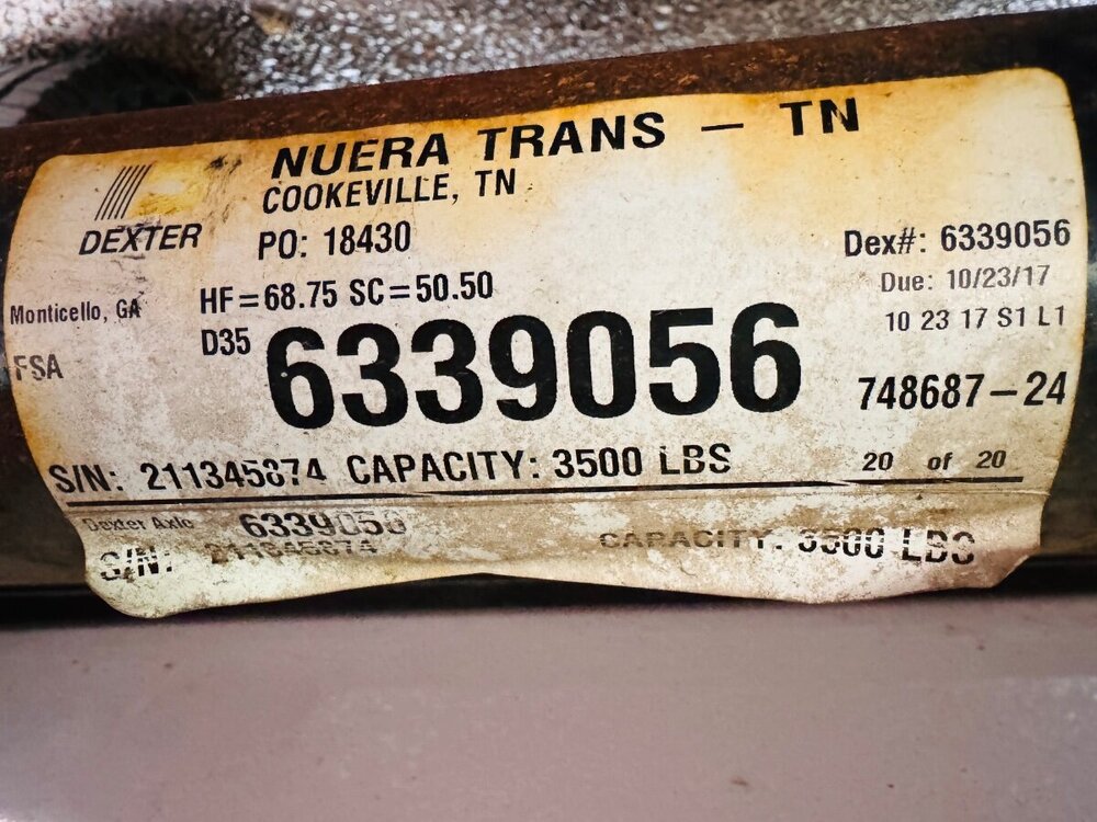

almost all Oliver E2s should have a 3” diameter axle. I double checked mine with a set of calipers just to calm my ocd.  The reason to check is just to reassure the correct u bolts are ordered at time of purchase as there had been at least one report of replacement axles on older E2s being of different diameters.   Springs should be the same regardless
You can certainly do the string circumference then to the math for diameter.
You can also check the stickers on your axles. It should look something like this and say D52 capacity - 3500 lbs as our trailers are only a year apart you and I should have very similar axle specs

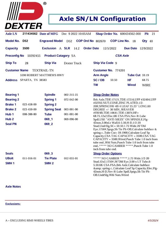

John, if you haven’t already, contact Dexter and request a spec/build sheet of your axle/spring assy. You will have to provide them with your axle serial number.
Attached is a copy of my build sheet with all the info on the axles and springs, under “shop order notes and options” you can see my axles are 3” diameter. The axles and springs are supplied from Dexter as an assembly, D52 = 5200lbs capacity and the springs are 1750lbs capacity.
The way I read your label, the model # is D52, but the weight rating is 3500 lbs. Yes, springs are rated at 1750 lbs.

Axle weight rating is 5200lbs/axle, spring weight rating is 1750lbs (x 2 = 3500/axle, hence the 7000lbs GVWR), GVWR of 7000lbs is based on the weakest link, ie the springs

Within 5 minutes of texting Dexter with a screen shot of the axel label, I got a text and an e-mail with the document attached. Wow! Thanks for the suggestion.
