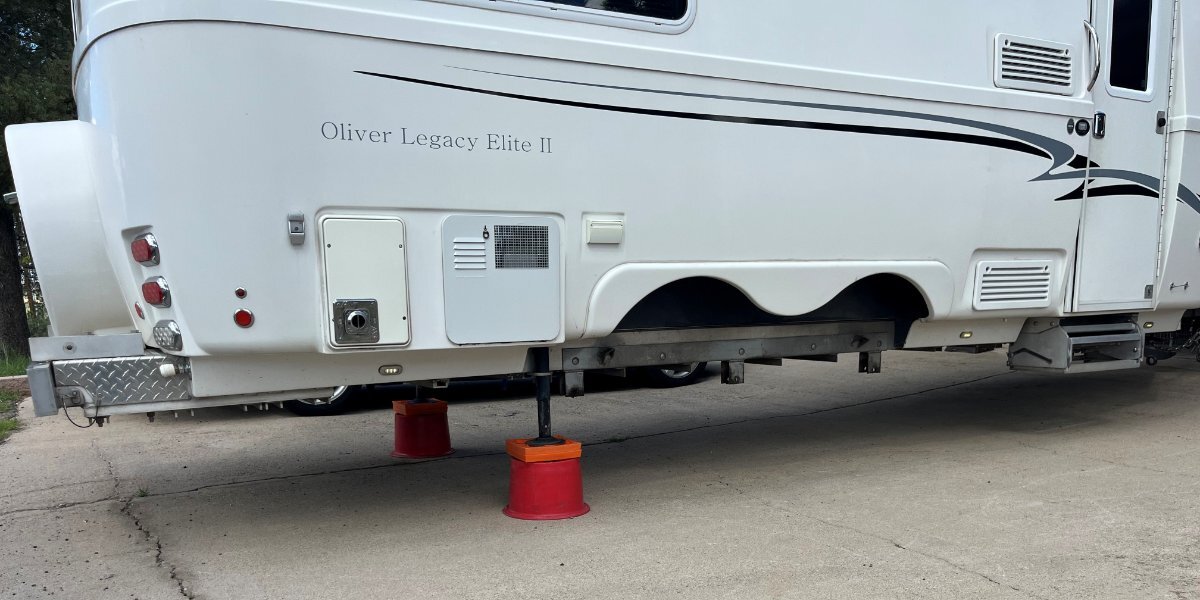

Jd,
Looking forward to your axle and spring install. If you post a pic of your Oliver with no wheels, axles or leaf springs I think that will be a first on the fourm. 😄 I look forward to see pics of your retro fit! Mod On!! 🤩
Edited by Patriot
On 8/26/2025 at 6:03 PM, Patriot said:
If you post a pic of your Oliver with no wheels, axles or leaf springs I think that will be a first on the forum. 😄
Your wish is my command! 🤣
  • Love 2
Now Jd, where are those safety jack stands you talk about?  Just teasing, I think you're perfectly safe using the stabilizer jacks!  I was just wondering though, are you replacing the spring links?  I've noticed that a couple of mine are not accepting grease anymore, even though I replaced the zerks.  Do you think that they should be replaced after 25k miles?
Geoff
Geoff, I thought some regulars here may notice! I did use jack stands at the fronts of the steel frame members, took them away for the picture! 🤣
I have the jack stands back under the Oliver overnight in the same front positions so the weight of the Oliver is spread over 5 points, sitting nice!
