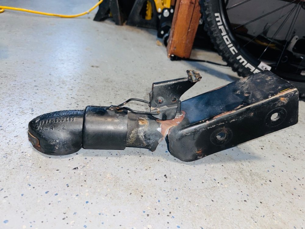

rideadeuce Posted March 19, 2024 Author Posted March 19, 2024 (edited) On 3/19/2024 at 3:30 AM, ScubaRx said: The earliest model elites (2007-2009) were equipped with the 5000lb Class Two BD couplers. That is no longer the case. All the current Elites have a 7000lb BD coupler. So this begs the question, How did a 5k coupler get put on a 2018 Elite II. Is my EII the only one that was equipped with the wrong coupler. I am a huge fan of the camper and the company as a whole. But having lived through this harrowing experience with my family, my hope is they do a thorough investigation and reach out to owners. Again, hopefully this is a one-off situation but really unnerving. I will say the camper's build quality and durability has been phenomenal and my gut feeling (after all the great information from forum members) is that maybe, somehow BD sent over one in the mix by mistake and that this is an isolated incident. But because of the serious nature, it has to be investigated and quality control looked at. This has to be 100% correct every time. I am confident that OTTs will do it. I still love my Oliver and look forward to being back out on the road. Edited March 22, 2024 by ScubaRx 6 - Mike Brentwood, TN - 2018 Elite II - Spirit of Adventure Hull #308 - 2016 Toyota Tundra Limited 5.7L Class IV hitch with 12k lb coupler, Weigh safe adjustable trailer hitch, Dobinsons HD 2in Leaf springs, Timbren bump stops, Dobinsons 3in coilovers and UCAs, Mechman 370 amp HO alternator. Oliver upgrades: Starlink, Cradlepoint cellular modem, Victron Multiplus II 12V 3000W, Ekrano display, Orion XS 50amp DC/DC charger with Anderson connections, Toshiba 6-in-1 Microwave oven - air fryer combo, Atmos 4.4 15k AC/12K Heat pump, Nova Kool 5810 fridge, Epoch 460aH x2, 520 watts solar on top, Custom aluminum bicycle rack, Alcan Springs, Bulldog shocks, Falken H/T02 tires, Seabiscuit Metal Designs front storage box and moose rack.

Jason Foster Posted March 20, 2024 Posted March 20, 2024 On 3/16/2024 at 10:21 AM, rideadeuce said: Hey guys, I think I may have just figured out why this happened. If I am thinking about this correctly, looks like to me the wrong coupler was installed from the factory. 5k instead of the 7k coupler. Maybe one from the Elite I got put into the Elite II pile, they look identical, except for the notorious gusset. Just noticed this when I was looking it over again. That is terrible but also a relief. I will have to check mine to see if it is the right one for my trailer. 2014 Ram 2500 Cummins Diesel 4X4 Truck 2024 Oliver Legacy Elite II Hull 1460
Jason Foster Posted March 20, 2024 Posted March 20, 2024 (edited) Hold up, ya'll. The top of his hitch says class 3 but the bottom says class 4. Which is it? @rideadeuce can you get a better image of that label? Edited March 20, 2024 by Jason Foster 8 2014 Ram 2500 Cummins Diesel 4X4 Truck 2024 Oliver Legacy Elite II Hull 1460
rideadeuce Posted March 20, 2024 Author Posted March 20, 2024 6 hours ago, Jason Foster said: Hold up, ya'll. The top of his hitch says class 3 but the bottom says class 4. Which is it? Good eye. The sticker and the mold identification are inconsistent. The sticker has a bit missing and some black overspray from previous year's touch-up. I believe that the wrong sticker was applied to the Class III 2 in coupler. Which also adds to the intrigue on how this all happened. I tried to take some better pictures not sure if they show up any better. But I did find a new sticker picture for the Model 3B and it was for the 7k coupler (last picture). So looks like there is a mismatch on identification. Appreciate your input. Best, Mike 2 2 - Mike Brentwood, TN - 2018 Elite II - Spirit of Adventure Hull #308 - 2016 Toyota Tundra Limited 5.7L Class IV hitch with 12k lb coupler, Weigh safe adjustable trailer hitch, Dobinsons HD 2in Leaf springs, Timbren bump stops, Dobinsons 3in coilovers and UCAs, Mechman 370 amp HO alternator. Oliver upgrades: Starlink, Cradlepoint cellular modem, Victron Multiplus II 12V 3000W, Ekrano display, Orion XS 50amp DC/DC charger with Anderson connections, Toshiba 6-in-1 Microwave oven - air fryer combo, Atmos 4.4 15k AC/12K Heat pump, Nova Kool 5810 fridge, Epoch 460aH x2, 520 watts solar on top, Custom aluminum bicycle rack, Alcan Springs, Bulldog shocks, Falken H/T02 tires, Seabiscuit Metal Designs front storage box and moose rack.
jd1923 Posted March 20, 2024 Posted March 20, 2024 13 hours ago, Jason Foster said: Hold up, ya'll. The top of his hitch says class 3 but the bottom says class 4. Which is it? It's the number in the casting that is most important. The strength is in the casting. The label gets added after casting of course, and after the sleeve and latch mechanism is mounted, and even later after painting. Since it is the label that was added incorrectly, btw, makes this a BD defect and not an OTT assembly mistake, since upon installation the label would be most apparent, and no technician would think they'd have to check two manufacturer markings to be certain of application. Thank goodness ours has 7000 LB on the casting and label. This is in a way a one-off defect, but what is unknown is the batch size. Did Bulldog make just one of these (likely not), or did they produce 100s like this in their manufacturing process? Bulldog must act quickly and communicate a recall. 6 Chris & John in Prescott, AZ | 2016 EII #113 | '01 Ram 2500 Cummins!

jd1923 Posted March 21, 2024 Posted March 21, 2024 Now that we have realized this BD hitch is a 5000 LB Class-3 hitch with a 7000 LB Class-4 OEM-mounted label, it really has nothing to do with what was designed for an LE-I or any OTT model. As @ScubaRx has verified, all travel trailers manufactured by OTT since 2015 have specified the 7000 LB Bulldog. OTT did not install the wrong trailer part. They installed a DB hitch mislabeled by Bulldog. The question is, did OTT receive just one (1) of these defective (mis-labeled) hitches, or a few? They could be on any 2018 +/- OTT trailer. Also, what was the defective batch size? Besides OTT, what other trailer manufacturers could have received mislabeled units? OTT management should not only be monitoring this thread. They should pay for ALL of @rideadeuce's expenses and some and pay to have this defective unit shipped back to OTT as evidence. In the end, Bulldog should pay. OTT MUST make Bulldog aware of this immediately, to limit OTT liability. DB must trace this unit by manufacturing batch number and communicate a recall to all possible BD consumers. 5 Chris & John in Prescott, AZ | 2016 EII #113 | '01 Ram 2500 Cummins!
Jason Foster Posted March 21, 2024 Posted March 21, 2024 2 hours ago, jd1923 said: Now that we have realized this BD hitch is a 5000 LB Class-3 hitch with a 7000 LB Class-4 OEM-mounted label, it really has nothing to do with what was designed for an LE-I or any OTT model. As @ScubaRx has verified, all travel trailers manufactured by OTT since 2015 have specified the 7000 LB Bulldog. OTT did not install the wrong trailer part. They installed a DB hitch mislabeled by Bulldog. The question is, did OTT receive just one (1) of these defective (mis-labeled) hitches, or a few? They could be on any 2018 +/- OTT trailer. Also, what was the defective batch size? Besides OTT, what other trailer manufacturers could have received mislabeled units? OTT management should not only be monitoring this thread. They should pay for ALL of @rideadeuce's expenses and some and pay to have this defective unit shipped back to OTT as evidence. In the end, Bulldog should pay. OTT MUST make Bulldog aware of this immediately, to limit OTT liability. DB must trace this unit by manufacturing batch number and communicate a recall to all possible BD consumers. Definitely this and as soon as possible. Someone out there is hauling a potentially loaded down trailer with an under-spec hitch and, unlike Rideadeuce, the failure could be catastrophic. 1 3 2014 Ram 2500 Cummins Diesel 4X4 Truck 2024 Oliver Legacy Elite II Hull 1460
Steph and Dud B Posted March 21, 2024 Posted March 21, 2024 I had an good chat with a Bulldog technical service rep yesterday (after a 20 minute wait for someone to pick up). I had called to ask about my gusset welds. He confirmed that my welds looked OK (one was a bit wider than spec). He also told me that all BD couplers are designed to be welded to a steel trailer frame, but said it was fine that OTT modified it to bolt on. I also told him a bit about what I was reading in this thread. He said he hadn't heard about this incident or anything like this happening before. Overall, I got the sense that he was very competent and knowledgeable. The 20 minute wait was unfortunate, though. 3 Stephanie and Dudley from CT. 2022 LE2, Hull #1150: Eggcelsior. Tow vehicle: 2016 GMC Sierra 6.0 gas dually 4x4. Our Oliver journey: Steph and Dud B's RV Screed Where we've been RVing since 1999:
Jason Foster Posted March 22, 2024 Posted March 22, 2024 2 hours ago, Steph and Dud B said: I had an good chat with a Bulldog technical service rep yesterday (after a 20 minute wait for someone to pick up). I had called to ask about my gusset welds. He confirmed that my welds looked OK (one was a bit wider than spec). He also told me that all BD couplers are designed to be welded to a steel trailer frame, but said it was fine that OTT modified it to bolt on. I also told him a bit about what I was reading in this thread. He said he hadn't heard about this incident or anything like this happening before. Overall, I got the sense that he was very competent and knowledgeable. The 20 minute wait was unfortunate, though. Could've been worse: 30 minute wait. 1 2014 Ram 2500 Cummins Diesel 4X4 Truck 2024 Oliver Legacy Elite II Hull 1460
