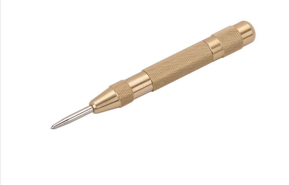

FYI, we always use a spring punch on the gelcoat prior to any drill bit action:

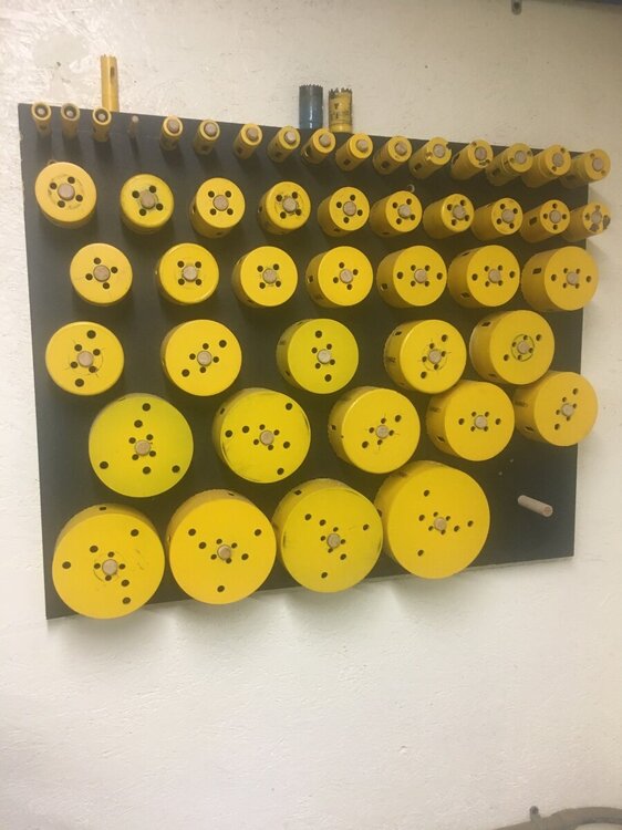

These are what I use for any holes larger than 1/2”.
WOW!
I said the same thing. WOW.
HOLE-E COW BATMAN!
Steve,
Are these next to the Lathe & Drill Press when you are under tow???
