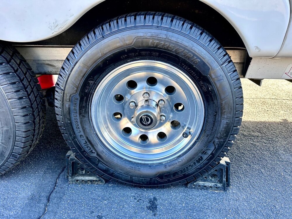

We put New tires on our 2019 EII in Jan 2024 after 50K miles of use, and the tires were about to age out. (Still had a lot of tread.)
We went to Discount Tire (also called America's Tire) and we put on new Michelin's.
Tire Selected:
Michelin Agilis Cross Climate - LT225/75 R16  Load Range E1 Black Sidewalls
Discount Tire had no issue with these on our trailer.
The tires are great so far.  We run them at 55PSI and they have plenty of load capacity.

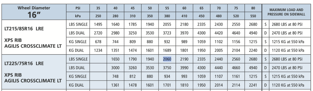

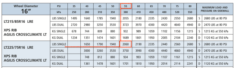

Of all the tires I have researched this past year, I have t agree that the Agiliss Cross Climate Light Truck E1 rated seems to be to be a great option at this point in time.
However:  Accoring to the above posted tire / load chart:
I have to wonder why 55 PSI is suggested as appropriate?
Lets assume we have an average 6000 pound ollie with 10% tongue weight.  We have 5400 pounds on four tires = 1350 pounds per tire.
Would therefore the Michelin chart for these tires recommend a PSI of 40 PSI?
Kindly explan why we would want to punish our poor tralier with 55 PSI in the tires.
We just picked a mid point on the chart as a starting point.
What would you run them at?
I may lower the pressure on the next run, but expect some extra heating effects on the tires at that lower psi.

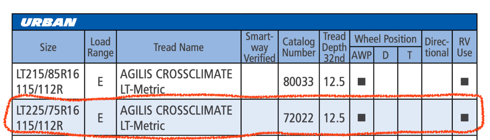

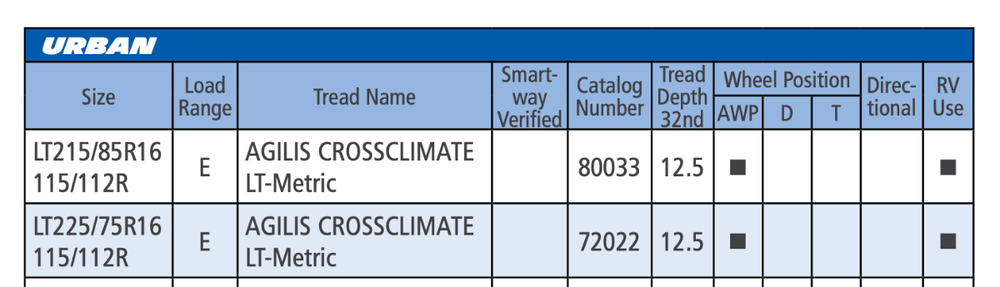

4 hours ago, gbergh said:
The "C" designates Metric.  There is no LT in front of the tire size numbers.
Actually, the number 225 in 225/75R16 is metric, meaning 225 mm. The 75 means the profile (height) is 75% of the width on a 16" rim. Standard sizes are all in inches and are today less common ever since Michelin came to the US in the 80s.
With some research I found out that Michelin has created a new tire category. This C tire (Commercial) is more expensive than their LT, has a higher load rating (not needed for the EII 7000 GTWR) and is not snow rated (also not necessary for a trailer). Question, is it worth $54 plus tax more per tire? No, the LT model on our Oliver is fine for almost $240 less.
Turns out Michelin has created a new tire category; I had not seen before. The following copied from Tyre markings explained: How to read a tyre? | MICHELIN
Look at your table above, at 45 PSI the tire holds 1790 LBS x 4 = 7,160 LBS. Our Oliver ready to camp under 6600 LBS, so we could be at 40 PSI, but since that is the lowest number on the chart, I bump it up to 45 PSI. Ran my tires at 46 last time I checked since they were all just a hair above that number. @John E Davies ran his Mouse at 42 PSI for years which you can see in his posts.
If you have upgraded to 5200 LB axles and higher rated leaf springs and carry over 8000 LBS total, then 55 PSI would be the right number. The right pressure for the load should not create excessive heat.
When we purchased our LE2 Ollie used during 2016 the original owner was running 50 PSI, eventually we dropped to 45PSI and right now we're running 40PSI cold. When we tow on the highway we always tow with empty black, grey, and fresh water tanks. The combined LT225/75R/16E dual capacities on the above Michelin chart at 40PSI are well above our actual LE2 ready to camp weight.
Edited by rideandfly
I'll drop it to 40-45 then for the next trip and see how it feels.
I know the original ride home when when we picked up New was very bumpy as they had 65 psi in those original Michelin's.
I would consider the MFG recommended pressure chart.  For our OE2's at 6,000 pounds less tongue weight divided by 4 OE2 tires the weight is below the chart.  That means Michelin is saying use the minimum number listed or 40 PSI.
However if you are running TMPS, and you want a bit more warning time and a tad firmer ride, then I would go with 45 PSI as a Max.
The same logic line for the Defender tires.  Here is the Michelin tire pressure chart for ours:
One would deducet using the same logic that 35 psi is their recommended pressure for the Defenders, 40 if you want more TMPS head room.  Less off road like going to Tec at Denali AK.
