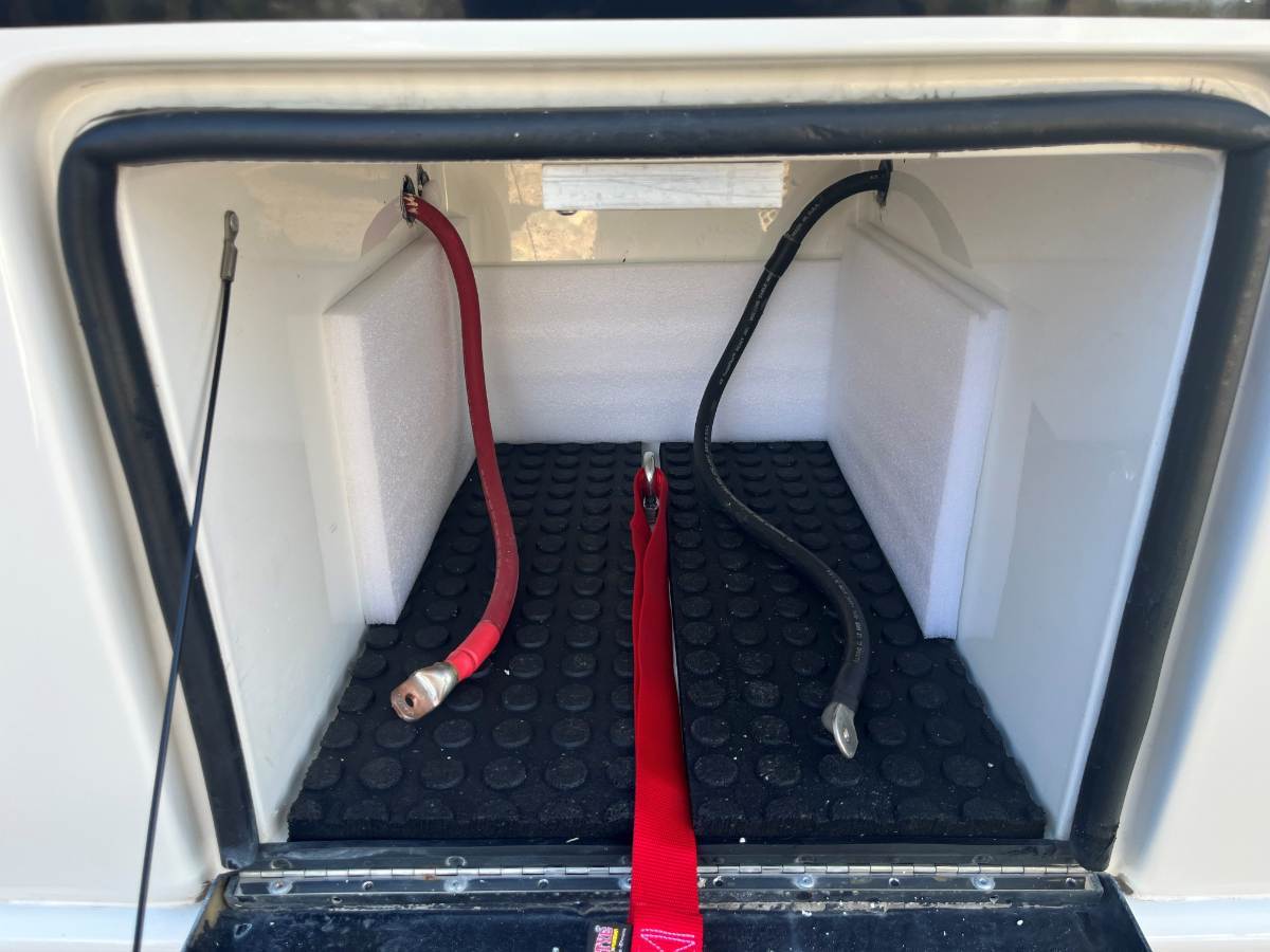

My battery compartment is simpler than anybody's! I didn't want anything but batteries, 4/0 cables, insulation and tie-downs, nothing else (see before and after pics). What a mess OTT made of the battery bay, OMG. None of the extra 6 AWG wires were necessary. I cut off most of their length and attached them to interior buses.

For those replacing Battleborn batteries, it's a good time to upgrade the wiring and other electrical mods.
