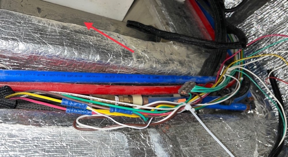

John E Davies Posted July 20, 2022 Share Posted July 20, 2022 10 hours ago, Alberta and Randy said: That is out a lot further than normal. If you want to move it forward, it would be very easy to cut out a section of the black pipe inside the hull and reconnect it with a glued ABS coupling. Access is fine underneath the false floor in the cargo area, which is held down by a few small screws.. Also, make sure the big rubber grommet is in place, mine was never installed right and the waste pipe flopped around and a very large amount of dust entered the cabin there. There should be almost no motion at all. https://olivertraveltrailers.com/forums/topic/2821-how-to-waste-pipe-plastic-dust-grommet-not-secured-pipe-moves-around/ I recall that a member cut a great big hole in the bottom aluminum plate and used a 90 degree elbow so the hose would exit out straight down, and the bumper could then be closed while connected. I prefer not to have a hole there. A full timer who spends months connected might prefer that mod. John Davies Spokane WA 1 SOLD 07/23 "Mouse": 2017 Legacy Elite II Two Beds, Hull Number 218, See my HOW TO threads: Tow Vehicle: 2013 Land Cruiser 200, 32” LT tires, airbags, Safari snorkel, Maggiolina Grand Tour 360 Carbon RTT. Link to comment Share on other sites More sharing options...
Moderators mossemi Posted July 20, 2022 Moderators Share Posted July 20, 2022 35 minutes ago, John E Davies said: I recall that a member cut a great big hole in the bottom aluminum plate and used a 90 degree elbow so the hose would exit out straight down, and the bumper could then be closed while connected. @Landrover mentioned that mod in his for sale posting. Follow the link below: https://olivertraveltrailers.com/forums/topic/7121-2019-legacy-elite-ii-for-sale-in-ocala-florida/#comment-77148 Mossey 2 Mike and Krunch Lutz, FL 2017 LEII #193 “the dog house” Link to comment Share on other sites More sharing options...
